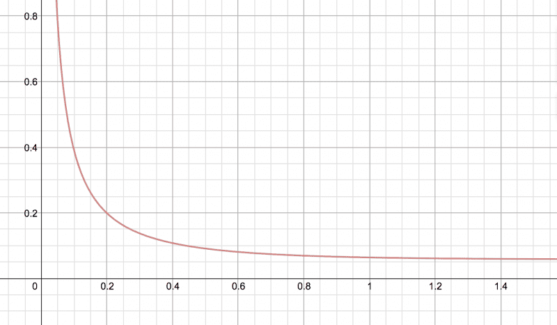

The easiest way to think of the Hubble growth rate is as a percent per billion years (how much the distance would grow in a billion years if the rate stayed the same all that time). You know the present rate is about 7% per billion years and it is declining towards a steady 6%.
More precisely the numbers are 1/14.4 ≈ 0.07 and 1/17.3 ≈ 0.06.
Astronomers have studied millions of data points and have learned somewhat about the HISTORY of how that growth rate has changed over time and we can PLOT the approximate curve showing what they have deduced about its change over time. It is basically the hyperbolic cotangent curve
coth(1.5x) but to make small numbers I will measure time in billions of years and divide everything by 17.3. so x = time/17.3 billion years
and I am plotting coth(1.5x)/17.3. In this picture the point x = 1 on the x-axis should really be labeled "17.3 billion years".
This curve shows how the rate tails out to a longterm level value of 0.06
