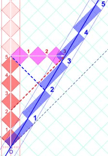

Its just that in my mind (however misguided), the garage and the ladder have the same scale of measure in either frame (so the garage is always smaller than the ladder). I'm just saying, that in my mind, it is more a matter of an observers perception of time. But I could bet well be wrong!?Sagittarius A-Star said:Maybe it helps, if you look at the animated Minkowski diagram in above posting #67.
Imagine, the garage has the rest-length ##\overline{OC}## and is at rest in the unprimed frame (with black coordinate-axes).

I really do understand, I just don't find it intuitive. That's why I brought it up. The example challenges everyday experience. I don't want to derail the topic any further.Sagittarius A-Star said:That's not the point. You could use two cameras which are triggered by two local, synchronized clocks. It is not about observation. It's about the relativity of "simultaneously" between different frames, as you can see in the Minkowski diagram.

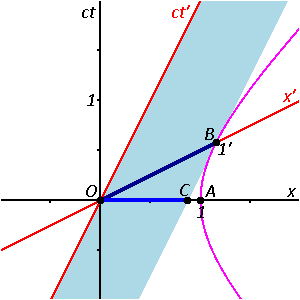

The easiest way to think of it is to note that the ladder has extent in the time direction. So if you simplify the ladder to a 1d line in space, it's a 2d sheet in spacetime - one dimension is length, the other is duration. But different frames differ in which direction they call length and which duration, so different frames take different lines across the sheet and call that the length, and the different lines have different lengths.valenumr said:Ugh... It's late here. I'm still conceptually struggling with the idea that length contraction is "real" TBH. The non-simultaneity of the garage doors feels more natural to me. But I guess the fact that in one frame the ladder is entirely in the garage and observes both doors to be closed... It hurts my brain. I guess that's why I brought it up as an example.

You hit the nail on the head. I am getting more philosophical than scientific on the issue.Ibix said:The easiest way to think of it is to note that the ladder has extent in the time direction. So if you simplify the ladder to a 1d line in space, it's a 2d sheet in spacetime - one dimension is length, the other is duration. But different frames differ in which direction they call length and which duration, so different frames take different lines across the sheet and call that the length, and the different lines have different lengths.
That's what's being illustrated in the Minkowski diagram in #67. The shaded area is the 2d rod. According to the unprimed frame (black axes) the x-direction is a horizontal line and the t-direction is a vertical line, so OC is the length of the rod. But according to the primed frame (red axes) the x'-direction is sloped upwards and the t-direction is sloped to the right, so OB is the length of the rod. They're different lengths.
Whether or not length contraction is "real" is up to you. I would say that it's similar to me slicing a sausage perpendicular to its length while you slice it on the diagonal. I get a circular cross-section, you get an elliptical one. That's a Euclidean analogy to length contraction - but is it "real" that the sausage is elliptical according to you and circular according to me? Or are we just measuring different things?
