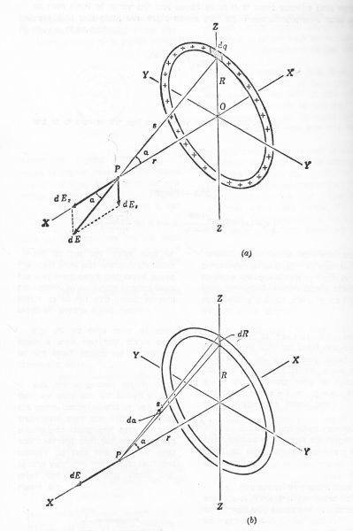

A disk of radius 10 [cm] is charged with 5E-9 [Coulon]. where on it's axis is the greatest electric field.
The field on the axis of a charged disk:
##E=\frac{1}{4\pi\varepsilon_0}\frac{q\cdot \cos\alpha}{s^2}##
I express [itex]\cos\alpha[/itex] in terms of the radius R and the diagonal distance s:
##\cos\alpha=\frac{\sqrt{s^2-R^2}}{s}##
I insert that into part of the equation of the field:
##\frac{\cos\alpha}{s^2}=\frac{\sqrt{s^2-R^2}}{s^3}##
The derivative of this expression is (maybe i have a mistake here):
##\left( \frac{\sqrt{s^2-R^2}}{s^3}\right)'=\frac{3R^2-2s^2}{s^4\sqrt{s^2-R^2}}##
I equal the numerator to 0 and get s=1.22R=12.2[cm]
The horizontal distance on the axis that corresponds to this diagonal is:
##\cos\alpha=\frac{1.22R}{R}\rightarrow\alpha=34.95^0##
To this angle the horizontal distance is 14.3[cm] while it should be around 8[cm]

I am almost sure the question is about a ring, look at the drawing, the book explained about that ring and in the explanation gave also only one radius R.
OK. In the OP, your differentiation looks wrong.
You will find the algebra much easier if you take an angle as the independent variable instead of a distance.
I agree, the drawing looks like a ring. But a ring is not a disc, and the wording says disc.

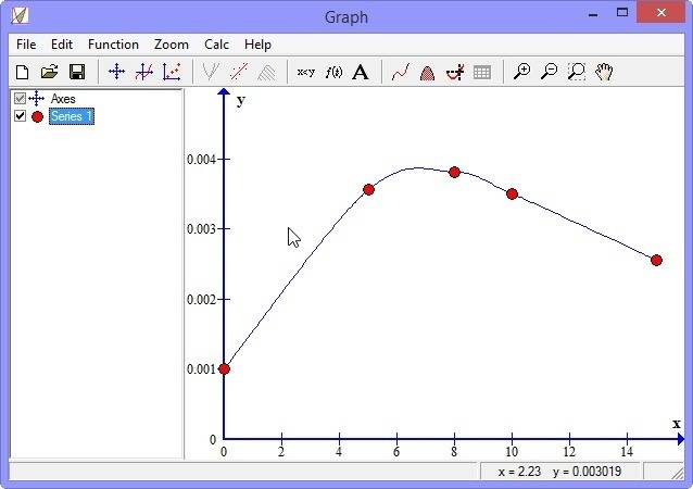

I was told to calculate the field E at distances 0, 5, 8, 10 and 15 [cm] from the origin.
I calculate only:
##\frac{q\cdot \cos\alpha}{s^2}##
At 0 [cm] it's 0.001
At 5 [cm] it's 0.00356
At 8 [cm] it's 0.00381
At 10 [cm] it's 0.0035
At 15 [cm] it's 0.00256
The peak is either between 5 and 8 or 8 and 10, but i guess closer to 8. i will draw a graph and attach
r=R/sqrt(2)
Exactly. If you want to find out which, by the same method, you need to calculate some more points. Why not just trust the caclulus method?
