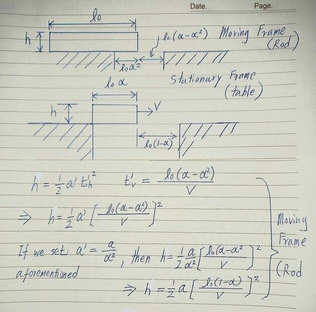

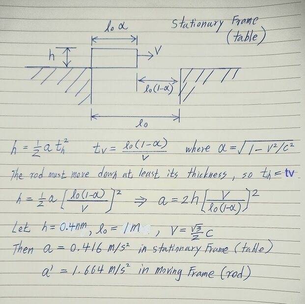

PeterDonis said:
gravity is many orders of magnitude stronger than the rod's internal forces in frame A just as well as in frame B,
PAllen said:
An element of the rod has to move downward by at least its thickness before the right hole edge reaches it. At lab scales, this would be e.g. a centimeter per nanosecond squared for this to happen. This works out to be much larger than the surface gravity of a neutron star. You can work around this by e.g. having a rod whose thickness would be less than an atom, if you want to consider that acceptable.
PeroK said:
I must admit I don't get the problem. What happens when water flows over a cliff? The water starts to fall as soon as it over the edge. In the rod and hole paradox, we must imagine an extraordinary gravitational force that would treat any object like water and either bend it like a waterfall and/or rip it apart.
Thanks to PeterDonis, PAllen and PeroK for the tips. I just had time to do actual calculations (I admit I was careless and a bit lazy before), as shown below.
For thicknesses close to the atomic scale, there is still the strength of the gravitational field calculated in the figure. I finally began to believe that in this case, the shear stress generated by gravity is enough to crush any object made of material.
For another example, in the moving frame, a copper rod with a diameter of 1 cm (h=1cm) and a length of 100 cm has a mass of about 0.7 kg, the relative speed of rod and hole is ##~\frac{\sqrt{3}}{2}c~##, so according to the calculation formula, if it needs to fall completely into the hole, its weight is ##~1.5 \cdot 10^{16} ## Newton, and this huge weight may cause it to be crushed to dust on the table before reaching the hole.
Edit: I think the following situation is impossible, so delete it.
However, I feel that for very hard objects, such as objects that are much harder than diamonds, I am not sure whether there will be exceptions, and I don’t know how to perform more in-depth calculations. In any case, if this violates the laws of physics or is illogical, then please ignore it.

We can also make the same calculation for the moving frame (rod), as show below.
So this result is the same as the result of the stationary frame (table), that is to say, in the moving frame (rod), when the rod hits the wall on the right side of the hole, the falling distance is exactly h.
Likes Sagittarius A-Star
In the figure you wrote:
figure said:
##\alpha = \sqrt{1-v^2/c^2}##
##a=2h[\frac{v}{l_0(1-\alpha)}]^2##
Let ##h=0.4nm, l_0=1m, v=\frac{\sqrt{3}}{2}c##
Then ##a=0.416 m/s^2##
Are you sure, that your numerical result for ##a## is correct?
According to my calculation ##a=2h[\frac{v}{l_0(1-\alpha)}]^2 = 6hc^2/(1m)^2##.
Likes alan123hk
  • #152
Sagittarius A-Star said:
Are you sure, that your numerical result for a is correct?
You are correct. I 'm sorry that my calculation result is an extremely outrageous error.
By the way, I think that based on these calculation results, I have reason to believe that there may not be any substance in this world that can withstand the pressure generated by this so-called length contraction fallacy without being crushed, then some of the main components mentioned in this imaginative experiment, including the table that carries the sliding rod and the trap door of the hole, are almost impossible to exist.

Agreed. It is actually easier to see how this works in the hole rest frame. There, you have simultaneous horizontal force applied, rod begins to move down horizontally while also moving horizontally. At a very small delay (by my calculations, under the model under discussion, the rod will travel less than a micron before local neighbors begin to react). In the hole frame, this slightly delayed reaction will occur simultaneously across the rod (just like the resistance to a horizontal cleaver hitting a cutting board occurs at a delay, but all across the cleaver simultaneously, in this frame). As I've described elsewhere, this looks like a reaction front following a small distance behind the force application front, superluminally, in the rod initial rest frame.
At this point, the rod will start reshaping itself into some shape corresponding to a rigid motion. I believe this actually means the rod will curve and start to bend (in the hole rest frame), concave up, with the left tilting more and more downward over time.
PeterDonis said:
In the frame in which the rod is at rest prior to starting to fall, the support is removed first from the front end of the rod. Note that in this frame, the downward acceleration on unsupported parts of the rod is increased by a factor of ##\gamma^2##. This means that it is quite possible in this frame for the shear on the rod to happen too fast for the rod's internal forces to compensate, so that the rod bends in this frame, even if in the hole rest frame the rod's motion looks rigid.
Yes, this happens initially. But distances between neighbors will have only shifted by order of 1% before the neighbors start to react. So with this assumed bond strength, there should be no problem snapping to a Born rigid configurations (with vibrations, etc. before it settles). With ordinary matter, bond strengths can't resist, and the interatomic distance just continue to grow until all bonds break. But interestingly, even for ordinary matter, this might not happen until the rod is way past the hole (in hole in surface formulation, rather than a hole with walls). That is, while it is invariant whether a the rod is experiencing stress, and this is definitely true for the formulation of horizontal applied downward acceleration in the hole frame - whereas horizontal downward acceleration in the rod frame need not have stress - it actually appears to me (I did some calculations for diamond), that the diamond rod will not have severe enough stress to break before being all the way under the surface well to the right of the hole. Thus, for a hole with a wall, the diamond will not have broken yet before hitting the wall - despite invariant internal stresses.
  • #165
Now that I think of it, the nonzero vorticity of the congruences we calculated earlier would indicate the same thing; the internal forces will tend to correct for the vorticity in the way you describe.
  • #166
PAllen said:
I brought up the comparison of the required acceleration to the surface gravity acceleration of a neutron star. I assumed it was obvious we were not concerned with the tidal forces near a neutron star. I thought the statement that this was over 100 times the value of g for the surface a neutron star was instructive. It implies that chemical bonding forces effectively don’t exist, and even the nuclear forces are overwhelmed.
Precisely. Any good student should notice that at relativistic speeds the collison with the far side of the hole would be indistinguishable from the friction between the surfaces! When the rod is over the hole we need some gigantic force (it doesn't need to be gravity) that does something physically significant in the short time during which the rod passes over the hole. The Earth's surface gravity would not achieve this.
In fact, considering a mechanism other the gravity may help resolve the problem, as the student may have a blind spot about gravity not acting until the CoM is over the edge of the hole. As a hangover from too many classical mechanics problems!
If, instead, we have powerful daemons lurking in the hole, who grab the rod and pull it down to its fate, then the solution is more obvious. Even in the rod frame, where the hole is short, the first daemon grabs hold of the tip of the rod as soon as it appears over the edge!
That said, I don't know whether there is any published research on the compatibility of daemons and special relativity.
