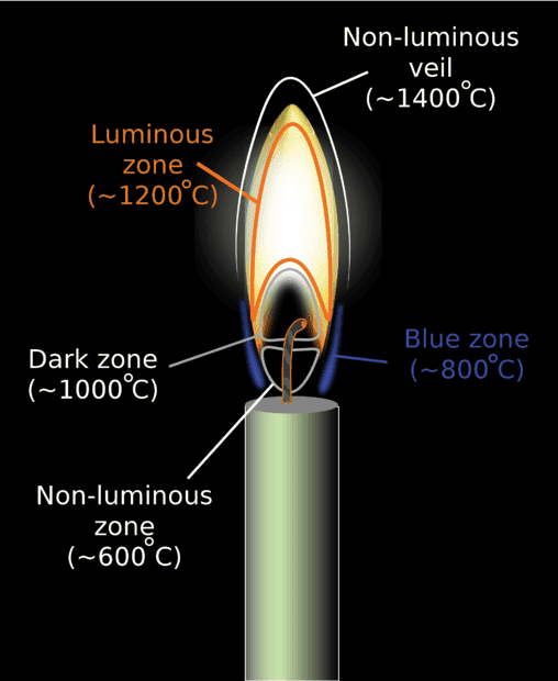

For the entire system, it is characterized by energy. But you can still have local equilibrium and talk of the temperature at a given point. This is done all the time in fluid dynamics. This is how you get something like flame temperature profiles:
https://en.wikipedia.org/wiki/File:Anatomy_of_a_candle_flame.svg
Likes Lord Jestocost and phoenix95
This was exactly what I was looking for. Do the same references you mentioned above cover this as well? Or are there any others I should take note of?
It is covered in Thomson's book. The basics should be found in textbooks on fluid dynamics, such as D. J. Tritton, Physical Fluid Dynamics. Look for "convection."
