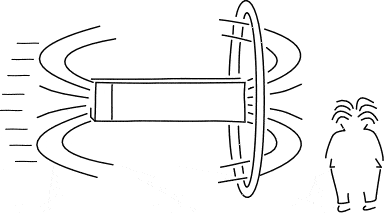

The moving magnet and conductor problem is an intriguing early 20th century electromagnetics scenario famously cited by Einstein in his seminal 1905 special relativity paper.
In the magnet's frame, there's the vector field (v × B), the velocity of the ring conductor crossed with the B-field of the magnet.
In the ring conductor's frame, there's the induced electric field E'.Using classical electromagnetics, it can be shown that the curls of both vector fields are mathematically equivalent. It is then usually stated that both vector fields themselves are mathematically equivalent.
I've been researching documents on the mathematics of the moving magnet and conductor problem, and I haven't been able to find any mathematical steps showing how we can arrive at both fields being equivalent if their curls are equivalent.
Multiple different vector fields can produce the same single curl field, and vice versa, a single curl field can be indicative of multiple different vector fields.
So I would like to know how to derive the equivalency of the moving magnet and conductor vector fields.

For the moving magnet problem you don't even need explicitly relativity but just Maxwell's equations. The reason is that as long as you don't make any approximations (e.g., by assuming that the moving charges making up a current follow non-relativistic kinematics, as is done in many textbooks on electromagnetism, and this is often justified but still leads to confusion when it comes to the question of "electrodynamics of moving bodies" as Einstein's famous paper is titled).
All you need here is that Faraday's Law in differential form simply is (in Heaviside Lorentz units)
$$\vec{\nabla} \times \vec{E}=-\frac{1}{c} \partial_t \vec{B}.$$
Applying Stokes's integral theorem leads to
$$\int_{\partial A} \mathrm{d} \vec{r} \cdot \vec{E}=-\frac{1}{c} \int_{A} \mathrm{d}^2 \vec{f} \cdot \partial_t \vec{B}.$$
Now the crucial point is that you want to bring the time-derivative on the right-hand side out of the integral. In the case of the moving magnet on the right-hand side you want to integrate along the moving wire making up the loop and a corresponding surface whose boundary this loop is on the right-hand side. That means the surface and/or boundary are time-dependent and you must take this time-dependence into account when taking the time-derivative out of the integral. The corresponding correction adds a line integral along the boundary, which can be brought to the other side of the equation. Using also Gauss's Law for the magnetic fields, ##\vec{\nabla} \cdot \vec{B}=0## leads to the general form of Faraday's Law in integral form:
$$\int_{\partial A} \mathrm{d}\vec{r} \cdot \left (\vec{E}+\frac{\vec{v}}{c} \times \vec{B} \right)=-\mathrm{d}_t \int_A \mathrm{d}^2 \vec{f} \cdot \vec{B}.$$
For a derivation, see the Wikipedia:
https://en.wikipedia.org/wiki/Faraday's_law_of_induction#Proof
This is valid in any reference frame. In the frame, where the magnet is at rest, you have ##\vec{E}=0## and the entire electromotive force (acting on the electrons in the wire as a force in the usual thing) is the ##\vec{v} \times \vec{B}## term. The corresponding Lorentz force acts on the electrons in the wire and make them move relative to the wire.
In the frame, where the wire is at rest there's by definition ##\vec{v}=0##, but of course there must also be some electromotive force making the electrons moving relative to the wire also in this frame. The only conclusion must be, since also in this frame Maxwell's equations hold true due to the principle of relativity according to which the natural laws are the same in all inertial frames, that there's an electric field, and indeed as Einstein has derived in his paper according to the transformation laws of the electromagnetic field components a moving magnet leads to both electric and magnetic field components, i.e., in this reference frame there's an electric (vortex) field leading to the electromotive force making the electrons move in the wire loop. Since these Lorentz transformations are a one-to-one mapping there's never a contradiction between what each of the observers observe, and there's also one and only one cause of the current in the wire: the electromotive force due to the electromagnetic field, which is one field, i.e., you have to consider both the electric and magnetic "parts" of the field as one entity, and as in this case, where you have a magnetostatic field only in the reference frame where the magnet is at rest, in the other reference frame, where the magnet is moving, you have both electric and magnetic field components, i.e., the split of the one and only electromagnetic field in electric and magnetic components is observer dependent, but the Lorentz transformations of these field components tell you how to relate the components with respect to one inertial reference frame to another, and these transformations are such that the Maxwell equations hold in unaltered form for the field components in both frames.

tade said:
sorry, but I'm still unsure about how we show the proof that ##\vec{E}^\prime = \vec{v} \times \vec{B}##
I guess you mean the transformation properties of the electromagnetic field components under Lorentz boosts.
It is most convenient to use the electromagnetic potentials. In 3D formulation you solve the homogeneous Maxwell equations identically by introducing the scalar and vector potentials. I use Heaviside-Lorentz units, because relativistic electrodynamics within the SI system is spoiling the beauty of the subject:
$$\vec{E}=-\vec{\nabla} \Phi-\frac{1}{c} \partial_t \vec{A}, \quad \vec{B}=\vec{\nabla} \times \vec{A}.$$
To derive the Lorentz-transformation properties, it's better to use the 4D notation in Minkowski space, and the potentials can be put together to build a four-vector field
$$(A^{\mu})=\begin{pmatrix} \Phi \\ \vec{A} \end{pmatrix},$$
i.e., ##A^0=\Phi## is the time component.
A glance at the ##\vec{B}##-field tells you that the electromagnetic field components in four-tensor notation should be given by the antisymmetric Faraday tensor,
$$F_{\mu \nu}=\partial_{\mu} A_{\nu}-\partial_{\nu} A_{\mu}.$$
Indeed
$$F_{0 \nu}=-F_{\nu 0}=\partial_0 A_{\nu} - \partial_{\nu} A_0=-\frac{1}{c} A^{\nu} - \partial_{\nu} A^0=E^{\nu}$$
for ##\nu \in \{1,2,3 \}## and
$$F_{\mu \nu}=\partial_{\mu} A_{\nu} - \partial_{\nu} A_{\mu}=-\partial_{\mu} A^{\nu} + \partial_{\nu} A^{\mu} = \epsilon^{\nu \mu \rho} B^{\rho},$$
for ##\mu \nu \in \{1,2,3 \}## and ##\epsilon^{\mu \nu \rho}## the usual 3D Levi-Civita symbol.
Not the transformation property of a vector field like our four-vector potential is
$$\bar{A}^{\mu}(\bar{x})={\Lambda^{\mu}}_{\nu} A^{\nu}(\Lambda^{-1} \bar{x}).$$
Take ##\Lambda## to be a boost in ##x^1## direction. Then
$$\bar{A}^{\mu}=\begin{pmatrix}\gamma (A^0-\beta A^1) \\ \gamma (-\beta A^0+A^1) \\ A^2 \\ A^3 \end{pmatrix}.$$
Here ##\beta=v/c## and ##\gamma=1/\sqrt{1-\beta^2}##.
Then you use
$$\bar{\partial}_{\mu} = \frac{\partial}{\partial \bar{x}^{\mu}} = \frac{\partial x^{\nu}}{\partial \bar{x}^{\mu}} \partial_{\nu}$$
and evaluate ##\bar{F}_{\mu \nu}##, which is a bit of work but straight-forward algebra. Then you can read off the field components in 3D notation as:
$$\begin{pmatrix} \bar{E}^1 \\ \bar{E}^2 \\ \bar{E}^3 \end{pmatrix}=\begin{pmatrix} E^1 \\ \gamma (E^2-\beta B^3) \\ \gamma (E^3+\beta B^2) \end{pmatrix}$$
and
$$\begin{pmatrix} \bar{B}^1 \\ \bar{B}^2 \\ \bar{B}^3 \end{pmatrix} = \begin{pmatrix}B^1 \\ \gamma(B^2+\beta E^3) \\ \gamma (B^3-\beta E^2) \end{pmatrix}.$$
A more convenient notation is
$$\bar{\vec{E}}_{\parallel}=\vec{E}_{\parallel}, \quad \bar{\vec{E}}_{\perp} = \gamma (\vec{E}_{\perp} + \vec{\beta} \times \vec{B})$$
and
$$\bar{\vec{B}}_{\parallel}=\vec{B}_{\parallel}, \quad \bar{\vec{B}}_{\perp} = \gamma (\vec{B}_{\perp} - \vec{\beta} \times \vec{E}),$$
where for any vector ##\vec{E}##
$$\vec{E}_{\parallel}=\frac{\vec{\beta}}{|\vec{\beta}|^2} \vec{\beta} \cdot \vec{E}, \quad \vec{E}_{\perp}=\vec{E}-\vec{E}_{\parallel}.$$
If you now have a situation, where in the reference frame ##\Sigma## you have only a magnetic field, i.e., ##\vec{E}=0##, then
$$\bar{\vec{E}}=\gamma \vec{\beta} \times \vec{B}, \quad \bar{\vec{B}}=\gamma \vec{B}.$$
For ##\beta \ll 1## you can neglect the Lorentz factor ##\gamma=1+\mathcal{O}(\beta^2)##.
For more details on the relativistic formulation of electrodynamics, see
https://itp.uni-frankfurt.de/~hees/pf-faq/srt.pdf
Likes Delta2
