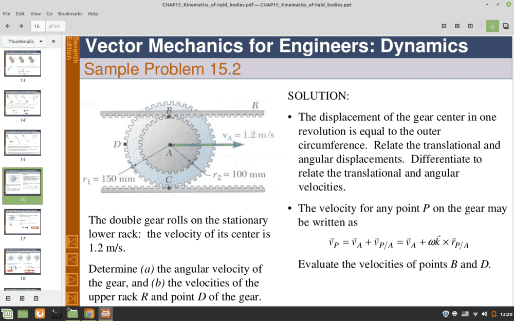

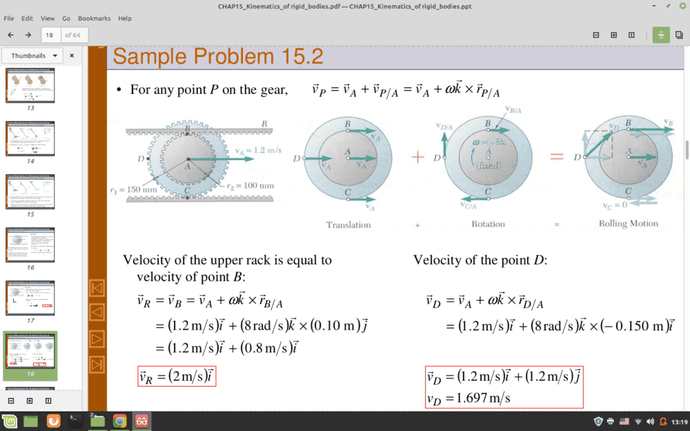

The double gear shown rolls on the stationary lower rack; the velocity of its
center A is 1.2 m/s directed to the right. Determine (a) the angular velocity
of the gear, (b) the velocities of the upper rack R and of point D of the gear.
Hi!

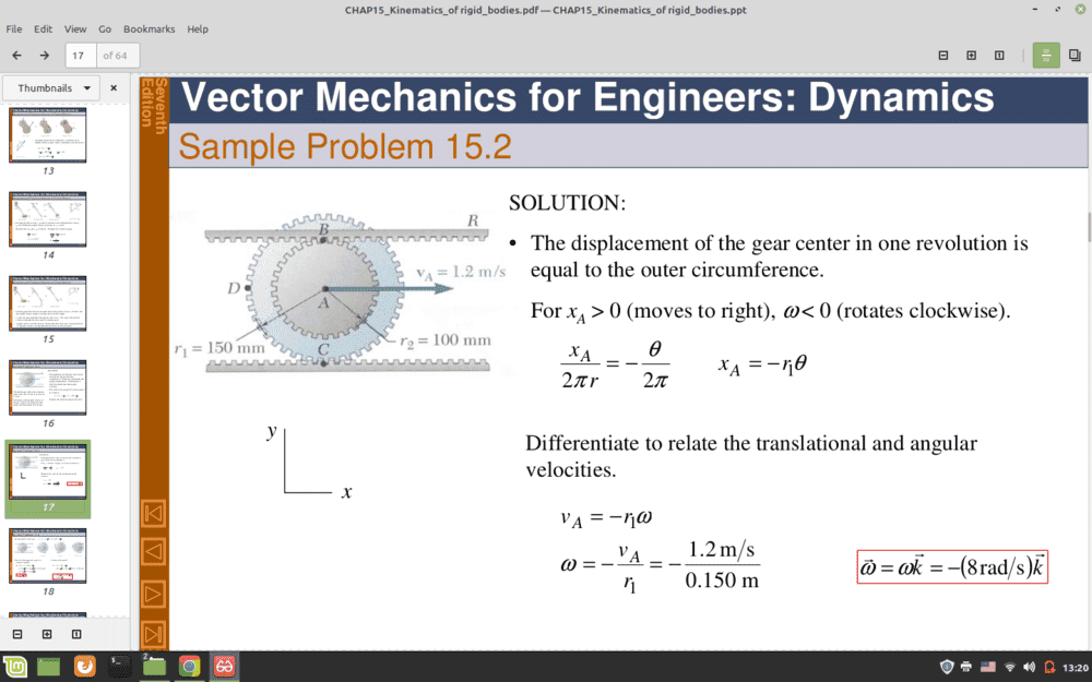

My first question: How does he get the equation ##\frac {x_A} {2πr_1} = -\frac {θ} {2π}## ?

You forgot to define ##\theta## (Solution forgot it too !)
Ask youriself: how far does ##A## go to the right for one revolution (##\theta = 2\pi##) ? For half a revoluton ? For a given ##\theta ## ?

What is the definition of a radian? How is it connected to this question?
for one revolution ##A## goes to the right ##2\pi r_1##. For half a revolution ##\pi r_1##.
For a given ##\theta## goes to the right ##\theta r_1##?
No. Theta is an angle. It does not go to the right. You mean: For a given ##\theta##, A goes to the right ##\theta r_1##. Correct.
Now think the lower rack out of the way. Le A be a fixed axis
Ask youriself: how far does B (rack R) go to the right wrt A for one revolution (##\theta=2\pi##) ? For half a revoluton ? For a given ##\theta## ?
