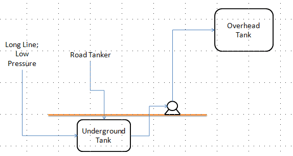

I have a water tank fed from a piping system that has very low head in it. As a result flow tends to be low. See sketch below. I am thinking of ways to boost the flow. I already have a centrifugal pump at the site. Could I use its flow to boost the flow from the incoming pipe via a venturi / ejector design?

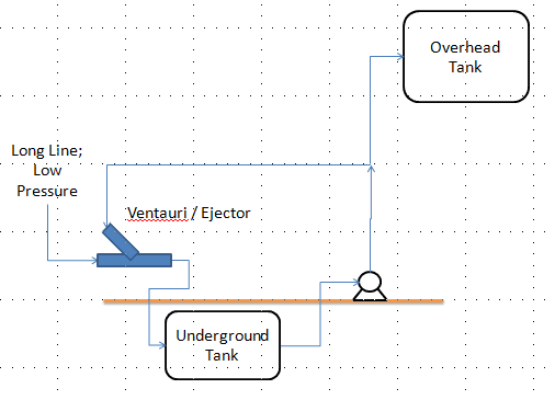

As a DIY project what might be a good way of creating the venturi? Would a simple tee work? Or would I need a converging diverging nozzle (e.g. see the sketch below)? Any ideas how to chose the nozzle dimensions?

Without some idea of the dimension of the problem it is hard to specify a venturi solution.
A venturi injector can generate a significant pressure step in a fluid. There is little advantage in boosting the pressure close to the outlet since suction is limited by atmospheric pressure. That is especially true when the line is long and the diameter small. It is therefore better to move the injector as far as possible towards the start of a long input line. To do that consider laying a larger diameter input line, if that alone does not resolve the problem when used in parallel with the original, use an injector at the larger pipe inlet driven by the centrifugal pump reversing the water flow along the original input line. That will maximise the advantages and economy of using a pump.
There is a common hidden problem with low head lines. They are often unable to purge themselves of air. That air forms a bubble that is effectively flowing in the opposite direction to the water and so restricts the flow. Avoid humps in a low flow line.

Length of Low Pressure Line = approx. 500 m.
Diameter = 1 inch
I don't have access to the upstream end of the line for pressure measurement etc. At the downstream end the current head is very low. Approx. 6 ft of water.
Desired flow is as much as reasonably possible. Right now the flow seems to be slugging. i.e. Instead of a continuous stream of low pressure it comes in slugs.
Isn't there a strong suction at the throat of the venturi? Right now the downstream pressure would be atmospheric and I was hoping that if that dropped to a vacuum I could derive up to 1 atm of additional driving force.
How much this would boost flow I am not sure since I do not know what the exact upstream pressure is.
Yes. But suction only gives atmospheric pressure maximum.
A venturi injector can develop an output pressure well over 100 psi. But it can only generate 14.5 psi suction. Maybe 1 atm of suction from the centrifugal pump is sufficient to pull the air bubbles from the line? Recirculate some water around the pump to keep the pump filled with water to maintain suction.

The parameters are: 1 inch pipe at the outlet end and you don't have access to the inlet. Only 6 ft of drop in 500m. 'Slugging', surging, = flow intermittently stops.
Try a simple solution first. I would skip designing a venturi for now and try connecting that 1 inch pipe directly to your pump inlet.
Practical issues: Everything on the pump inlet side must be absolutely airtight.
And ... the friction losses in a quarter mile of 1 inch pipe will be great. I wouldn't expect a drastic increase of output.

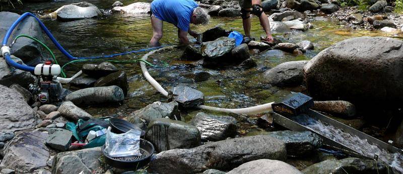

Practical application of an eductor: Hobby mining on our gold mining claim in the Northern Sierras 2008.
For 30 years we used larger gear I designed and cobbled together out of available materials. (Application of my interest in practical engineering). I finally decided I was too old to backpack a 5hp B&S engine (rototiller engine), my kids were grown and less interested in being my pack mules, and I could afford to buy the factory-built components shown here.
Stock photo, illustrating the 'suction nozzle' I am operating. The alternative, a 'power jet' installed at the intake to the sluice box, is shown in the Keene links I included in post #3 above. That alternative has greater lifting power, but is not suitable for shallow water since it loses prime if the intake is allowed to suck air for a moment.
