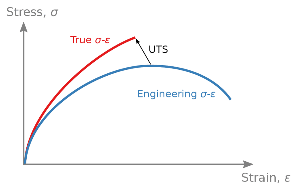

Thanks for the responses!
hutchphd: That's fair enough if you're just going to slap a number named "Young's modulus" on a material and call it a day, but I'm talking about a stress-strain graph and why its slope is constant up to the limit of proportionality. Maybe the term "Young's modulus" is the wrong one to use and I should just say "stress over strain," but still. I can't really see how stress can be proportional to strain and tension be proportional to extension at the same time without the ratio L/A being constant.
Kyouran: That would make sense to me if the graph of engineering stress vs. engineering strain is a straight line, but true stress vs. true strain isn't. But from what I've seen, they both appear to be straight lines up until the limit of proportionality, and that's what's confusing me.
The engineering stress vs strain is what I am referring to. They cannot both be linear. Check the following:
https://en.wikipedia.org/wiki/Stress–strain_curve#Engineering_stress_and_strainwhere it is shown that true stress is
edit: I guess I should point out explicitly that $$ln(1+x)=x-x^2/2 +x^3/3-...$$ so it all depends upon where the plastic flow starts.

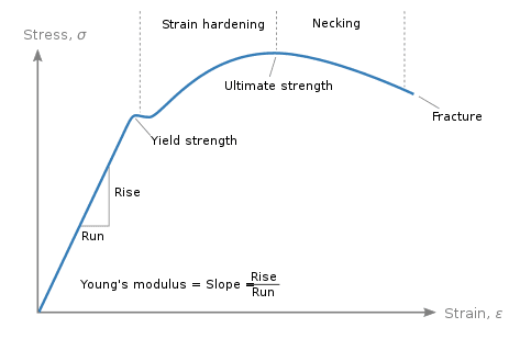

That makes sense, but it also appears incompatible with this paragraph further down (italics mine):
"The first stage is the linear elastic region. The stress is proportional to the strain, that is, obeys the general Hooke's law, and the slope is Young's modulus."
The two graphs there also seem contradictory.
This one makes sense:
Whereas this one doesn't:
I can't see how what you said can be true and the first part of this graph be true as well.
The "type" of strain on the graph is not specified. They are not equivalent.

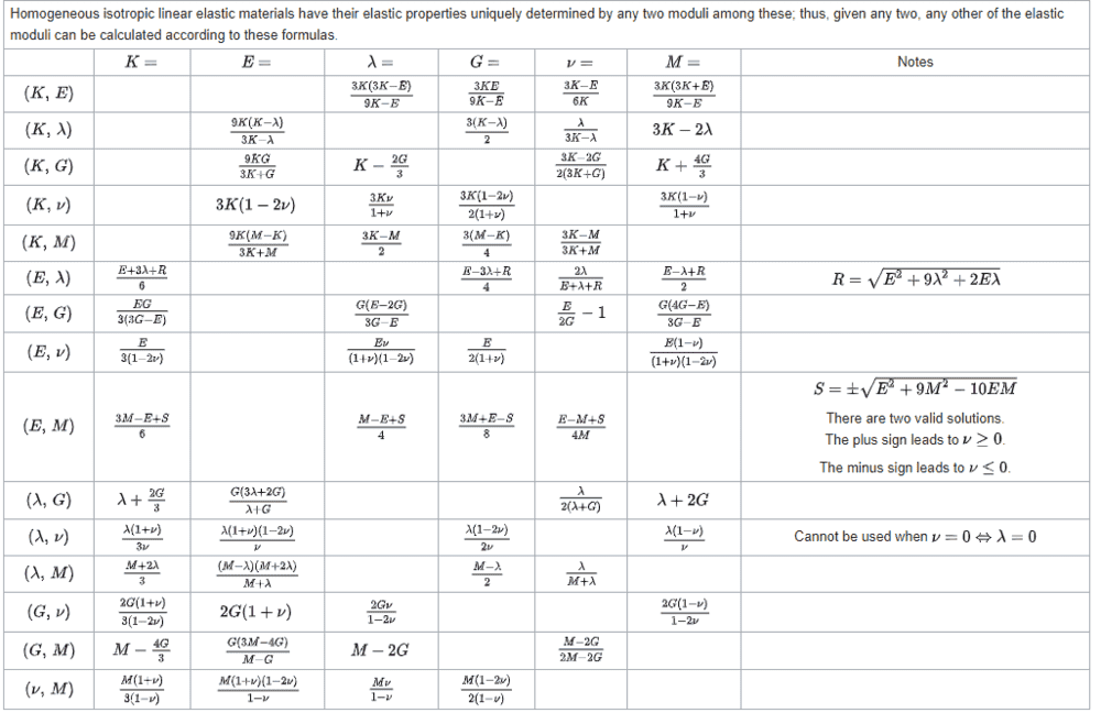

Did you read the Wikipedia article on Poission's Ratio??`
For isotropic materials we can use Lamé's relation[9]
\nu \approx {\frac  {1}{2}}-{\frac  {E}{6K}}
for young's modulus E and bulk modulus K
Stress and strain are tensor quantities. For example, a wire can be approximated by 1d stress and the constant of proportionality is E and a plate can be approximated by 1d strain and the constant of proportionality is K+4G/3. Force and displacement are integrated quantities and are what are commonly measured. If the shape does not change, equivalences are trivial. Stress and strain are the proper variables, so one should turn your question around and ask when does F=kx work.

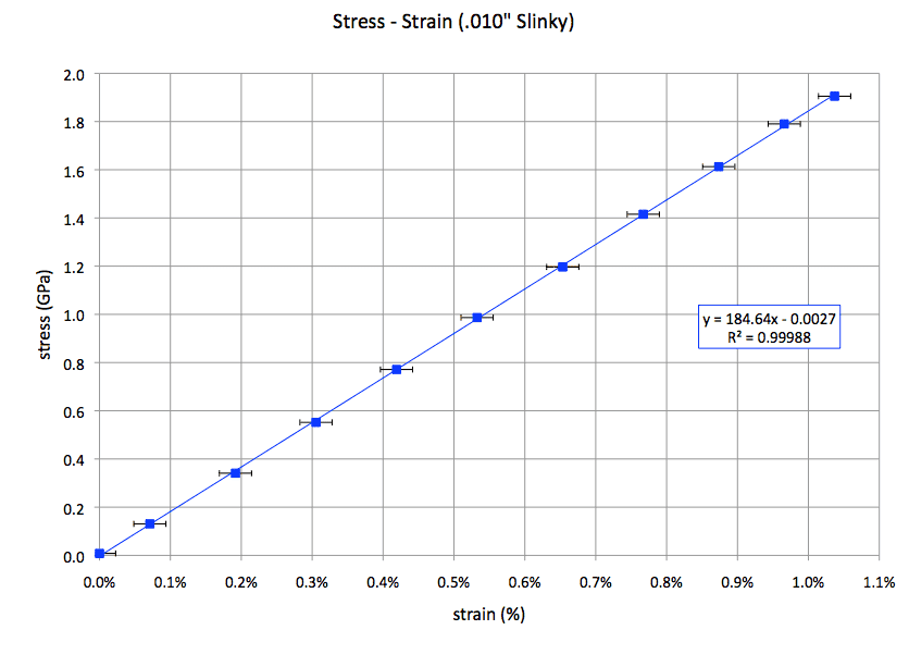

I measured a guitar string one time, hanging weights and using a micrometer to determine the stretch. It looks pretty linear to me:

From the graph I posted you can see I stretched it about 1%. The string was around 90cm long. Using the same steel I imagine you could design a coiled spring that stretched 100% or more and be linear over most of its range. It wouldn't sound as good though.
For isotropic media apparently any two of the "moduli" are sufficient to characterize. In particular as mentioned earlier the ratio of extension (Young's) modulus E to bulk (compressive) modulus K tells the tale. But even for isotropic stuff it depends upon the details of the molecular folding. This is fascinating ( from wikipedia article on Bulk modulus):
https://en.wikipedia.org/wiki/Bulk_... modulus ( or,relative decrease of the volume.
I can see we are not disagreeing basically. All I have been pointing out is that different experiments examine different ranges of conditions. A Guitar string is made of appropriate material and has dimensions to allow it to resonate at the appropriate frequency with the 90cm length. Its "k" is constant enough over the range of conditions needed for the tuning (It has to). I can't see any reason why a short fat steel bar would not also have a constant k range if it's isotropic. Probably the 1% range of extension? But a fat bar will not remain parallel sided (hence the importance of using tensors in those cases).
