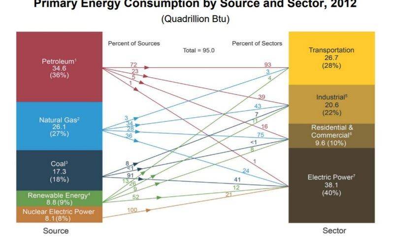

  • #1,481
OmCheeto said:
I think I would now fall into the "residential" power use category.
My bad.
No problem, but here are some rough numbers we can use in future posts.
https://www.eia.gov/electricity/dat...echart&ltype=pin&rtype=s&pin=&rse=0&maptype=0
US Retail sales of electricity by sector 2016.
Residential 33%
Commercial 33%
Industrial 23%
Transportation 10%
The above is only electric. Below is total energy by sector. Note that the electric fraction of total energy below is further delivered to residential/commercial/industrial/transportation as shown above.
For example, online shopping displacing brick and mortar stores (and personal car trips to stores), can have a bigger influence on total energy consumption than residential LEDs + insulation + conservation.
Imagine conversion of transportation to electric, and its impact on the electric sector.
Likes russ_watters
  • #1,482
Thanks @anorlunda. That second chart is interesting. I'm having a little trouble with 4% of transport being provided by "renewable energy." What do you suppose that is? There aren't that many sailors, are there?
Ahh maybe ethanol?
  • #1,483
gmax137 said:
Ahh maybe ethanol?
If ethanol is counted as renewable, you may be right.
