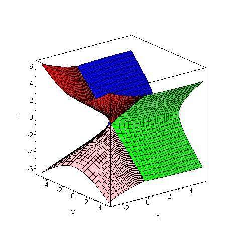

The embedding diagram embeds the r-t plane of a Schwarzschild black hole (along with the Kruskal extension) such that you could draw a standard space-time diagram on this curved surface. Formally, this means that that it embeds the space-time of the r-t plane of the black hole not in a Euclidean space, but in a Minkowskian space with 2 space + 1 time dimensions.
I've attached a copy of the embedding diagram here. The green region is our normal space-time, and the red region is the black hole. The line between the green and red regions is the event horizon. Time runs up the page. You can see that the event horizon is a trapped light beam (which is one of the standard defintions of an event horizon, a trapped null surface).
As I mentioned, you can imagine curved space-time for this black hole as drawing your standard space-time diagrams on this curved surface, rather than on the usual flat sheet of paper. (The coordinate on the vertical axis is the 't' coordinate.)
What is all the rest of the stuff on the diagram? Well, the Schwarzschild black hole with the Kruskal extensions is really a wormhole connecting two differnt asymptotically flat space-times, so the pink region is the "white hole", and the blue region is the "other" asymptotically flat space-time.
The entire event horizon is then the region (pair of crossed lines) where the different colors meet. You can see there's nothing really special about it locally.

Ditto pervect's recommendation of the Marolf paper, but only after you have mastered the basics of surface theory and some elementary gtr, I think!
The embedding picture you are thinking of, I think, is the Flamm paraboloid, which is an embedding of a hyperslice orthogonal to the world lines of static observers. Such a slice never makes into the interior but its equator corresponds to a two-sphere worth of events on the horizon. There is an excellent discussion in Misner, Thorne, and Wheeler, Gravitation, one of the best books ever published on any topic and by common consent one of the classics of scientific literature and a milestone in the development of physics, arguably comparable to books by Newton or Galileo.
Note that as MTW stress, to understand the geometry of the spacetime itself from a sequence of embeddings of "succesive" spatial hyperslices, Carter-Penrose diagrams are extremely helpful.
