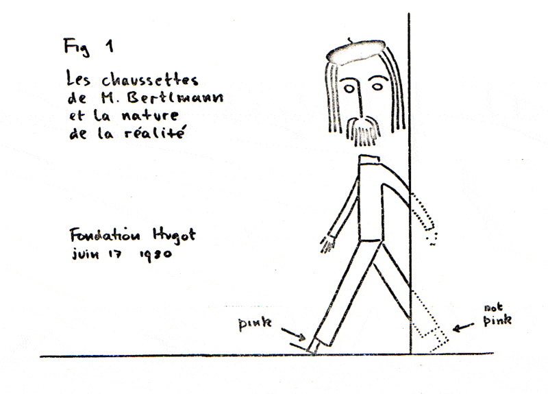

From my days in graduate school, I still have a yellowed 27-year-old photocopy of a preprint of one of Bell's lectures about M. Bertlmann...
I've got that same preprint! Classic.
