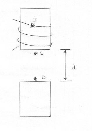

Let us go back to the example given by quantum.
Consider a scrapyard with a crane electromagnet 6 feet above a vehicle.
The current is off and nothing happens. Both the electromagent and the vehicle are uncharged electrically.
Now switch the current on and slowly increase it. Both the eelctromagent and the vehicle remain uncharged.
However at the point where the magnetic attraction exceeds the force of gravity each and every particle of the the vehicle will be displaced upwards, including the electrons.
Work is done by the difference between the force of gravity and the force exerted by the electromagnet. No other forces are acting. Since there is no charge there are no electrostatic forces acting.
Now I see no point in trying to break this macroscopic theory down to particle level.
If you do that you have to explain why the protons and neutrons are also displaced upwards. They are not charges 'in motion' in the same way as electrons, so why should they be subject to the Lorentz force?
The truth is you need a different model at particle level.

I have modeled the crane and car as two slugs of ferrous metal of identical cross section area, A and separated by a distance, d. F is the force of attraction and B is the flux density produced by current I in the coil wound round the upper slug to model the lifting crane.
Further for practical calculations the approach based on magnetic poles and the magnetic inverse square law has much to commend it.
F \propto \frac{{{m_1}{m_2}}}{{\mu {d^2}}}

I agree that
In my model (as in the diagram) the current in the coil creates a magnetic field which in turn creates a magnetic pole on face C of the upper slug, A.
This in turn induces a temporary opposite magnetic pole on face D of the lower slug.
The two poles attract in the normal way with a force F, sufficient to lift the weight, W, of the slug, B, a distance, D, doing work WD.
The strength of the magnetic field necessary to do this can be calculated from my equation and easily related to the coil current, if so desired.
I also agree that at a molecular or sub molecular level the magnetisation is caused by a complicated interaction of the coil field and the (charged) particles constituting the slugs but that the mathematics of considering things this way is profoundly more difficult.
As an analogy do I track and log all the velocities and masses of gas particles and the container surface contours using these to calculate the total impact forces upon the coantainer walls or do I just use Force = pressure time area?

Studiot said:
I agree that
I agree with all of this too. However, it doesn't change the fact that classically, magnetic forces do no work. F=\frac{B^2A}{2\mu_0} is the approximate force of attraction, and this net force does work. However, it is not a "magnetic force".
Do you still disagree?

Once again, the above thread settled the issue. For those who won't read it, here is the long & short of it.
Nothing has been settled.
The explanations here, like the link provided in the quote, lead to a dead end.
The plain fact is that non one has provided a calculation or explanation of what direction a point charge needs to be moving, in accordance with V x B, in order to experience a displacing force parallel to the B field.
This issue is clearly demonstrated in my post#22.
Saying the energy comes from the battery is not in dispute, but it is sidestepping the issue.
  • #50
And no one can, because there is no such direction. That should be obvious from the equation itself.
