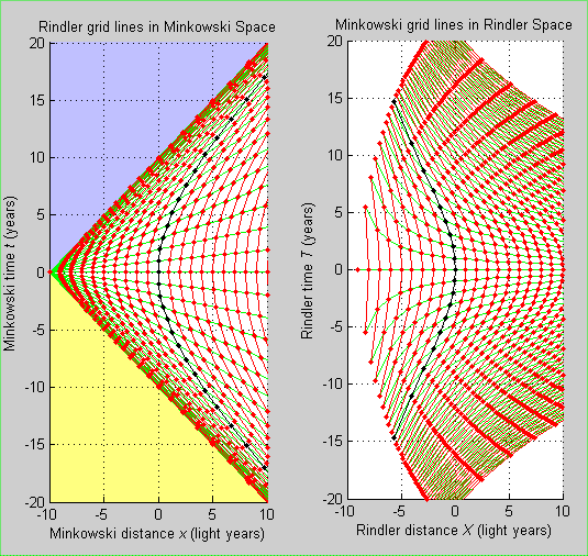

I decided to draw my own diagram (or, rather, get MATLAB to do it for me), so here it is.
With units of c = 1 lightyear/year and a=0.1 lightyear/year2 (the black observer's proper acceleration), the left hand diagram shows
[tex]x = X \cosh \frac{aT}{c}[/tex]
[tex]ct = X \sinh \frac{aT}{c}[/tex]​
The right hand diagram shows the inverse transformation
[tex]X = \sqrt{x^2 - c^2t^2}[/tex]
[tex]T = \frac{c}{a}\tanh^{-1}\frac{ct}{x}[/tex]​
the red lines being worldlines of free-falling inertial particles. For technical reasons, I haven't drawn the grid lines near the event horizon at X=-10, nor have I drawn the grid lines for large x, but the lines should really fill the right hand graph.
I haven't drawn the photon worldlines either, but you can imagine them joining the red dots across the diagonals of each distorted "square" of the grid.
Note that both photons and massive particles take an infinite Rindler time T to reach the event horizon, but only a finite Minkowski time t to do so (and then pass through to the purple zone). Nothing can pass through the event horizon in the opposite direction out of the purple zone.
The purple zone looks rather like a black hole according to a Rindler observer (and the yellow zone looks like a white hole).

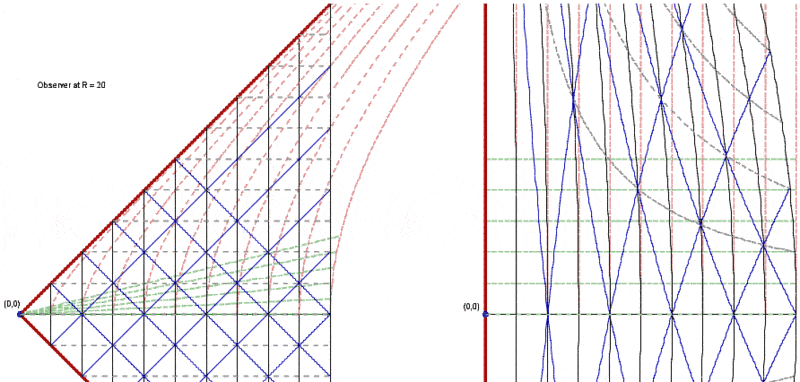

Hi DrGreg,
Sorry about the delay in responding and many thanks for the diagram and equations. I found them useful. I also decided to create a diagram for my own education and have added some detail including the null worldlines of photons in the Rindler chart.
I have colour coded all the worldlines so that they are same in both the Minkowski and Rindler charts to make it easier to follow what is going on. The dashed red lines are the worldlines of the accelerating Rindler observers while the the solid black lines are the worldlines of the inertial Minkowski observers. The dashed green lines are the lines of equal proper time for the Rindler observers and the dashed grey lines are the equal proper time for the Minkowski observers. The solid red lines on the left of both the Minkowski and Rindler charts are the effective event horizon for the accelerated observers as they are unable to observe anything to the left of the horizons. (The free falling inertial observers do not see an event horizon). The solid blue lines are representative null worldlines of light rays. I noticed that the curvature varies with location of the Rindler observer so I have made an animated gif showing how it varies with location of the observer shown by a red dot.
I have only shown the accelerated wordlines in the top half of the chart to reduce clutter a bit.
