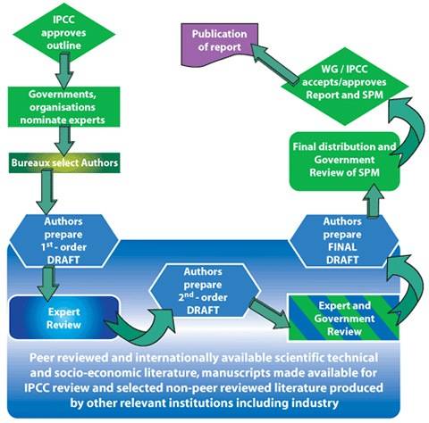

The IPCC is a valid source. It does not conduct science, it assembles the body of research related to climate change every five years into a comprehensive assessment.

When anyone does a paper they assemble research that supports their position. It is called references. The references (or papers in the case of the IPCC) may be valid but not the selection criteria. The report summery is biased and written by policy makers. Anyway, aren’t we getting off topic?
Not really.
It undergoes political review by government delegations, but the summary (at least of working group 1's report) it is written by scientists.
The political review process ensures that the IPCC reports are slightly biased to the conservative. But at least what they say is true. They leave out other stuff that might be true, so things could be a whole lot worse.
Bored Wombat said:
Not really.
No. The report is written by 'participants'. The 'facilitator' reserves the power to rewrite anything.
Interesting opinion.
It undergoes government review last, but the lead authors don't rewrite anything, unless bullied by the government review.
Who is this 'facilitator'?
Since the assessment reports are cited all the time by peer reviewed papers, the IPCC is a valid source for scientific information in regards to climate science.
