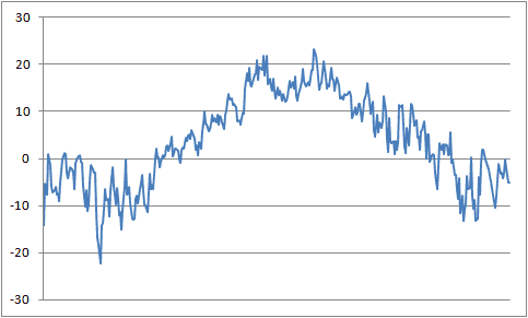

There we go, doing "average" again. Way back, when developing a program to calculate the need for heating/cooling of an office building, I got hold of one year of official meteorological temperature data for one full year in Oslo Norway. Not the "average" temperature during a day, but actual thermometer readings taken four times a day at fixed hours. Running standard statistics on those gave slightly different "averages" over a year at each time-of-day, but in every case the standard deviation was slightly more than 10°C.
With that background, what do you think about the statement "the average temperature of the Earth has increased by 0.1°C in the last 100 years".

Here is the daily noon temperature over a year (Oslo, Norway, 1969)
mfb said:
1400 uncorrelated measurements with a standard deviation of 10°C allow to calculate the average with an uncertainty of about 0.3°C.
I did not say or imply "1400 uncorrelated measurements with a standard deviation of 10°C". What I have is, for each day of the year, the temperature at several fixed time points. Due to the format of the data (think a massive FORTRAN FORMAT statement). it is easy to calculate the average and the standard deviation for each time point, but really hard to calculate the total average and standard deviation. Thus, what I have calculated is the average and the standard deviation for each time point during a year. Most of these standard deviations (of 365 temperatures) are between 10 and 11 degrees*. Using the rule for compound standard deviation, the standard deviation of the aggregate is also between 10 and 11 degrees.
*The sole exception is the measurements taken at 7 o'clock in the morning, where the standard deviation was between 8 and 9 degrees.
It does not make sense to talk about the standard deviation of a single measured temperature value (unless your temperature sensor is really bad). Do you mean the standard deviation in the set of measurements for a specific time of the day?
The number of 10 degrees is the width of your distribution - you can determine the mean much better than this width. And if you pool the different times of the day for a combined average, you get an even better estimate for the mean.

The mean of all temperatures is about 4°C with a standard deviation of about 10°C.
That is the standard deviation of the sample, not the standard deviation of the mean. Standard error of the mean

You call it data. I call it an estimate. When I had measurement theory in First-year University Physics, we were taught that the standard deviation of a series of measurements is an estimate of the measurement accuracy. Therefore, I have nothing against 0.85°C, but I would just as easily agree with 0.3°C or -0.57°C.
No, the standard deviation of this 0.85°C value is significantly smaller, it does not allow 0.3 K or even negative values.
Maybe this concept is easier to understand with body heights: you have a wide range of roughly 1.5m to 2m for adults (with a few outliers) - with a standard deviation probably around 10 cm. If you measure 1000 persons, you can find the average much more precise than "it has to be somewhere between 1.5m and 2m". Actually, you can estimate it with a precision of 10cm/sqrt(1000) = 3mm. If you measure 10000, your uncertainty goes down to 1mm.
If you take tens of thousands of temperature values, your estimate for the average gets very precise.
