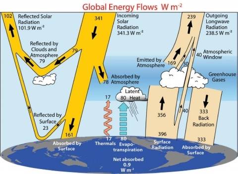

(1) Energy balance
Earth absorbs about 239 W/m2 from the Sun, accurate to within a couple of percent. This is a global annual average, corresponding to a mean for the whole planet on the time scale of a couple of years, in Watts per square meter.
All of that energy has to go somewhere. Almost all of it is radiated back into space as IR thermal radiation. A small excess can be taken up with Earth's own finite internal stores of energy. The largest available internal store is the heat capacity of the ocean, and recent research indicates that a bit under 1 W/m2 is currently being absorbed into the ocean, as it gradually increases in temperature. This is large by comparison with what is normal for the Earth. The flux into the ocean is known with about 20% accuracy at best; a recent published estimate is 0.85 +/- 0.15 (Hansen et al 2005).
(2) The atmosphere
Earth's atmosphere is the reason why temperatures here are on average so much higher than on our airless moon.
The Earth's surface is radiating something like 390 W/m2 as IR radiation from the surface, known to within a couple of percent. Most of that ends up heating up the atmosphere, which then sheds heat into space. On top of that, thermal convection and heat of evaporation transfers almost another 100 W/m2 into the atmosphere from the surface. Most of the Earth's thermal radiation into space actually comes from the atmosphere.
The atmosphere radiates in all directions, and on average something like 330 W/m2 ends up coming back down to the surface. The net flow of energy is thus something like 60 to 70 W/m2 radiant energy leaving the surface, plus the additional 100 or so W/m2 as convection and latent heat. This is what balances with the energy absorbed at the surface, from the Sun.
Here is a recently published diagram, summarizing how energy flows at present between space, the surface and the atmosphere (Trenberth et al, 2009).

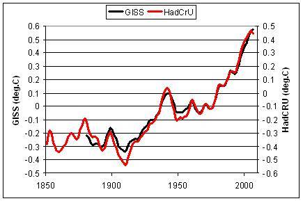

Direct measurements indicate that globally averaged surface temperatures on Earth are increasing in recent decades, at around about 0.02 C/year. (Brohan et al, 2005)
There are many factors that must be involved in any credible account of the causes for rising temperatures. It is certainly not driven by CO2 only. The calculations here demonstrate that CO2 is necessarily an important factor, and may help show why it figures so prominently in the scientific literature for modern global climate.

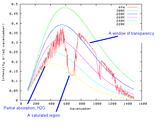

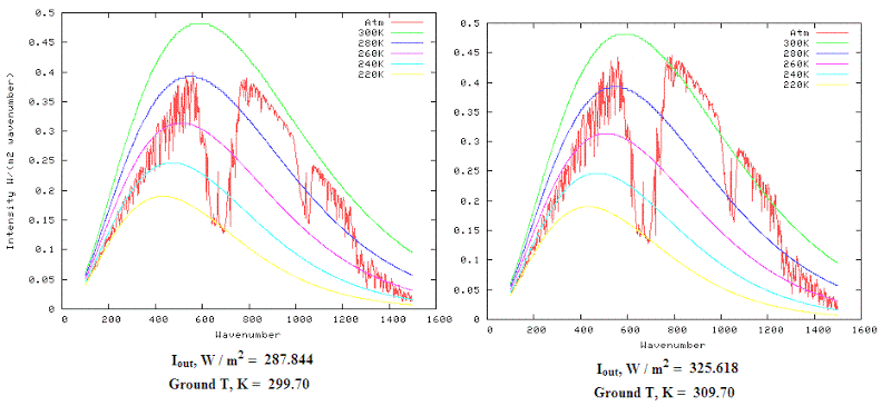

There are a number of tools available for looking at absorption spectra. I'll use an http://geosci.uchicago.edu/~archer/cgimodels/radiation.html , made available at the University of Chicago, which uses much the same techniques as in the paper I cited above, (Myhre 1998). It is not as accurate as fully up to date calculations, but it is able to run quickly for an on-line server, and thus makes a useful pedagogical tool. You can try this yourself as well.
First of all, here is a spectrum for a 1976 US-standard atmosphere profile. CO2 levels are set to 375 ppm, no rain is considered, a surface temperature is set to 288.20K (about 15C) and the result is the spectrum you see coming up from the surface with a detector at an altitude of 20km (roughly the tropopause).
I've labeled three parts of the spectrum in this diagram, to illustrate how it works.
  • A saturated band. The spectrum here follows close to a 220K blackbody, which corresponds to radiation from the top of the atmosphere. The atmosphere is opaque at these wavelengths.
  • A transparent band. The spectrum here follows a bit above the 280K blackbody, which corresponds to radiation from the surface. The atmosphere is transparent at these wavelengths.
  • A partial absorption band. The absorption here is nearly all H2O; CO2 is transparent in this part of the spectrum. H2O is not evenly distributed in the atmospheric column, which is part of the reason the spectrum fits neither surface temperatures nor top of the atmosphere temperatures. CO2 is much easier to handle in the calculation.
In this spectrum, the total outgoing energy flow is 258.893 W/m2.

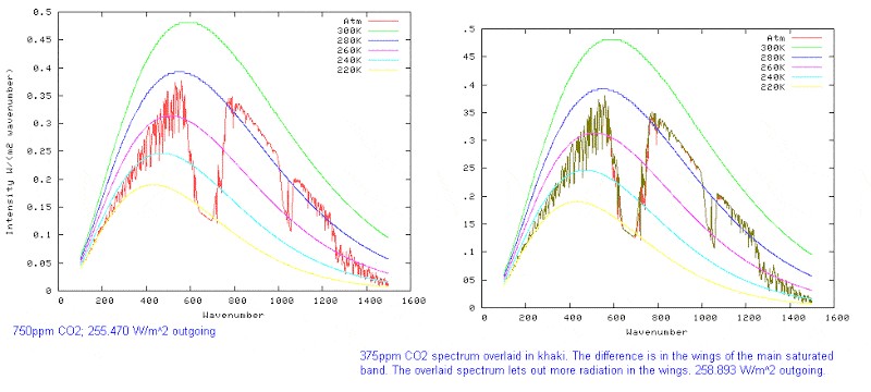

Now here is the spectrum calculated for the same atmosphere, but with 750ppm CO2. It looks almost the same; so I've done an overlay of the 375 spectrum on the right, to help compare. You can see that the 750 CO2 spectrum absorbs a little bit more radiation along the wings of the main saturated band; enough to reduce the outgoing energy by a little over 1%. Outgoing radiation this time is 255.470 W/m2. The difference is 3.423 W/m2; close to what is obtained by the more precise calculations used in the literature. You should get similar differences when you try other atmospheric profiles or conditions, and double the CO2.
Since I am not an expert in my own right, you are well advised to check up further from more authoritative sources, such as any undergraduate level text on atmospheric radiation. They should all deal with the concept of absorption in the wings of a saturated band. The spectra I have provided here are calculations, based on solidly established physics. The details of line broadening and absorption in the wings of a saturated bands can be seen directly in experiments. The current spectrum of the Earth can be observed from space, and it conforms to the theoretical calculation for prevailing conditions.

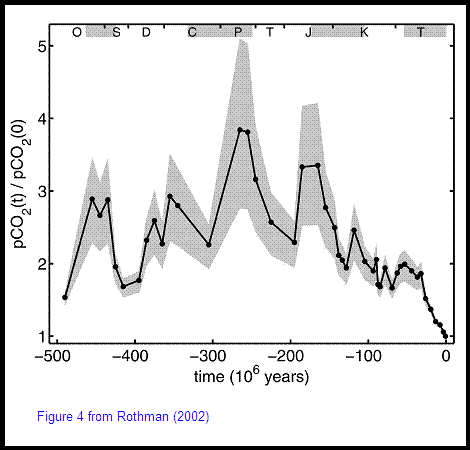

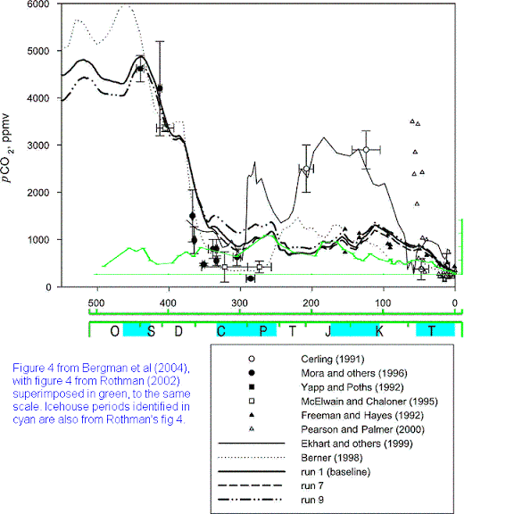

As a minor point, you have the situation with the past backwards. Throughout the past, high CO2 is found with high temperatures, and low CO2 with low temperatures. There's a kind of two way effect involved here, which is the more usual source of popular confusion. Rising temperatures can raise CO2 levels, and rising CO2 can raise temperatures. They tend to feed on each other, so it's not always clear which one is in the driver's seat! But the relationship is a very clear positive correlation throughout Earth's history.

2. In the past the planet has been warm when CO2 levels were low and cold when CO2 levels where high.

This is the paper I was referring to that shows that atmospheric CO2 levels have been high when the planet was cool and low when the planet was warm.
Atmospheric carbon dioxide levels for the last 500 million years by Daniel H. Rothman
http://www.pnas.org/content/99/7/4167.full.pdf+html
The last 500 million years of the strontium-isotope record are shown to correlate significantly with the concurrent record of isotopic fractionation between inorganic and organic carbon after the effects of recycled sediment are removed from the strontium signal. The correlation is shown to result from the common dependence of both signals on weathering and magmatic processes. Because the long-term evolution of carbon dioxide levels depends similarly on weathering and magmatism, the relative fluctuations of CO2 levels are inferred from the shared fluctuations of the isotopic records. The resulting CO2 signal exhibits no systematic correspondence with the geologic record of climatic variations at tectonic time scales...
...The most recent cool period corresponds to relatively low CO2 levels, as is widely expected (30). However, no correspondence between pCO2 and climate is evident in the remainder of the record, in part because the apparent 100 My cycle of the pCO2 record does not match the longer climatic cycle. The lack of correlation remains if one calculates the change in average global surface temperature resulting from changes in pCO2 and the solar constant using energy-balance arguments (7, 26). Superficially, this observation would seem to imply that pCO2 does not exert dominant control on Earth’s climate at time scales greater than about 10 My. A wealth of evidence, however, suggests that pCO2 exerts at least some control [see Crowley and Berner (30) for a recent review]. Fig. 4 cannot by itself refute this assumption. Instead, it simply shows that the ‘‘null hypothesis’’ that pCO2 and climate are unrelated cannot be rejected on the basis of this evidence alone.

If you look at figure 4 there are 4 ice epochs on the planet. We are living during the fourth. For the other ice epochs CO2 was above 2000 ppm which seems to indicate that the effect of CO2 on the planet's temperature, saturates at some level.

OK; I've had a look. Saul cites:
Rothman, D.H. (2002) http://www.pnas.org/content/99/7/4167.abstract, in PNAS, April 2, 2002 Vol. 99 No. 7, pp 4167-4171
There are several important points. First, and by far the most important:
(A) This is a complete non-sequitur
The existence or otherwise of other factors that may be driving climate cycles apparent over long times spans, of 10 million years or more, is completely irrelevant to deciding whether or not CO2 has a significant impact over the scale of recent decades.
The scale difference here is enormous. What is short term for Rothman is anything less than 10 million years. That is enough to encompass the entire Quaternary period several times over, with all its many the cycles of ices ages and interglacials!
This cannot be emphasized sufficiently strongly. There are many different factors impacting in climate, and in principle there is nothing implausible at all about long term climate change, on the scale of 10 million years or more, being driven primarily by factors other than CO2. This is in no conflict whatsoever with the immediate physical impact of changing CO2 levels, which is about solid as anything ever gets in science. It is truly elementary thermodynamics.
If people get nothing else from the thread, they should at least get this. A long term climate trend driven by something other than CO2 is no conflict at all with CO2 being a factor to drive climate above and below this other putative larger and slower trend.
It's as if you were using the theory of continental drift, which moves whole ecosystems vast distances over the scale of millions of years, to refute the idea of biological factors being important for the short term shifts in the boundary of a rainforest.
(B) Rothman himself explicitly denies the application being attempted in this thread
This should kill the argument dead. Looking at the extract from Rothman's paper, which Saul provides, Saul appears to have missed the implication as far as this thread goes. Rotham states:
Superficially, this observation would seem to imply that pCO2 does not exert dominant control on Earth's climate at time scales greater than about 10 My. A wealth of evidence, however, suggests that pCO2 exerts at least some control [see Crowley and Berner (30) for a recent review]. Fig. 4 cannot by itself refute this assumption. Instead, it simply shows that the “null hypothesis” that pCO2 and climate are unrelated cannot be rejected on the basis of this evidence alone.
The last sentence there is a triple negative, which can be confusing! But the rest of the paragraph is better. Rothman suggests, on the basis of his reconstruction, that CO2 is not dominant on long time scales. As I have noted, this is completely consistent with the obvious immediate physical impact of CO2 on shorter time spans.
Rothman is explicit that there is a wealth of evidence for CO2 having at least some impact, and that his diagram does NOT refute this.
The clumsy final sentence in Rothman's paragraph claims that the other evidence – which he does not actually discuss! – can't reject the null hypothsis of no impact. That is an odd remark. Of course the evidence goes powerfully against the null hypothesis. The implication of Rothman's reconstruction as shown in his figure 4 is rather that the relationship with CO2 may be over ridden on longer time spans by other unidentified factors. In principle there is nothing wrong with that notion, and it is in no conflict at all with the plainly demonstrated physical impact of CO2 in recent decades.
Rothman says this explicitly when he notes that his reconstruction "cannot by itself refute this assumption". Quite so. So let's stop pretending that it does.
But Rothman's work on the longer term scales ALSO has problems of its own. This is the next point:
(C) Rothman's reconstruction is at variance with related work before and since.
A summary of different attempts by a number of authors to estimate CO2 levels over this period is available in Bergman, et al (2004).
I've taken the figure 4 from that paper, which compares a range of published work using proxies or other others, and superimposed upon it the figure 4 from Rothman (2002) in green, rescaled so that the diagrams align. I have also included the icehouse periods identified in Rothman's diagram. Rothman's work diverges sharply from all other reconstructions past about 300 Mya BP.
This is a much less important point than recognizing that putative unidentified long term climate drivers is completely consistent with the physical importance of CO2 on short time spans. But I think it is worth noting for the record that Rothman's reconstruction has problems of its own with other lines of evidence. It's all open research, of course; and none of it is any problem whatever for the simple physics of CO2 and radiative transfers.
There are different proxies to determine CO2 levels. Rothman's conclusion that CO2 levels do not correlate with planetary temperature is not contested. (See the paper linked to a the end of the comment.
Bergman's data shows CO2 levels in excess of 1500 ppm during the ice epochs and in other cases the CO2 levels drop but there is no ice epoch. Bergman's data also shows the Ice Epochs do not correlate with CO2 levels.
(Saul - Cut. I will respond to the other scientific issue in with separate comments.
Actually, the word "ice" does not appear anywhere in Rothman's paper.
This is not to suggest that no glaciers existed on Earth between 600 to 25 Ma. It is generally understood that 500ppm CO2 will not exert enough of a warming to melt all glaciers at higher elevations in the polar regions. This is one reason why East Antarctica is not expected to melt; it is simply at too high of an elevation. On the other hand, CO2 levels impact the elevation/latitude necessary to support ice sheets and this is why there has been such a retreat in the amount of ice at both poles.

This is a new explanation. Are you suggesting the sun or the planet does not emit the frequencies that the CO2 absorbs and emits?
Think about this one for a minute: it's key. The frequencies that CO2 can absorb and emit will not get from the surface to the stratosphere. They'll be absorbed, and emitted, all the way up the atmospheric column.
What eventually gets into the stratosphere, at these wavelengths, is emission from somewhere around the tropopause, which is the very coldest part of the atmosphere. You can see this in the calculated spectra I gave back in [post=2165483]msg #3[/post], and the same thing is seen in direct satellite measurements.
Increased interaction with thermal radiation, therefore, works up here as a cooling effect. You can think of greenhouse gases a bit like a large radiating surface, which can be used for passive heating or passive cooling, depending on whether you are hotter, or colder, than the background radiation around the radiator. This is not a new explanation at all.

You appear to be unaware of the current planetary temperature data. The planet is cooling.
How can that be possible with the 1.5C to 4.5C hypothesis. What is causing the planet to cool?
On the contrary; I am very familiar with the temperature record indeed, and I could see this response coming a mile away. In anticipation of this objection, I have already included this paragraph in an earlier post:
sylas said:
I think I can see where this is going; so I'll just note for the record. The planet has lots of natural short term variability. From year to year there are changes going on that can give unpredictable differences, and this is effectively noise in the temperature records. The last 35 years has seen a strong trend of increasing global temperature, but for a randomly chosen sequence of ten consecutive years somewhere along that 35 year period, you might have anything from twice the trend to no trend at all, within about 2σ bounds of variation.
2008 was a cold year, in the short term. It's the coldest year of the 21st century. 2008 was a hot year, in a long term. It's hotter than any other year of the 20th century, excepting only the big El Nino years of 1998/1997. That's according to either GISS or HadCRUT, and I'm sure you'll get the same in any reputable global temperature record.
Over the last ten years, the trend is for increasing temperatures. Depending on the dataset, this might be right back to the long term trend again, or else something rather below the trend but still positive. The difference is well within regression trend measurement errors over such a short time span.
If you look at even shorter windows of time, like the last eight years, only then you can find a negative trend. Short term variation in the trend is a normal consequence of the natural variation going on, all the time, and it is statistically insupportable to present this as an end to the long term trend of increasing temperatures.
