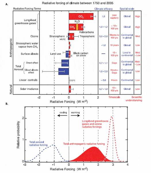

Still a red herring.
I DID give the magnitude of the carbon dioxide forcing in relation to other measurements... measurements of temperature change. That's enough for what I have shown in the thread. No matter what other forcings are involved, we KNOW that the forcing of carbon dioxide is of a similar magnitude to the total effect of observed increasing temperatures. That means it is necessarily significant.
The relationship to other causes could be used as well, which would make carbon dioxide stand out even more. But keep it simple. You can compare the expected impact of carbon dioxide with the observed consequence of all forcings whatever they may be. That's what I did in the original post.
Do you have any problem with the sequence of steps? It should be pretty straightforward! Here again is the comparison, quoted from message #1.
sylas said:
For example, over recent decades the rate of increase of CO2 has been around about 2ppm/year, on top of about 385ppm. The corresponding contribution of CO2 to rising temperature is about Se*Ln(387/385), which is in the range 0.011 to 0.034 C/year, with a best estimate of 0.022 C/year.
Direct measurements indicate that globally averaged surface temperatures on Earth are increasing in recent decades, at around about 0.02 C/year. (Brohan et al, 2005)
I'll give the other method below, using comparisons with other forcings, just for completeness.
skypunter said:
sylas said:
Consider a case where water levels are dropping in a reservoir. In investigating possible causes, you find that there's a leak, and that that further investigation suggests something between 2 and 5 Mlitres/day will be lost in the leak. The water level drop indicates about 4 Mlitres/day is being lost.
You've not shown that the leak is all that matters. You HAVE shown that the leak is significant.
Analogies are fun, helpful and instructive.
Consider that a porus strata may be absorbing some of the water.
Right. Now THINK. No matter what other factors may be involved, the magnitude of the leak shows that it HAS to be a significant part of the total reservoir losses. You DON'T NEED to know about the porus structure to figure that out. A study of the magnitude of the leak shows for any reasonable person that the leak is significant. There may well be other significant effects, but a comparison of the impact of the leak with the magnitude of total losses is enough to establish that the leak is necessarily a significant part of the whole picture. OK?
Now pay real close attention here. I've said this throughout the thread and just maybe you'll get it this time.
I am NOT trying to solve the whole climate problem. I know there are other factors than carbon dioxide. I am trying to address one point which is a matter of popular confusion and uncertainty. This is basic basic science; and not dubious in the slightest. Carbon dioxide is necessarily an important factor driving increasing temperature in recent decades.
skypunter said:
sylas said:
This is what I have done with CO2 in this thread. The CO2 forcing is well known basic physics. The total impact is large. It is necessarily significant, no matter what other forcings are involved, because it is of a comparable magnitude to the forcing required for observed global temperature increases.
How do we account for the decreases?
What decreases do you mean? As I have said throughout this thread, climate is not a completely solved problem. I hope this isn't yet another red herring to into some other issue. We are NOT trying to solve the whole climate problem here. Even if we had no idea what causes short term variations, it would make no difference to the basic scientific demonstration of the significant of carbon dioxide, that is the topic of this thread.
But let me guess -- because in fact we do have some reasonable indications of the causes for short term decreases.
  • There's a small decrease in global temperatures in the middle of the twentieth century. A significant part of that is mostly likely driven by aerosol forcings.
  • There's a lot of short term variation in the climate record, driven by a number of factors. Volcanic eruptions have given some sharp dips in the record, and recently there's been a small impact from the extended solar minimum. There is also a larger impact from the ENSO oscillation, which I have mentioned previously in the thread, and which is the major cause for 1998 being well above the normal trend and 2008 substantially below. The overall trend still remains positive over this time. It is also easy -- and silly -- to cherry pick data over a few years only and find decreases just from unforced variation.
None of this makes a blind bit of difference to the straightforward demonstration of the significance of the carbon dioxide impact, which is necessarily a crucial factor no matter what other impacts are involved.
skypunter said:
sylas said:
It would be possible to go into a lot more detail, and look at the work in quantifying, with uncertainty limits, all the various forcings involved. Such a study would show that CO2 represents a bit over half the total greenhouse impact, and that non-greenhouse forcings are much less well known, but negative, or else an order of magnitude smaller.
Such a study does not exist.
Of course it does! This is a whole field of investigation with hundreds of papers. There's been a heck of a lot of work in quantifying all the various forcings involved. Here's a summary of what is known, along with uncertainty bars. (Figure 2.20 from the IPCC 4AR, WG-1, chapter 2.)
Points to note. The carbon dioxide forcing is about 1.7 W/m2, as I have calculated. This is the largest single positive forcing. All other greenhouse gases combined give a similar positive forcing on top of the CO2 contribution. The largest negative forcing is from aerosols, and the uncertainty is large. A distribution of possible total forcing is shown at the bottom.
You can give an independent estimate of the total forcing based on the total temperature change and ocean heat flux, and you get the same basic range of what is scientifically credible... the net forcing is somewhere from 0.6 to 2.4 W/m2. CO2 gives about 1.7 of that, and so stands as the largest single heating influence, though of course the other lesser forcings are crucial when attempting to get a complete picture.
There are hundreds of papers involved in this kind of study, so it's a bit of dilemma to know what to cite! But here are two, both of which give a kind of review of the field:
  • Shine, K.P. (2000) Radiative Forcing of Climate Change, in Space Science Reviews, Vol 94, No 1-2, pp 363-373.
  • Joos, F. and Spahni R. (2008) http://www.pnas.org/content/105/5/1425.abstract, in PNAS Vol. 105 no. 5 pp 1425-1430
skypunter said:
sylas said:
Note that my original post did not claim that CO2 is the largest single forcing. In fact, it is, quite easily, but to show that would have required a longer and more detailed argument. So I kept it at an even more basic level. I'm trying to keep this as simple as possible, because so much popular misconception is at this really fundamental disconnect from basic physics.
Sometime a basic level of discussion is the best course, so long as the conclusions are justified by the argument. I see no proof in basic physics that CO2 is the largest single forcing.
As I told you, I have made no attempt to give such a proof. The word "proof" is a problem, because science does not really deal in "proof", but evidence.
To keep this thread simple, I stuck with calculation of forcing and comparison with empirical observations of temperature change and sensitivity. This demonstrates for anyone with minimal literacy in science that the carbon dioxide impact is necessarily a significant factor for recent global warming... but it is not strictly "proof".
In the same way, you can take the large body of literature on forcings, summarized in the above diagram, as an overview of the state of scientific knowledge so far. Carbon dioxide does indeed stand out as the largest single effect for heating of the planet at this time. There are still large error bars there, and of course the whole vexed issue of sensitivity to forcing, time scales, regional distributions of change and so on; but there's really no credible prospect at all of some other positive forcing being as big as the CO2 forcing. That's why scientists conventionally talk about "anthropogenic global warming", even while working away at all the stuff that remains unknown.
What makes popular dispute on climate stand out from real scientific dispute is that so many people are fixated on stuff that is really not in any credible doubt. That's why I am trying to focus on some of the basics here.
Cheers -- sylas
Yes, but that is only for anthropogenic sources, not all of them. Water vapor is a forcing, as well as a feedback. To exclude the major forcing / warming constituent is not entirely fair in their calculations. It also appears that contrary to popular opinion, water vapor is the largest single forcing.
