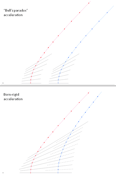

This is the same setup as in Bell's infamous Spaceship Paradox. The way the ships are accelerated really does matter. Let's assume that the accelerations are such that according to the original inertial frame the speeds of the ships are always the same.

1) In the frame of the stations does the distance between the ships remain the same or does it contract?
Since the ships always have the same speed, the distance between them cannot change.
2) In the frame of the ships does the distance remain the same or does it expand?
From the view of a co-moving inertial frame (which constantly changes, since the ships accelerate) the distance between the ships grows larger.

That's not my understanding. What matters in that scenario is the distance between the ships.
Is there some explanation for the assumption that in the ship frame the distance would increase given that; in that frame also, the expectation would be ; equal acceleration , equal instantaneous velocity , equivalent distance covered per time?
I would not agree with those expectations. Since the ship's view of simultaneity will be different than that of the station frame, the ships see themselves as not maintaining the same speed at all times.
The way I visualize this is by thinking in terms of small bursts of velocity change. At any given time, let's say that the ships are moving at a speed v with respect to the station. If another burst of speed is given to the ships, those bursts will be (by stipulation) simultaneous in the station frame but at different times in the ship frame.

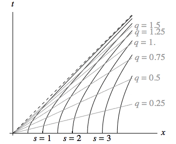

What do you mean by "the ship frame"? Unlike with inertial frames, there is no unique way to construct a coordinate system for an accelerating object. Also note that if the ship is accelerating at a constant rate from the perspective of some inertial observer, then it is not experiencing constant "proper acceleration" (constant proper acceleration meaning the G-force experienced on board the ship is constant, and the instantaneous rate of acceleration in the ship's own instantaneous inertial frame from one moment to the next is constant...this is also the type of acceleration that would be produced if the ship's thrust was constant in its own instantaneous inertial rest frame from one moment to the next). For ships undergoing constant proper acceleration, the most common choice of coordinate system for them would be Rindler coordinates, where the time coordinate along the ship's worldline matches its proper time, and the Rindler coordinate system's definition of simultaneity and distance always matches that of the ship's instantaneous inertial rest frame (I suppose you could also construct a coordinate system with these properties for a ship which was not undergoing constant proper acceleration). If you had two ships undergoing constant proper acceleration in such a way that their acceleration at any given time was the same from the perspective of a fixed inertial frame, then in each ship's own Rindler frame the other ship would not be at rest; in order for one ship to be at rest in another ship's Rindler frame, the ships must have different accelerations as seen in an inertial frame, and different proper accelerations too, with ships closer to the "Rindler horizon" accelerating more quickly--the two ships would then be undergoing Born rigid acceleration. This page on the Rindler horizon has a diagram and a little discussion:
We can imagine a flotilla of spaceships, each remaining at a fixed value of s by accelerating at 1/s. In principle, these ships could be physically connected together by ladders, allowing passengers to move between them. Although each ship would have a different proper acceleration, the spacing between them would remain constant as far as each of them was concerned.
JesseM said:
What do you mean by "the ship frame"? ). For ships undergoing constant proper acceleration, the most common choice of coordinate system for them would be Rindler coordinates, :
I meant the ship reference frame in its generic sense with no implication that it was an inertial frame.
I am somewhat familiar with the Rindler system and am studying it more right now.
I am curious about the genesis of this system with its included gravitational dilation.
Did this all originate with Born and the rigidity hypothesis?
Also the Theorem of anisotropic dilation within accerating systems due to relative velocity resulting from length contraction. I have searched the net without result so if you happen to know where ,when and who originated this it would be appreciated.

I don't understand what you mean by "in its generic sense". For any given non-inertial object, there are an infinity of distinct ways to construct a non-inertial coordinate system where it is at rest, with these coordinate systems disagreeing about things like simultaneity and distances. Again, you can probably get a unique system by adding the stipulation that 1) coordinate time along its worldline matches proper time, and 2) at any point on its worldline, the set of events that are defined to be simultaneous with that point are the same that would be simultaneous with that point in the object's instantaneous inertial frame at that moment, and distances in this plane of simultaneity would match the instantaneous inertial frame as well. I believe the Rindler coordinate system for an object undergoing uniform proper acceleration has both these properties.
What do you mean? There's no true gravitational time dilation in this system, although one can talk about pseudo-gravitational time dilation in a pseudo-gravitational field (see here).

=JesseM;2333518]I don't understand what you mean by "in its generic sense". For any given non-inertial object, there are an infinity of distinct ways to construct a non-inertial coordinate system where it is at rest,
That is exactly what I meant by in its generic sense. Without any specific coordinate definitions but merely as a perspective with it being at rest.
I got that from DrGreg in a discussion including Rindler coordinates. I was referring to it as "a non-uniform time metric" and he suggested it would be more conventional if I used "gravitaional time dilation" also specifically stating that SR didnt make a distinction between pseudo-gravitational and true gravitational.
But then there can be no definite answer to questions like whether the distance between two accelerating ships remains constant in their own rest frame; it will depend on how you define the rest frame.

There's no meaningful difference between considering a pair of ships undergoing Born rigid acceleration and considering the front and back of a single ship undergoing Born rigid acceleration.

Again, unless you say how the two ships accelerate the question is not well-defined. If you assume they both have the same constant proper acceleration, then sure, they will both find the same proper time elapses between the start and passing the 100th, and the time elapsed in an inertial frame observing them will be the same too. But if you want them to be undergoing Born rigid acceleration so a taut string between the two ships wouldn't break or become slack as they accelerate, then one ship will have a greater proper acceleration than the other, and in this case the proper time will presumably be different.
Austin0 said:
This is purely a matter of logic and known physics. They have the same acceleration ,same instantaneous thrust , as determined by the identicallity of their mechanisms of propulsion.
OK, you didn't specify that before. In this case the times will be the same.

I think you're confusing the concept of "proper acceleration" with "Born rigid acceleration". Every accelerating object has some value for its proper acceleration at a given moment, which again is defined just as the acceleration in its instantaneous inertial rest frame at that moment. But ships (or ends of a single ship) which are at rest in the same Rindler coordinate system are undergoing Born rigid acceleration, which means each ship individually has a constant proper acceleration, but the proper acceleration of the one at the rear is greater than the proper acceleration of the one at the front (the G-force experienced on the one at the rear would be higher than the G-force experienced on the one at the front).
Austin0 said:
So for the moment, if you could consider this question solely within the given parameters , with no reference to how things appear in the station frame or whether the acceleration is proper or not, what does your logic predict would be the outcome of the events?
Assuming you mean "whether the acceleration is Born rigid or not", the answer is that it's impossible to answer the question without saying something about the acceleration. But you earlier said both ships used the same thrust--do you understand that this automatically implies that the acceleration is not Born rigid, and that it implies both ships must experience the same proper acceleration? In this case, as I said, the times will be identical for both ships. But this also implies the distance between the ships in their own instantaneous inertial rest frames is changing from one moment to the next, so a string between them which was initially taut would break as in the spaceship paradox[/url].

Austin0, maybe the attached spacetime diagrams may help.
The top diagram shows what happens in your scenario. The red and blue lines represent two spaceships. The dots along each line are ticks at one-second intervals (say) of each ship's own clock. As both ships accelerate in the same way, for each ship after [itex]\tau[/itex] ticks have passed the velocity of each must be the same relative to the initial inertial frame. The distance between the ships as measured in the initial frame remains constant; it's the horizontal separation in the diagram. But in each ship's own frame (if we assume for the sake of argument that we use co-moving inertial observers to define the frame) the separation must increase, so that the Lorentz-contracted distance in the initial frame can be constant. The grey lines in the diagram are the lines of simultaneity for each of the ships.
For contrast, the bottom diagram shows two ships accelerating under Born-rigid acceleration, so that the distance between ships is constant in the ship's own Rindler frame, and the back ship is accelerating more than the front ship. The distance between the ships contracts in the original inertial frame.
(For what it's worth, the red and blue lines aren't just sketched, they're plotted accurately using Excel.)
Hi DrGreg Thanks for the drawings ,,I 've got to get a copy of EXCEL
It appears from the drawing of the equal acceleration system that the lines of simultaneity are parallel at any given time. Would this imply normal simultaneity in the system?
In fact it looks like a picture of an inertial frame that is simply getting faster over time.
The only problem with the picture is that the distance between does not diminish comparably.
On the Born ships I can't place any comprehensible interpretation on the lines of simultaneity at all.
Thanks

#1 What is the significance of his simultaneity wrt the initial frame? Both ships are now traveling at relative velocity wrt that frame and all that is important is the relationship between the two ships at this point in time.
The significance is that we already know that the two ships will reach the 100th station simultaneously in the initial frame, so this tells us that if we are interested in what happens in the instantaneous co-moving frame at the moment the lead ship passes the 100th station, it must be true that the back ship has not yet passed its own 100th station in this frame. The initial frame is just being used as a tool to help figure out how things would look in the co-moving frame, since the Lorentz transformation tells us how one frame's surface of simultaneity looks tilted when graphed in another frame.
I am not following you here. Refering to DrGregs drawing of this situation posted earlier.
We agree that there is no difference between two separate ships and one extended ship, right??
Looking at his diagram for any given instant of the initial frames timeline:
How is the picture regarding lines of simultaneity any different from a similar picture of an inertial frame?
Doesn't it have the same slope relative to the worldline slope of that instantaneous velocity??
Originally Posted by Austin0
What is the basis for an assumption of loss of synchronization between the two ships?
Again, it's just based on drawing a spacetime diagram of the two ship's worldlines from the perspective of the inertial station frame, where we know how the surface of simultaneity for a ship's instantaneous co-moving inertial frame should look. Do you have any experience in drawing spacetime diagrams with multiple frames' surfaces of simultaneity? If not you really need to learn this stuff before getting into advanced discussions of acceleration. #2 And if so, are you disagreeing that under conditions of thrust the two ships will reach their 100th station simultaneously in the station rest frame (if so then you really need to familiarize yourself with the equations on the relativistic rocket page), or are you #3 disagreeing that the fact that if they reach the 100th stations simultaneously in the station frame this implies that the rear ship has not yet reached its 100th station in the instantaneous co-moving inertial frame of the front ship as it is passing its own 100th station?

  • #34
Austin0:
I do agree with you that there are plenty of complexities in how to handle accelerated objects in relativity--but the scenario I've been discussing doesn't address them. For example: it does not address Born rigidity or Born acceleration; it does not address the complexities involved with Rindler coordinates or Rindler observers, or what happens to the speed of light in accelerated frames; it does not address any of the actual physics of how objects respond to stresses, such as the stresses imposed by acceleration. All of that stuff is irrelevant in this particular scenario, because those complexities involve how we determine the worldlines of the observers we're interested in, and in the above scenario, we've already specified those worldlines (they're specified by the condition that both observers experience the same constant proper acceleration, but are separated in space, in the station frame, by one "station separation"). And once you've done that, in any frame, in Minkowski spacetime, you have already implicitly answered every question that can be asked about how any observer would observe events on those worldlines.
I'm not unwilling to discuss all the other complexities; I'm just not ready to discuss them until we have agreement on the simple scenario I specified above, and in particular on the proposition that we currently don't seem to agree on. The simple scenario involves nothing except relativistic kinematics, and without agreement on that, the complexities will never fall into place.
Let me briefly restate the scenario: we have a line of stations, numbered 1, 2, 3, etc., and we have two observers, R and F, who start out at adjacent stations (#1 and #2) and both experience the same constant proper acceleration. Define Rn as the event at which R passes station #n (n >= 1), and Fn as the event at which F passes station #n (n >= 2). We are discussing the proposition:
* In R's frame, or in F's frame, events Rn and Fn+1 are *not* simultaneous, for all n > 1. (They *are* simultaneous for n = 1--i.e., R1 and F2 are simultaneous--because those events happen at t = 0, when R and F are at rest in the station frame. But this is the *only* such pair for which that is true.)
This proposition is the one we seem to disagree about. You said:
Well you seem quite sure but I don't get how you jumped from the simple assumption of an MCIF to events not being simultaneous.
I'll explain how in a moment.
That multiple lines of simultaneity for disparate locations in a frame are simply different segments of a single continuous line which is actually congruent with the x' axis.
This is *not* correct. Distinct lines of simultaneity indicate distinct, different clock readings. Consider the two lines of simultaneity we've been talking about, which I'll define names for as follows:
S-Rn: R's line of simultaneity through event Rn, with n > 1.
S-Fn+1: F's line of simultaneity through event Fn+1, with n > 1.
These two lines of simultaneity are parallel--they have the same slope--but they are not the same line. You appear to agree on that. But that means that, in either R's MCIF or F's MCIF, the clock readings associated with S-Rn and S-Fn+1 are *different*. They have to be, because they intersect the t-prime axis (the "time" axis of either MCIF) at different events. If we did a Lorentz transformation into either R's MCIF at Rn (making Rn the new origin), or F's MCIF at Fn+1 (making Fn+1 the new origin), only one of the two lines of simultaneity, S-Rn (for R's MCIF) or S-Fn+1 (for F's MCIF), would coincide with the new x-axis; the other would *not*. It would be parallel to the new x-axis, yes (indicating that it was a line of constant time, as expected), but it would be either *above* the new x-axis (if we transformed into F's MCIF at Fn+1) or *below* the new x-axis (if we transformed into R's MCIF at Rn).
So, by the above, the events Rn and Fn+1, with n > 1, *cannot* be simultaneous in R's or F's MCIF, because in either MCIF they lie on different lines of constant time, and will be assigned different time coordinates. Therefore, by the clock postulate, they can't be simultaneous in R's or F's accelerated frame either.
You observed that I haven't yet described how things look from the accelerated frame; that's true. But I don't need to in order to prove that events Rn and Fn+1, n > 1, can't be simultaneous in that frame (for either R or F). And if we're not in agreement on that proposition, any description I give of how the accelerated frame looks will seem wrong to you, because I'll be basing it on the truth of that proposition. I have no choice, because the proposition I've stated, as I've said, is a logical consequence of relativistic kinematics, so it has to figure in any description of how things look from an accelerated frame.
