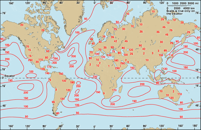

http://www.britannica.com/EBchecked/topic-art/121560/46275/Global-distribution-of-mean-annual-evaporation :
According to the caption that's in centimeters per year. Obviously the order of magnitude of the evaporation is about one meter per year, which we could use as a tentative working unit. How does this translate to watt/m2, the usual unit for the radiation energy?
One meter of water per square meter per year is obviously 1,000,000 ml per 31,536,000 seconds or 0,032 ml/sec.
The latent heat (Lc), or energy needed to evaporate one gram (is one ml) of water is about http://www.usatoday.com/weather/wlatent.htm.
So the evaporation energy of one meter water per year is 2500*0.032 = 80 w/m2. Not a value to neglect and nobody does that but it would be interesting to see what the delta evaporation would have to be if the temperature increases 1 or 2 or 4 degrees or something like that, to maintain the assumed constant relative humidity.

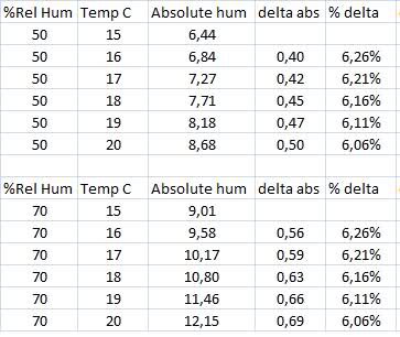

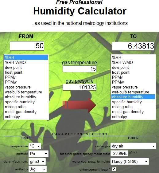

Using the http://www.humidity-calculator.com/index.php I used these settings:
using 50% RH in the "FROM" cell and 70% respectively for the two series, setting the "gas temperature" in the center from 15-20 degrees and noting the absolute humidity output in the "TO" cell in g/m3.
This is the result:
This shows that for every degree temperature increase, there must be some 6% more water vapor per unit of volume to maintain relative humidity, in usual climate temperature ranges.

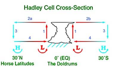

Now let's have yet another look at the http://www.meteohistory.org/2006historyofmeteorology3/2persson_hadley.pdf from north to south as depicted in principle here:
This is a big conveyer belt comprising from 30N to 30 about half of the Earth surface and getting about 60% of the solar radiation when looking at the basic black body model.
The circulation cell picks up moisture at leg#4 in the tradewinds when moving to the equator. The convection takes place at leg#1, where the air expands, cools adiabatically and loses much moisture again. Then close to the tropopause and hence at very low temperatures (and hence very low absolute humidities) the air moves out from the equator again and at leg #3 it descends, heats up adiabatically and since there is no moisture source aloft, it becomes very dry (low relative humidity), the desert lattitudes.
So if this is in equilibrium, what would happen if we would increase the surface temperature with one degree celsius due to greenhouse effect and we would also want to increase the (average) absolute moisture of all the air with 6% average to maintain roughly the same relative humidity?
What would happen to the rate of the Hadley cell conveyer belt? And what would happen to the rate of evaporation at leg 4?
Another premisse is that in leg #2a/2b, the closest to the tropopause, the increased greenhouse effect is not warming but cooling, as both modeled and observed, due to an increased out radiation of IR. That means that the absolute humidity at the tropopause would not tend to increase, hence the absolute humidity at the transition between legs #3 and #4 the absolutely humidity did not change either. So it looks that evaporation at leg #4 has to increase to make that 6% overal, assuming that the circulation rate of the hadley cell does not change.
So we have a lot of variables here and as Vanesch contends, it all depends if the convection cells speed up or slow down due to increased greenhouse effect.
If it slows down, the air at leg #4 stays in contact with the water for a longer time and will take up more water vapor, this could satisfy the requirement for maintaining relative humidity at higher temperatures.
If the pace of the hadley cell would be unchanged then it would seem logical that enroute on leg #4 the air has to pick up more water vapor with increased greenhouse effect. It would seem logical that a limit for that effect would be 6% per degree surface warming as calculated earlier, but the higher levels at lower temperatures would require less absolute humidity to maintain relatice humidity. So it would be an educated guess how much that would be, but certainly not zero.
The hadley cell however, has two engines in the vertical legs #1 and #3 its power determined by the density differences (bouyancy) of the air in the column in relation to the environment.
Leg #1 is even a two stage engine, as the light most air rises it cools dry adiabatically first. It can only keep rising when this cooling does not make the air colder as the environment (lapse rate). However when the dew point temperature is reached, the condensing water vapor releases its latent heat and the adiabatic cooling is significantly less now, the second stage. This is keeping the temperature of the air above ambient temperature more easily so the air keeps rising much more easily.
The other engine, the subsidence in leg #3 is again dependent on the cooling aloft due to out radiation and the surface temperature.
So what is the greenhouse effect on this engine, with warmer and moister surface air at the leg #1 to #4 transition? Obviously it is lighter now at a higher temperature, due to the greenhouse effect but so is the environment. The additional water vapor however with a lower molecular weight makes it a tad lighter -buoyant- than the ambient air, so it appears that there is no reason to assume that the initial convection is slower now. However with a higher absolute humidity, the dew point will be reached earlier at a higher temperature and the second stage engine, -the moist adiabatic cooling- will ignite earlier. Hence there are reasons to assume that the convection engine under more greenhouse effect with constant relative humidity would be getting stronger.
Next as the tropopause under more greenhouse cools more, the air aloft is getting more dense and would tend to subsidize more rapidly also adding more power to the Hadley cell.
But if the Hadley cell circulation rate increases under more greenhouse effect, the contact time between ocean and air is shorter and more evaporation would need to take place to satisfy the constant relative humidity assumption.

the overall convection of the Earth is due to the average pressure at the equator and he average pressure farther north. thunderstorms are of course low pressure areas. the pressure under a storm depends on the weight of air above it. if the air carries more water vapor then more latent heat is released and therefore the lighter the air becomes. (and I would guess the higher the air can rise before running out of 'steam'). the result is lower pressure and more convection. the most significant thing to my thinking is the surprising effect temperature has on the amount of water vapor the air can carry. for every 20 degrees Celsius increase the amount of water vapor it can carry doubles. that's a lot. so even a modest increase in temperature should result in much more convection and therefore much more cooling. Earth's temperature should therefore be, in a larger sense, relatively stable.
