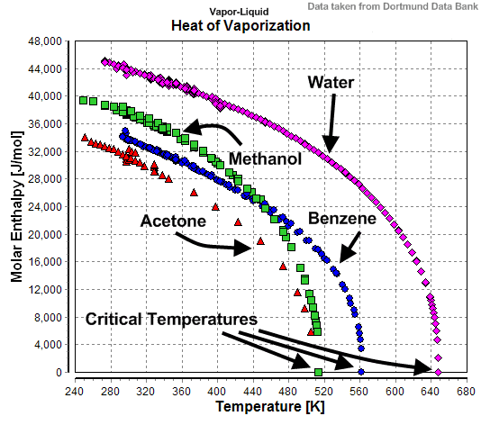

When you raise the temperature you also reduce the heat of evaporation. So your calculation for energy required to vaporize water needs to be constantly adjusted downward as SST increases.
  • #55
Very true,
roughly in the order of magnitude of one promille per degrees, I'd say, judging from that slope at the left hand. But the point indeed is with countering effects, quantititive judgement is difficult.
