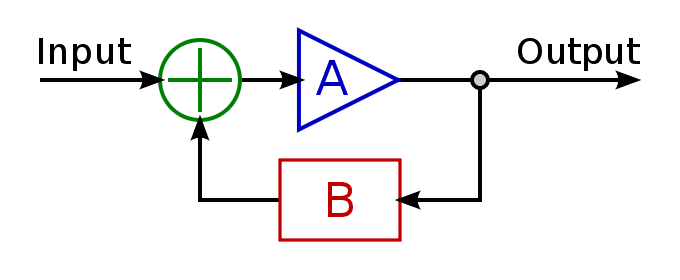

Just to recall what "feedback" is: it is, as Sylas said, an "artificial" way of chopping up the system response of a system, where one has defined an external input signal, and where one is looking at an "output" signal. What actually counts is the input-output relationship.
But sometimes the physical construction of the system is such, that one can discern "subsystems" in it, of which we can define also "input" and "output" signals.
Now, if we discern two subsystems, one which has the same "input" and "output" signals as the overall system, but in which there is also another "backward" subsystem, which seems to take as "input" what we call "output" and which ADDS its output to the overall input, then we have a feedback system.
The wiki entry is rather good: http://en.wikipedia.org/wiki/Feedback
The "forward" subsystem is A, the "feedback" is B.
We have that: (X is external input, Y is output, X' is input to A)
Y = A X' (forward subsystem)
X" = B Y (feedback)
X' = X + X"
From which:
Y = A (X + B Y)
(1 - B) Y = A X
Y = {A / (1 - B)} X
EDIT: I made a silly mistake here !
it has to be:
(1 - A B) Y = A X

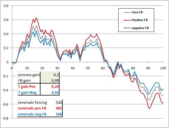

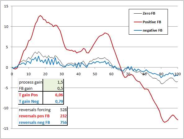

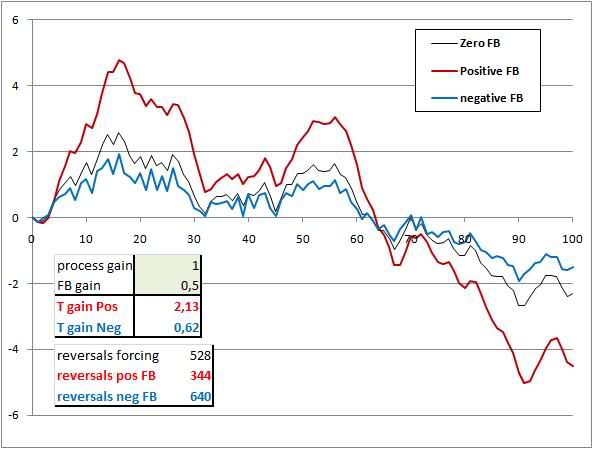

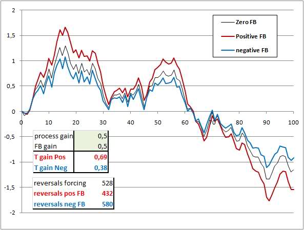

Thanks all for the patience and for pointing to the main principles of feedback, so I can take it from there. Vanesch shows how the total gain of a feedback process can be calculated in a steady state but in reality we are looking at constant dynamic transients, as the forcings functions of climate are constantly changing. The process reacts to that with the gain factor A, but with a certain delay, in climate ranging from minutes to centuries perhaps. Feedback uses (part) of the (delayed) output of a process as input and has it's own inertia and gain factor B.
To illustrate what happens when introducing a delay, I have made a very modest little model of the most simplest feedback that uses a step of one to simulate total delay from proces imput to the arrival of the feedback signal to be added or subtracted to the next system input (see attachment). I hoped to be able to use an older version I made a few years ago but I was out of luck so I had to make it again.
As input we use a one dimensional random walk (column C) and we compare the reaction in a zero feedback process (column D) with a gain A (cell C2) , a positive feedback process (column D) with the factor B (cell C3) and a negative feedback process with the factor -B in column F.
Let's look at a certain output, the first 100 steps, with A = 1 and B = 0.5 (green cells)
We see the average total gain for the feedbacks (in steady state pos:2, neg 0.67) are close (2.13 and 0.62). So that's fine. We also count the number of signal reverses for n=1000. The random walk makes 528 reverses (from a positive to a negative step or vice versa), which is close to the expected average of 0.5n = 500. But we see that the positve feedback process makes less reverses (344) and the negative feedback makes more reverses (640). This is obvious and important, as the added previous positive feedback steps tends to increase the deviation from to zero persistently (instable), whereas the negative feedbacks tends to pull the process back to the zero mark (stable) anti-persistent. Because of that we also see that the red positive feedback process is smoother and the negative feedback process is more jerky.
Before the all revealing playing with the parameters it's maybe better to see if we didn't lose everybody/anybody. Still here?

Very well explained, thank you.

We have been looking at proces gain A = 1 and feedback gain B = 0.5 giving this,
and we see that positive feedback can change the original signal considerably
Now if we increase the process gain for instance to A = 1.5, the positive feedback (B=0.5) grows to dominant proportions:
We notice also that persistency, or reluctance to reverse, has increased considerably
The reason obviously is that the process gain is bigger than one, hence the amplification can put more energy in the system. However there is no energy source available in climate other than the solar input, that means that attenuation requires that both process gain A and feedback gain B are smaller than one. Sometimes maybe close to one, if the process converts nearly all input energy to the same output energy and dito for the feedback. It can also be much smaller than one if the output is diverted in several other forms and dito of course if feedback is partly positive and partly negative.
So this is median result with both gains A and B on 0.5:
We see the role of positive feedback has been reduced considerably, the total practical gain being only 0.69. Now to see which is dominant A or B, We look at a gain A = 0.2 and B = 0.99 to get this:
Obviously, despite the 'strong' positive feedback factor, the attinuation of A has reduced the effect of feedback considerably and if we reduce the feedback gain B to a 'normal' 0.5, there is not a lot that any feedback does anymore:
It appears that the process gain A as amplification or attenuation determines whether or not the feedback has a big effect. I expect that in climate the factor A is usually not too large. If my ramblings are vaguely into the right direction, maybe that the effects of feedback in attenuated processes are not too dominant, but we would have needed quite some strong feedback to increase the climate sensitivity (Planck response) of about one degrees to about double values or more in attenuated processes.
But there is more, the persistency and antipersistency characteristics of the output signal, can we do something with that? That's for tomorrow.
In that case (as is usual in control theory btw) A and B don't stand for static amplification factors that work instantaneously, but rather for operators working on the entire function. You can switch to the Laplace domain, where A and B then stand for transfer functions, if the systems A and B are linear systems.
However, in the "long times" limit, they reduce to the static responses (technically, in the Laplace domain, we take the limit s -> 0 which gives you the long time static limit of a transfer function).
vanesch said:
From which:
Y = A (X + B Y)
(1 - B) Y = A X
Y = {A / (1 - B)} X
:blushing:
I made a terrible, elementary error !
Y = A ( X + B Y)
(1 - A B) Y = A X
so Y = { A / ( 1 - A B) } X

Yes. I wanted to respond to this, because the explanation is straight forward, and wanted to quote my earlier post, when I realized I made that error there.
Indeed, the overall static gain is A / (1 - AB ) (and not A / (1 - B) as I had erroneously written).
One calls sometimes AB the "loop gain" as it is the effect of a single succession of A and B.
It is the total loop gain that determines the feedback gain.
The "amplification due to feedback" is given by the factor (1/(1-AB))
You get strong feedback if AB is close to 1. If you lower A, you get less feedback amplification.

if the process gain is 1, and the FB is 0.5, we get an amplification due to feedback of 1/(1-0.5) = 2 ; the system has an overall gain of 2.
if A = 1.5 and B = 0.5, we have 1 / (1-1.5*0.5) = 4, so twice as much amplification of the feedback (on top of the fact that A itself is now larger, so the system has an overall gain of 6)
if A = 0.5 and B = 0.5 we have a feedback gain of 1/(1 - 0.25) = 1.33 and a total gain of 0.5 x 1.33 or 0.67.
If A = 0.2 and B = 0.99 (say, 1), we have a feedback gain of 1/(1 - 0.2) = 1.25 and an overall gain of 0.2 x 1.25 = 0.25.
That's pretty close to the numbers you had found in your simulation, for the positive feedbacks.
Same goes for the negative feedbacks (although now the formula is of course A / (1 + AB) )
Try it out, I'm pretty sure it works out fine.

Thanks Vanesch, with that correction the total gain in the different simulation attempts dovetail nicely. So my orginal assessment about transient effects was rather overstated.
Again, the objective of these little demonstrations, were, firstly, showing that significant 'amplification' in attenuated - non-amplified processes, like climate, are unlikely, especially when the total feedback is a combination of positive and negative feedbacks. Hence one could sincerely wonder if the modeled climate feedback claims, so abundantly supplied by Xnn, are either the result of actually modelling the different feedback loops in detail or just dialing in guestimated parameters. This would be an especially valid question about the assessment of IPCC of the positive feedback amplification of the climate sensitivity of doubling CO2 from the Planck response of 1.1 to 1.2 degrees to some 2 -4.5 degrees and this little exercise was to substantiate that doubt.
Secondly, we have introduced persistency and anti-persistency as characteristics of positive and negative feedback response, the tendency to persist in or oppose to the direction of the process output in relation to the average value. And the question arises if it is possible to assess the type of effective feedback of a process on this feature alone. Of course this is rather complex, one has to deal with attractors, autocorrelation, cyclic forcings like diurnal and seasonal cycles, etc. but especially the typical time constant of the different feedbacks. So signal behavior has to be analyzed on many different time scales to assess persistency. Also, for statistical significance, a large sample is required. http://www.aai.ee/~olavi/ has addressed this issue and his researches of many different climate data series all end in the conclusion: anti persistency.
