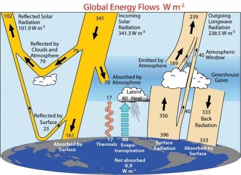

This is a measure of the latent heat energy flux. Your calculation of this is close, but it is using figures for the ocean only; neglecting evaporation over the land. This makes your result a little too small.
Basically, energy moves up from the surface of the Earth into the atmosphere by three means. Latent heat, convection, and radiation. There is also radiation coming back down from the atmosphere, but we can simply consider the difference between the upwards and downwards flux as the part of the energy moving up from the surface due to radiation.
There has been a fair bit of work on obtaining the various energy fluxes. A major reference is
  • Trenberth, K.E., Fasullo, J.T., and Kiehl, J. (2009) http://ams.allenpress.com/archive/1520-0477/90/3/pdf/i1520-0477-90-3-311.pdf , in Bulletin of the AMS, Vol 90, pp 311-323.
The work is summarized with this diagram:
Trenberth et al cites a number of estimates, and the diagram corresponds to 2.76 mm day−1. The surface area of the Earth is 5.1*108 km3. Hence this is using
2.76 *10-6 * 365 * 5.1*108 km3/year = 5.14*105 km3 per year​
close to Andre's 4.4*105. The difference is the evaporation over the land.
The more serious error is to describe this as feedback, as was explained many times in the other thread.
Consider what happens if we have a temperature rise, for any reason, in the above diagram. The immediate effect is an increase in radiation from the surface. The atmosphere adjusts rapidly to maintain the same lapse rate, so convection remains about the same; and there will be an increase in backradiation from the warmer atmosphere. This is all part of what is normally called the "non-feedback response", which we discussed in the thread already. It is the changes that arise only from temperature change, of the surface and of the atmosphere.
Now consider the knock on changes, which may be part of feedback loops. One effect will be a change in surface cover. Ice melting is the most obvious, but there can be other kinds of effects as well, as vegetation or land cover changes. The ice effect is a significant positive feedback; vegetation cover changes have less dramatic effects but over larger areas; it can be both positive and negative; but overall the surface cover effects are a positive feedback.
More significant, however, is the increased evaporation. This will increase latent heat flux by a small amount, which gives a more effecient transport of heat into the atmosphere. What Andre is missing -- and what he continuously missed in the previous thread as well, is that convection adjusts very rapidly to maintain the lapse rate. So if latent heat effects transport energy more effectively, convection will reduce to compensate. That is why you never find this described as a feedback in any actual scientific literature -- which, I might add, is a requirement for controversial ideas in this forum.
What is a genuine feedback, however, is at least three fold. The increased evaporation corresponds to increased specific humidity... more water in the atmosphere. This leads to:
  • More greenhouse effect. Water is a very strong greenhouse gas, and this is a positive feedback.
  • Less lapse rate. The moist lapse rate is weaker than a dry lapse rate, and a weaker lapse rate means that the upper atmosphere is warmer; and hence more effective at radiating into space. This is a negative feedback. The combination of lapse rate feedback and humidity feedback is much better constrained than either one individually; the errors tend to cancel. The humidity effect is significantly stronger; so overall this is positive feedback.
  • Cloud changes. This one is the hardest to sort out. Cloud can be both a positive and a negative feedback, depending on the nature of the cloud. They are very good reflectors (negative feedback) and also very good greenhouse absorbers (positive feedback). We experience both these effects all the time. In daylight, a cloud shades you and cools. At night, a cloudy sky is invariably much warmer than a clear sky; this is basically a greenhouse effect. There's a lot of work sorting this out, and the effects vary from region to region.
Cheers -- sylas

Andre;
I think the best thing to do is to look at the diagram that Sylas posted in message 61.
The evapotranspiration value is the same at the surface as it is in the clouds.
Notice it is a flow of energy within the system.
Now look at what is flowing into the system: 341.3 Wm^2
And what is flowing out at the top of the atmospher: 101.9+238.5 = 340.4 Wm^2
The difference is 0.9 Wm^2. This is global warming.
The 80 or 78 or whatever evapotranspiration itself does not affect the difference between the inputs and outputs at the top of the atmosphere.
  • #69
Another way to look at Sylas's diagram:
The 341 Wm^2 incoming is solar irradiance
The 102 Wm^2 is a function of albedo
The 239 Wm^2 is a function of emissitivity
The thermals, evapotranspiration and surface radiation may look like feedbacks, but they aren't. Instead they are more like eddy currents.
A feedback would have to be something that affects either albedo or emissitivity.
