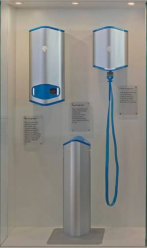

Edit: looks like coiled cable is the proposed answer.
Couple examples:
Those look a bit 'design concept'
There is already a couple of proposed standards, Europe and Japan look like they are all going to agree on the Merc system.
The US could go with a different plug because people don't often drive into America from another country (except Canada which doesn't count ;-)
thanks for the photos, mheslep
I don't see why the concept has the cable provided by the driver... I can see people unplugging the car end, go inside to pay or get a coke, and drive off leaving the cable behind. If I pulled into a gas station and found a just a hose fitting on the pump, I'd be pretty surprised ('what do you mean, you didn' bring your hose...'
