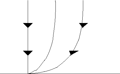

The world lines of the dust particles are the integral curves of our timelike unit vector field [itex]\vec{e}_1[/itex], namely
[tex]
x = x_0 \, (t/t_0)^{2/3}, \;
y = y_0 \, (t/t_0)^{2/3}, \;
z = z_0 \, (t/t_0)^{2/3}
[/tex]
It is a good idea to draw some of them and to "decorate" them with some light cones (drawn to scale) at some events on these world lines. Note that the light cones appear to be sheared radially outwards, with (for a given time [itex]t=t_0[/itex], the shear being larger for larger radii [itex]\rho = \sqrt{x^2+y^2+z^2}[/itex]. (See sketch below.) Note too that the volume form is

Figure: Sketch of some world lines of dust particles and some light cones drawn to scale.

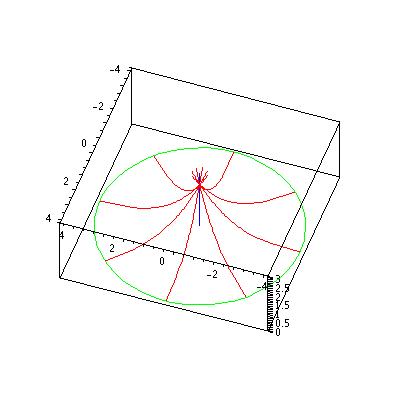

See the figure below and note that in our Painleve chart, these geodesics appear to "roll over", so that the boundary of the absolute past of the event in question looks like the surface of an onion. I stress again that in our chart, although the observer at [itex]x=y=z=0[/itex] appears to play a distinguished role, we know from the expansion and tidal tensors and the Killing flows that this is illusory--- in fact, each dust particle world line is equivalent in the geometry of our spacetime model to any other.
Figure: some null geodesics passing through an event on the world line [itex]x=0, \, y=0, \, z=0[/itex] (blue).

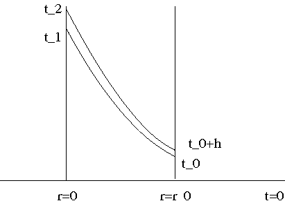

Now consider a second null geodesic from [itex](t,r)=(t_0+h,r_0)[/itex] through [itex](t,r) = (t_2,0)[/itex]; it is given by
[tex]
r_0 = 3 \, \left( t_2^{1/3} - (t_0+h)^{1/3} \right)
[/tex]
Combining,
[tex]
\frac{\lambda_{\rm rec}}{\lambda_{\rm em}}
= \lim_{h \rightarrow 0^+} \frac{t_2-t_1}{h}
= \left(1 + \frac{r_0}{3 \, t_0^{1/3}} \right)^2
= \left( 1 - \left( \frac{t_1}{t_0} \right)^{1/3} - 1 \right)^2
= \left( \frac{t_1}{t_0} \right)^{2/3}
[/tex]

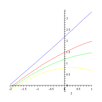

We can now define a number of notions of "distance in the large", which can be computed from the redshift, which is observable. Of course, our distance estimates depend upon our model, which is simpler than the ones actually used in contemporary cosmology. However, it is worth going through these computations in order to see how the process works in the context of the simplest reasonable cosmological model.
Probably the most natural notion of distance to a distant galaxy is the "lookback time" (sometimes called "light travel time", although of course the photons recognize no such quantity!)
[tex]
\Delta t
= t_1 - t_0
= t_1 \; \left(1 - (1+z)^{-3/2} \right)
= \frac{3 \, t_1}{2} \; \left( z - \frac{5}{4} \, z^2 \right) + O(z^3)
[/tex]
(called [itex]D_{\rm ltt}[/itex] in Wright, "A Cosmology Calculator for the World Wide Web"; see http://arxiv.org/abs/astro-ph/0609593). This is a coordinate time difference, which in our comoving chart corresponds to the elapsed proper time of any dust particle, so this notion of distance does make geometrical sense, and is physically not terribly unreasonable.
Another simple notion of "distance in the large" arises when we apply the current value of the scale factor [itex]a(t_1) = t_1^{2/3}[/itex] to the comoving coordinate radius [itex]r_0[/itex], which gives
[tex]
D_{\rm now}
= 3 \, t_1 \; \left( 1 - (1+z)^{-1/2} \right)
= \frac{3 \, t_1}{2} \; \left( z - \frac{3}{4} z^2 \right) + O(z^3)
[/tex]
which is slightly larger than the lookback time, but agrees with it approximately for modest values of z. Needless to say, we could just as well apply instead the factor [itex]a(t_0)[/itex], which gives
[tex]
D_{\rm then}
= D_{\rm now} \; \left( \frac{t_0}{t_1} \right)^{2/3}
= \frac{D_{\rm now}}{1+z}
= \frac{3 \, t_1}{2} \; \left( z - \frac{7}{4} z^2 \right) + O(z^3)
[/tex]
Or we could apply the scale factor at an intermediate time. Which scale factor is "best"? It depends, but if we extend the Hubble law using the current value of the scale factor to distant galaxies, the appropriate distance to use is [itex]D_{\rm now}[/itex] since (by definition!) this is the one for which the linear relation holds exactly. Geometrically, it is the proper distance measured along a spacelike geodesic segement lying in the hyperslice [itex]t=t_1[/itex] and running from the world line [itex]r=0[/itex] to the world line [itex]r=r_0[/itex], but while this makes perfect sense geometrically, this obviously does not correspond directly to an experiment we can carry out!
In models with E^3 hyperslices, such as the one we are studying, [itex]D_{\rm then} = D_A[/itex], the angular-size distance. (See figure below for a comparative graph.)

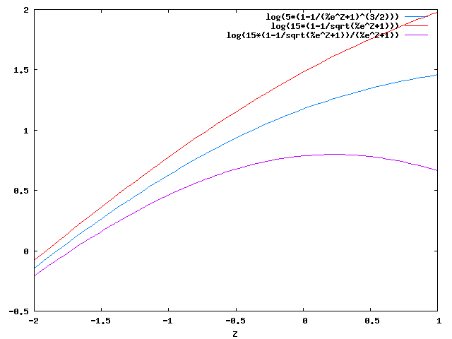

Another popular notion of distance often used in cosmology is the luminosity distance, which for models with E^3 hyperslices is related to the others by [itex]D_L = (1+z) \, D_{\rm now}[/itex]. (See figure below for a comparative graph.)
Figure: left to right:
  • Deriving the redshift factor
  • Some " distances in the large": a log-log plot with respect to z (computed using the rather silly value t_1 = 5):
    • [itex]D_{\rm L}[/itex] (blue)
    • [itex]D_{\rm now}[/itex] (red)
    • [itex]D_{\rm ltt}[/itex] (green)
    • [itex]D_{\rm A}[/itex] (yellow)

Notice that this is only defined inside the upper half cone with vertex at the origin, [itex]t>0, \, t < r[/itex]. The world lines of the Milne observers are the integral curves of [itex]\vec{e}_1[/itex], namely rays from the origin which lie inside this upper half cone. So the Milne observers are inertial observers. In terms of a cosmological model, we can consider them as model galaxies which obey a strict Hubble law, in which the Hubble constant is not only homogeneous on spatial hyperslices but not varying in time.
See the figure below, and notice that if an observer sends out a subluminal spaceprobe which moves at constant velocity, this will pass some Milne observers, but will never reach others. Notice too that because we are neglecting the mutual gravitational attraction of the galaxies, the expansion does not slow over time, as it does in the FRW dust with E^3 hyperslices.

Each of these charts provides a welcome (?) opportunity to practice finding generators for the Lie algebra of Killing vector fields (exceptionally rich---ten generators--- in the case of Minkowski vacuum) in various charts, and then using Noetherian magic to obtain a solution of the geodesic equations for timelike, null, and spacelike geodesics (a task which doesn't require knowing all ten generators). See https://www.physicsforums.com/showthread.php?t=380917 and also Post II above.
Figure:
Milne observers inside an upper half cone in Minkowski vacuum

Similarly
[tex]
D_{\rm then} = t_1 \; \frac{\log (1+z)}{1+z} = t_1 \; ( z - 3/2 \, z^2 ) + O(z^3)
[/tex]
See the figure below and note that the order relations between these distances are the same as we found in the FRW model:
[tex]
D_{\rm then} < D_{\rm ltt} < D_{\rm now}
[/tex]
suggesting that [itex]D_{\rm ltt}[/itex] offers a compromise, if you will, between [itex]D_{\rm now}, \; D_{\rm then}[/itex], which behave quite differently (in particular, as first noticed by none other than Karl Schwarzschild, [itex]D_{\rm then}[/itex] tends to "turn over" at large redshifts.
Because our hyperslices now have hyperbolic geometry, [itex]D_A[/itex] no longer agrees with [itex]D_{\rm then}[/itex], and [itex]D_L[/itex] no longer agrees with [itex](1+z) \, D_{\rm then}[/itex]. I'll defer discussion of these until I have created suitable figures.
The essential point here, I think, is that we require multiple distinct notions of "distance in the large" even in Minkowski spacetime, but the graphs also suggest that the effect of incorporating gravity into our model (by replacing the Milne model with the slightly more sophisticated FRW dust with E^3 hyperslices) is to exacerbate the effect of increasing redshift, and to emphasize the differences between the three notions of "distance in the large" compared here, when plotted against the observable quantity, the redshift z.
But there is one other important point to be made: the null geodesics we found for our comoving chart (comoving with the Milne observers) in Minkowski vacuum show that all the Milne observers are always visible to each other. This is not true, as we saw in Post, for the FRW dust with E^3 hyperslices, which features a cosmological horizon.
Figures: Log-log plots of [itex]D_{\rm now}, \; D_{\rm ltt}, \; D_{\rm then}[/itex] (red, blue, purple curves) wrt z for two models; left to right:
  • FRW dust with E^3 hyperslices
  • Milne model
Both plots use the silly example [itex]T_1 = 5[/itex]. Both plotted with Gnuplot.

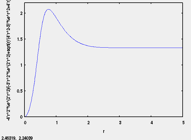

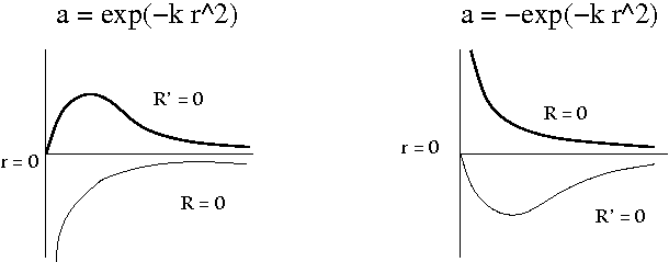

To make a perturbation model, we should allow a nonzero near r=0, but ensure that [itex]|a| \rightarrow 0[/itex] as [itex]r \rightarrow \infty[/itex]. Two particularly simple choices are the Gaussian perturbations [itex]a = \pm k \, \exp(-n \, r^2)[/itex] where k,n are positive real constants. Then you can check that
  • [itex]a=\exp(-r^2)[/itex] has Big Bang at [itex]R_r=0[/itex] (see the figure), so the hyperslices t=t0 are disconnected for sufficiently small t0. Furthermore, the proper time from a slice t=t0 back to the Big Bang (measured along the world line of some dust particle) varies with r. The density of the dust vanishes for all time at the center of spherical symmetry r=0, and for as r increases (with t held fixed t=t0), the density increases to a maximum, and then decreases to the (positive) FRW value from above. As t increases, the density profile homogeneizes, and the location of the peak density moves to larger values of r.
    We'd like to characterize this as a model in which we have an underdense region near r=0, but obviously such a claim requires more justification than I've yet offered. In particular, we should compare the slices t=t0 with slices of constant lookback time to the Big Bang, where we expect to see an unambiguous underdensity near r=0. Then we can explain the (surprising?) modest overdensity before approaching the FRW value (as r increases) by saying that, as r decreases, the slice t=t0 is "going back in time and approaching the Big Bang", and thus encountering larger densities, before the exponential decrease in density near r=0 wins the struggle and the density falls to zero at r=0 (measured along the slice t=t0).

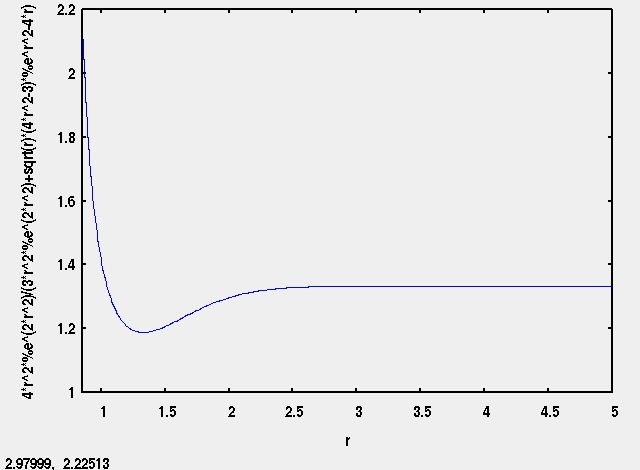

  • [itex]a=-\exp(-r^2)[/itex] has Big Bang at [itex]R=0[/itex] (see the figure), so that each hyperslice t=t0 has the Big Bang at r=r0, where r0>0 depends on t0. Once again, the proper time from t=t0 back to the Big Bang (measured along the world line of some dust particle) varies with r. As r decreases with t held fixed (t=t0), the density of the dust slowly falls from the FRW value to a minimum density, then rises steeply and blows up as we approach the Big Bang.
    We'd like to say that this represents an overdense region of dust near the origin; we should compare the slices t=t0 with slices of constant lookback time to the Big Bang, where we hope to see an unambiguous overdensity at near r=0. To encourage reader participation, I haven't yet tried to explain why this doesn't seem to correspond to the graphs as well as the previous case, suggesting that the proffered explanation may be incorrect.

  • location of the Big Bang (strong spacelike scalar curvature singularity) for two Gaussian perturbations (sketch),
  • density of dust versus r for t=1 when [itex]a = \exp(-r^2)[/itex]
  • density of dust versus r for t=1 when [itex]a = -\exp(-r^2)[/itex]
