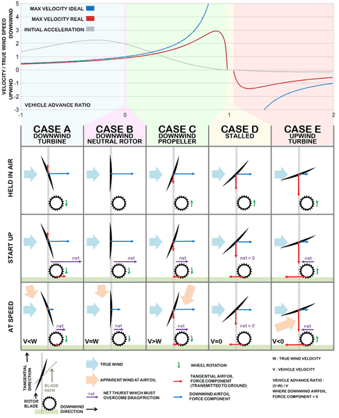

In summary: This is the part where I post the equations and simulation to show that it is possible to go faster than the wind with a propeller driven by the wheels.
yn3
There was and still is a hot debate on the matter of a wind power car that travels down the wind faster than the wind. As a part of larger interest in the subject I put the theory for this case, it can be found in my website
https://sites.google.com/site/yedidianeumeier/"
I welcome your comments

yn3 said:
To move with (down) the wind the car uses a propeller driven by the wheels, to move upwind one needs a wind turbine the shaft of which drives the wheels. How fast can this car go?
In terms of wind-speed-multiple there is no particular limit in either direction. It just depends on efficiency.
in terms speed relative to the air, there are practical limits related to the gas properties. I doubt the sound barrier could be broken.
in terms speed relative to the ground there the speed of light limit
yn3 said:
Now, what happens if you go in an angle to the wind? Is there an angle where the propeller is inefficient and the turbine likewise so that it is so to say a blind spot to the car, meaning an angle it cannot drive or is it a point of overlapping manning both propeller and turbine are effective,
The blind spot for faster than wind would be at 90°. But with cyclic pitch control propeller/turbine ranges would overlap.

Surprise surprise: That is if my calculations are true, and rest assure that I am and will double checking them for a while.
The propeller wind car can do extremely well in side winds. Assuming that the propeller shaft can be rotated sideways, (which is not possible in the current ThinAirDesigns car), a car that can do 3XW down the wind can do more than 4XW with 90 degrees wind, the propeller will be swayed about 70 degrees sideways to 20 degrees off the wind. Moreover, the calculations show that even with the fix front thrust propeller, the aforementioned car capable of 3XW down the wind will do still better than 2XW at 45 degrees to the wind. This part of my calculation should be able to be confirmed or rejected by the experience of ThiAirDesigns, I am sure that they took some runs with angle to the wind. mender what say you?

I have read a dozen of pages on this topic but I cannot understand it. Could someone please explain it or give a link to an explanation? Isn't it true that once you are up to wind speed and use the wheels start to power the propeller, the energy will come from the kinetic energy of the cart and since the propeller cannot propel air at 100% efficiency some energy will be lost and shouldn't the cart slow down? I simply don't understand how it works.

I can understand that the thrust has to be a portion of what it would have to be when there is no wind, but nevertheless, no matter how little thrust, it has to come from the kinetic energy of the moving cart, I would think. Then the propeller uses some of that energy to accelerate air particles in one direction which accelerates the cart in the other direction. Isn't it true that the propeller cannot accelerate air particles with more force than it is getting from the wheels? What am I missing?
You're forgetting that the thrust at the prop can be higher than the drag at the wheels but only because the ground is moving past the cart faster than the air. If there is no wind, the air is moving past the cart at the same speed.
The cart essentially gears down the force at the wheels and turns the prop slower than the ground speed but with more force against the air.
The drag at the wheels is x, the speed across the ground is v; since the prop is acting on the air, with no losses, the thrust from the prop can be 2x when it is turning at a rate to move the air back at half the ground speed (v/2). Same principle as a lever; the force at one end can be much greater than at the other but the distance is less.
Better?

If you use gears to make the propeller move faster than the wheels, it will displace more air but also drag the wheels more, because it does more work and needs more energy, if you make it spin slower it provides less acceleration but also causes less drag, at least the way I understand it.
But we use gears to slow down the propeller, displacing less air but supplying more force for the same amount of work taken from the wheels.
For the sake of clarity, let's take losses out of the picture for a moment.
The wind is blowing at 10 mph. The cart, without the propeller engaged, gets pushed up to 10 mph. The pitch of the prop and the gearing of the cart is set up to push air back relative to the cart at half the speed of the wheels. The prop is engaged; the air around the cart gets pushed back at 5 mph, half the speed of the wheels. Since the force at the wheels is geared down, the force at the prop is twice as much as the drag at the wheels and the cart accelerates. F=MA so if the net force acting on the cart is positive, as it is so far, the cart will accelerate.
The cart gets to 15 mph; the prop is now turning fast enough to push air back at 7.5 mph and the force at the prop is still higher than at the wheels, so the cart will still keep accelerating. About now you're thinking that if that is true,the cart will keep accelerating forever; it won't, because the gear ratio determines the top speed in accordance to the speed of the wind.When the cart gets to 20 mph, the prop is pushing air back at 10 mph and the wind is still blowing at 10 mph, meaning that the prop is no longer exerting any force on the air, it's just freewheeling. With this gear ratio, the absolute best the cart can travel across the ground is twice the speed of the wind.
Now the wind drops to 7.5 mph; what happens to the cart? At 20 mph, it is still pushing air back at 10 mph but with the wind at only 7.5 mph, that means that instead pushing air back, it is actually trying to drag air forward at 2.5 mph. The net force acting on the cart is now negative, so the only thing that can happen is that the cart will slow down. What speed does it stabilize at? Again, twice the speed of the wind, or 15 mph.
Gearing the wheel speed down by half (0.5) to power the propeller gives a theoretical top speed of twice the wind speed. A different ratio will give a different theoretical multiple of the wind speed. Gearing the cart down less means the prop is spinning faster but with less force; it has the potential to faster for the same wind speed but it needs to be more efficient because the prop is supplying less force than before to overcome the real world losses.

Here is where I still have a problem. Doesn't energy matter also? Yes we can use gears to multiply the force, but doesn't the energy stay the same? Eg isn't the energy you put into at one end the same what you get from the other end, no matter what gears you use between? Otherwise you could just connect some gears to a wheel and then connect it to another wheel and multiply the force. You could do that, but doesn't the energy stay the same?
To me it seems that it takes a certain amount of energy to make the propeller move the air and that energy can only come from the kinetic energy of the cart, no matter what gears you use. If you use gears to make the propeller slower, the force at the wheels is lower, but since they move more in the same time, don't they expend the same amount of energy as the propeller gets?

The air stream 'moves' the propeller more than the other way around. Or, in terms of energy, the propeller takes kinetic energy from the air stream and converts it to the kinetic energy of the platform.

chingel said:
Thank you for your explanations.
Yes, absolutely! That's what we've been talking about the whole time, the fact that the energy input from the wheels is used by the prop, and as such the energy output can never be more than the input. The force output certainly can, just like a lever and that's what we've also been talking about levers.
As mheslep pointed out, when the prop pushes air back relative to the cart it is reducing the speed of the air over the ground (reducing the kinetic energy of the wind) and using that energy to propel the cart (increasing the cart's kinetic energy). Since a real world cart is never 100% efficient, the cart will never reach the theoretical top speed but instead will travel at some percentage of it.
The Blackbird reached 3.5x the wind speed, which is 70% of its theoretical top speed of 5x wind speed; pretty impressive!
