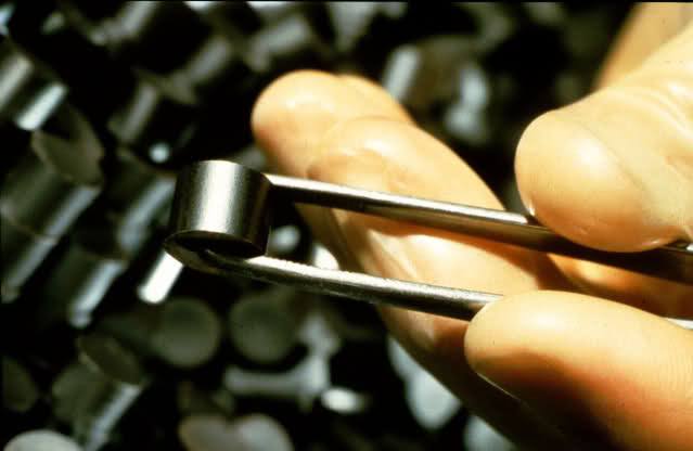

[edit] I suppose there is another possibility: they could steal the fuel and truck it into the nearest city along with a conventional bomb. That would require holding off the Marines for a few days, though, which is pretty unlikely.
Contrary to popular belief, nuclear fuel isn't actually that dangerous in the short term; direct exposure for several hours is hardly a concern. Uranium pellets can easily be handled without special equipment (gloves recommended, of course, to avoid heavy metal poisoning if you have cuts on your hands). But if you've ever seen a fuel production facility, not everyone wears a radiation suit. Here's an NRC image of a guy just handling a piece of fuel with tweezers, note the background:
Even the waste is not overly dangerous in the short term. True, you would not want spent fuel rods and control rods in your neighborhood, but again, the risk is small. Plutonium is the largest concern in this area since, even after being spent, it retains a high level of radioactivity.
As far as releasing radioactive dust into the air, you have much much more to worry about from coal and oil. Between the two of the, they release more radioactive material into the atmosphere each year than all of the nuclear power plant "disasters" combined (including Three Mile Island assuming the maximum theoretical release).
EDIT: sorry, can't find a source for that last one. Probably should exclude it from the conversation for now.
DOUBLE EDIT: This isn't a perfect source for the information above, but it corroborates the basic point: (http://findarticles.com/p/articles/mi_m1200/is_n14_v146/ai_16387382/)
