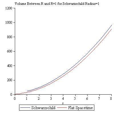

yuiop said:
Just out of curiosity, what is the name for the "distance" [itex]\Delta r = r2-r1[/itex] where r1 and r2 are Schwarzschild spatial radial coordinates?
As far as I know there is no name for this 'distance'. It really is no distance, in fact the R value relates to the curvature.
But we can get a proper distance by integrating between these r values:
[tex]
\Delta \rho = \int_{r_1}^{r_2} g(r) dr =
\int_{r_1}^{r_2} {1 \over \sqrt{1 - {r_s \over r}}} dr
[/tex]
That gives us:
[tex]
\Delta \rho = \sqrt {{\it r_2}\, \left( {\it r_2}-{\it r_s} \right) }-\sqrt {{\it r_1}\,
\left( {\it r_1}-{\it r_s} \right) }+{\it r_s}\,\ln \left( {\frac {
\sqrt {{\it r_2}}+\sqrt {{\it r_2}-{\it r_s}}}{\sqrt {{\it r_1}}+\sqrt {{
\it r_1}-{\it r_s}}}} \right)
[/tex]
We can also get the area and the volume. All three are finite all the way up to the Schwarzschild radius. In principle one can also calculate the proper distance from 0<R<=Rs.
Attached is a graph showing the difference in volume between increasing R and R+1 slices in a Schwarzschild metric of Rs=1 and flat spacetime. As you can see in the graph the volume is a bit higher in the Schwazschild metric, basically one can place more objects of a unit length into a Schwarzschild space compared to a flat space. It is a bit similar to being able to place more unit rulers along a rotating disk compared to a disk that does not rotate. Also you can see at R=1 it is all over for the Schwarzschild metric because R=1 is the Schwarzschild radius or also called the sphere that represents the event horizon.
Interesting questions to ponder:
- Can we find a relation between the increase of volume compared to flat space and energy?
- Is there a simple analytic formula describing the ratio between VSchwarzschild and VFlat?

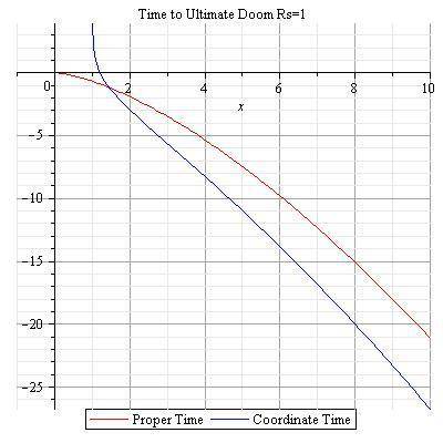

So we can take a small numerical example (I like examples, that way I can verify if I am not just talking 'philosophy'):
In A Schwarzschild solution where Rs = 1 consider Clock A: RA = 20 and Clock B removed a coordinate distance 1 from A at RB = 21, we assume radial motion.
The free fall from infinity does not pose a problem in terms of discovering proper time if we switch things around and consider proper time in terms of 'proper time till ultimate doom', e.g. the arrival at the singularity. See the attached graph for a comparison between proper and coordinate time. As you can see coordinate time never gets beyond Rs while proper time gets all the way to the singularity.
Using (MTW 25.38):
[tex]
-2/3\,{\it rs}\, \left( {\frac {r}{{\it rs}}} \right) ^{3/2}
[/tex]
We can also use coordinate time, but obviously we would never get to the singularity, by using:
[tex]
{\it rs}\, \left( -2/3\, \left( {\frac {r}{{\it rs}}} \right) ^{3/2}-2
\,\sqrt {{\frac {r}{{\it rs}}}}+\ln \left( \left( \sqrt {{\frac {r}{
{\it rs}}}}+1 \right) \left( \sqrt {{\frac {r}{{\it rs}}}}-1 \right)
^{-1} \right) \right)
[/tex]
The proper time to ultimate doom for both clocks is:
A: -59.62847939
B: -64.15605973
The number is negative because it is a 'time to' thing. So basically B has a longer life from our starting point than A.
Lets also check the proper distance between A and B at this starting point:
[tex]
\sqrt {{\it ro}\, \left( {\it ro}-{\it rs} \right) }-\sqrt {{\it ri}\,
\left( {\it ri}-{\it rs} \right) }+{\it rs}\,\ln \left( {\frac {
\sqrt {{\it ro}}+\sqrt {{\it ro}-{\it rs}}}{\sqrt {{\it ri}}+\sqrt {{
\it ri}-{\it rs}}}} \right)
[/tex]
Where ri is RA and ro is RB we get:
Proper distance Between A and B at RA: 1.025325886
In other words, we can place a rod of a proper distance of 1.025325886 between R and R+1 meaning that the lower the coordinate value the more 'extra room is provided for' in this spacetime.
Now let's see what happens after 20 seconds of proper time for RA.
We use:
-59.62847939 - 20 = -39.62847939
Now we have to solve going from proper time to an R value.
We use (MTW 25.39a):
[tex]
1.310370697\,\sqrt [3]{{\it rs}\,{\tau}^{2}}
[/tex]
So the answer is:
RA20: 15.23114122
Now how do we go from here, I present three options, we can move B in a ratio of proper time, we can keep the R differential fixed or we can keep the proper distance fixed:
First we use some ratio of proper time:
Let's use:
RATime/RBTime * 20 Seconds
-59.62847939 / -64.15605973 * 20 = 18.58857282
So let's 'run' B for 18.58857282 seconds
Then RB20: 16.71722640
Assuming all this is correct what can we conclude:
The initial coordinate distance between A and B was 1 and the initial proper distance between A and B was 1.025325886
After a time shift of 20 seconds for A and (we assume) 18.58857282 seconds for B we get:
The coordinate distance is now: 1.48608518 and the proper distance is now: 1.534943739
This would indicate that due to the tidal effect a proper distance of 1.025325886 becomes 1.534943739 over a proper time for A of 20 seconds and a proper time for B of 18.58857282 seconds.
Now let's consider what happens if we instead try to keep the R distance fixed between the two measurements:
Then B20 becomes: 15.23114122 + 1 = 16.23114122
And the proper distance becomes: 1.033396851
Now how would that relate back to elapsed proper time for B, assuming this motion is inertial?
Answer: 17.28894242 seconds
Finally we force the proper distance to stay fixed, then:
The coordinate value of B becomes:
B20: 20.59299168
However the proper time will change as B is not traveling inertially anymore.
So there are many approaches. But we need to find the right one.
