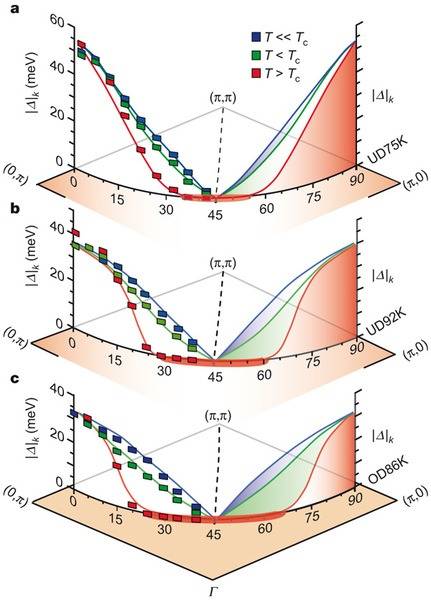

1. Conventional superconductor: 96% hole superconductors (Chapnik rule).
2. HTSC: hole doped Tc much greater than electron doped Tc
3. Phase diagram of Tc and % of doping: concave, superconductor in a limited region of doping.

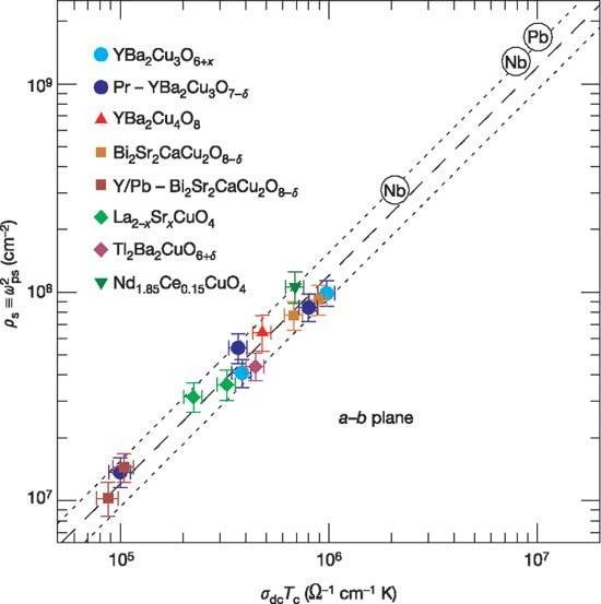

4. Homes scaling law:
Tc ~ const*(number of superconducting electrons)*(resistivity in normal state)

As we know Homes law is valid also for conventional superconductors.
http://www.nature.com/nature/journal/v430/n6999/full/nature02673.html

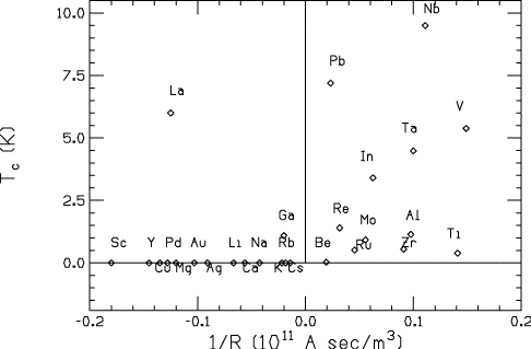

If it is true, why we can't discover another "MgB2" like superconductor (40K) and can't "calculate" empirical Chapnik and Homes's rules for coventional superconductors?
It is the illustration of Chapnic rule. The figure above shows a plot of the superconducting critical temperatures of the elements versus the inverse Hall coefficient. Note that superconductors are predominantly found among materials with positive Hall coefficient.

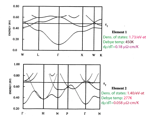

Why advice to search superconductor among materials with high TDebye is not working?
It is the illustration of Chapnik rule, Debye T and density of states. Element 2 is superconductor. Why?

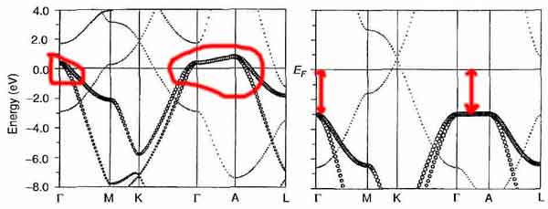

As for MgB2: below left picture MbB2, right picture graphite
Pictures from the book: Electronic structure: basic theory and practical methods / Richard M. Martin 2004, page 48
We see as Chapnik rule works with exellence (red circles) for MgB2 and we see how we can make graphite HTSC by doping.
