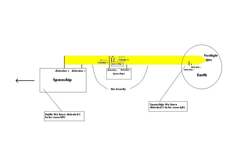

Please regard spaceship 2 and spaceship 3.
All this question is a asked only from the POV of spaceship 2!
Velocity x is different from velocity y.
If in some kind of transformation, spaceship 2 measures light speed detection at spaceship 3 as not being 300000kps, how come it measures by its own detectors, the speed of light as 300000kps? It is the same beam of light that spaceship 3 measures in between the detectors of spaceship 2! Shouldn't a transformation that measures anything but 300000kps for spaceship 3 as well, change the results of spaceship 2 detection itself?
You are having four different pairs of detectors traveling at different speeds "measure" the one-way speed of the same light beam and you're wondering why scientists say that they all come up with the same "measurement" of c? Correct? Is that your question?
The answer is that it is not possible to make a measurement of the one-way speed of light until you have previously defined the one-way speed of light. In Einstein's Special Relativity, that definition is c. So when you then make the "measurement", what do you get? Obviously, c.
Please disregard Earth and the big spaceship.
I am asking regarding posts that mentioned in some contexts that under a transformation, the speed of light is not necessarily 300000kps. Is it out of context regarding my question?
To get back to the original question, we have an FAQ about this in the FAQ section at the top of this very forum:
https://www.physicsforums.com/showthread.php?t=534862
OK, we'll just look at spaceship2 and spaceship3.
Neither one of those spaceships can measure the one-way speed of light until they independently define how long it takes for the light to traverse the distance from their individual detector1 to detector2. They can each individually measure the distance between their own two detectors using their own rulers, correct? Of course, the way you've drawn it, spaceship2 will measure a much greater distance than spaceship3, correct? But that won't matter because spaceship2 will measure a greater time interval and so the calculation when they each divide the distance by the time interval will come out the same, correct?
Now in order for each spaceship to measure how long it takes for the light to traverse from the first detector to the second detector, they have to send signals from both detectors to a timer that starts when the light gets to detector1 and stops when the light gets to detector2. They could place this timer anywhere and it shouldn't make any difference, correct? Well let's just say they put the timer next to detector2 and they will send a signal from detector1 to the timer to start the timer. So let's say they run a cable from detector 1 to the timer and let's say that the electrical signal travels in the cable at the speed of light. They also have a very short cable from detector2 to the timer to stop it.
Now they start the experiment. The flashlight comes on and some unknown time later the light hits detector1 which sends an electrical signal down the cable at the speed of light to the timer. But this signal is tracking right along with the light coming from the flashlight so the signal starts the timer at the exact same time that detector2 tells the timer to stop so the measured time interval is zero and they calculate the speed of light to be some distance divided by zero which is infinite.
Well that doesn't seem right so you rearrange the experiment and put the timer next to detector1 with the short cable and use the long cable from detector2 to bring the stop signal back to the timer. Now when you do the experiment, it will take however long the round-trip measurement of the speed of light would take for the measured time interval and so you get an answer that is presummably half what it should be.
Do you see the problem? Depending on how you set up your experiment you will get an answer for the measured one-way speed of light that is somewhere between c/2 and infinity.
There is no way to avoid or resolve this problem base purely on measurement. You might say that you should put the timer half way between the two detectors and make sure the cables are equal length but now you are merely claiming that the one-way speed of light is equal to the two-way speed of light but you haven't actually measured it.
So what Einstein proposed is that each spaceship puts the timer half way between their own two detectors and that will be the agreed upon definition of the one-way speed of light but separately for each spaceship.
You ask about transformation. What that boils down to is if spaceship2 uses his definition for the one-way speed of light to measure what happens on spaceship3, he will determine that spaceship3's measurement of the one-way speed of light is incorrect but rather is somewhere else between c/2 and infinity. The same is true for spaceship3 using his definition of the one-way speed of light to determine spaceship2's measurement.
There will never be any problem as long as you use one definition for all measurements on all spaceships. And it can be any consistent definition, even one where there is no spaceship. What we are really talking about here is the definition of a Frame of Reference which applies to all objects in the scenario. You can then use the Lorentz Transform to switch to a different definition (a different Frame of Reference) and apply that new definition to all the same spaceships or objects that you had in the first FoR.
I think that I understand your explanation.
Thanks.

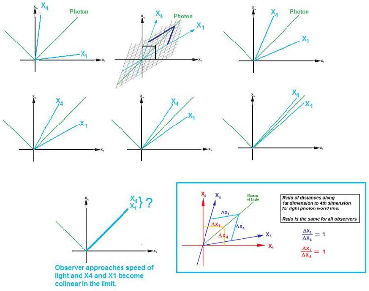

catalyst0435, there is a more fundamental reason for this. However, to grasp the reason you would have to wrap your brain around a couple of significant fundamental aspects of special relativity.
First of all, you must envision the universe as 4-dimensional, populated by 4-dimensional objects. Particles of matter are filament-like objects strung out predominently along the 4th dimension, including your bundles of neurons in your brain. Your bundle of brain fibers may be strung out along your 4th dimension for multiple billions of miles.
Next, you would have to understand that people moving at different speeds, at a given instant, live in different 3-dimensional cross-sections of the 4-dimensional universe. For a person moving at relativistic speed with respect to some "rest frame", his 4th spatial dimension coordinate (X4) rotates clockwise relative to the rest 4th dimension while his normal spatial dimension (X1) rotates counter clockwise.

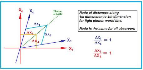

A photon of light is oriented at a 45-degree angle relative to the rest frame. So, for any position along the 4-dimensional photon filament, its position along the X4 axis always has the same displacement value as its displacement position along the X1 axis. Thus, it is the orientation of the X4 axis together with the symmetric orientation of the X1 axis that results in the ratio X1/X4 = 1.0 for anyone, no matter what their speed. And all observers move along their own X4 at speed c. That means that for all observers, their displacement change along their 4th dimension can be calculated using a clock: X4 = ct. The reason clocks work is because t = X4/c. Caution: That does not mean time is the 4th dimension--no more than the path along an interstate is a time dimension just because you can keep track of your progress along the highway by watching your clock on the dashboard.
You should google spacetime diagram and also "block universe" to help with the understanding of these concepts.
So, even though the discovery that "the speed of light is constant" motivated the discovery of relativity, the constant speed of light is not the reason for special relativity. Rather, the constant speed of light is a consequence of this very strange way nature has chosen to work: A 4-dimensional universe, and 3-D cross-section views of the universe are different for observers moving at different speeds--and the views are oriented so that the 45-degree orientation of a 4-D filament (photon of light) will always bisect the angle between X4 and X1, no matter what the orientation (slope--angle, etc.) of the X4 coordinate.
See sketches below illustrating the concept of the symmetric rotation of coordinates for observers moving at different speeds. The lower right box emphasizes how this results in the constant speed of light for all observers. This is really the fundamental answer to your original question.
Another very significant aspect of the rotated coordinates is that the laws of physics are the same for all coordinates rotated in this scheme of symmetric X4 and X1.
Now, the fundamental question becomes, "How did nature manage to come up with the fabric of the universe woven in such a way as this, with weaving rules that give us physics?"

Thanks for the nice post, rbj. Also, from the block universe model the speed of light is special and has the value that it does for three reasons:
1) Nature presents her physics to us using a continuous sequence of 3-D Lorentz frames (cross-sections of a 4-D universe--they are different for differently moving observers).
2) The world line of the photon bisects the angle between the X4 and X1 axis for all observers.
3) All observers move along their respective world lines (respective X4 dimensions) at approximately 186,000 mi/sec. The unitless speed would be 1.0 since that's the distance traveled along X1 divided by the corresponding distance traveled along X4 as depicted in the sketch below.

bobc2 said:
When I try to convey the block universe concept to someone, I try to give it my best shot and not include personal bias. But, it remains a deep mystery for me personally. Many physicists who discuss it feel that this model is directly manifest by the Lorentz frames. I have tried and tried for many years to find material that effectively counters it, without success. I've tried to think up scenarios without success. I can't counter the argument for the block universe, but at the same time I just don't see how we can reconcile it when you consider the bizarre implications. Take your choice between zombies or a consciousness that is present over the entire neuronal world line. Einstein actually seemed to favor the block universe with consciousness(es) present over the entire world line (his letter to Besso's wife upon the death of his close friend and colleague, Besso).
harrylin, I've been impressed with the quality of your posts and consider you one of the reliable physicists here. So, I'm intrigued by your comment about the "Lorentzian picture." I have always felt that the block universe model is the most direct picture of the Lorentz frames that could be envisioned. Thanks for your comments.
You may have noticed that I've posted comments based on the block universe from time to time. I always hope for someone who can post counters to the model, but I have decided that the subject is not too interesting to forum members (or perhaps they feel it is too close to the edge of philosophy--or maybe way over the line and far too deeply into philosophy).
Yes, it's very close to philosophy - but then, "why" is very close to philosophy, and physics started out as a branch of philosophy ("PhD" isn't an error). Anyway, since you presented the 4D interpretation, it's only fair to also mention the Lorentzian 1+3D interpretation.
That interpretation treats Minkowski space-time as a mathematical model or method for calculating physical events (that was at least around 1920 also Einstein's position; only he was rather ambiguous about his interpretation). There is no reason to assume that a calculation method should itself have a 1-to-1 correspondence to physical reality; in general that is also not the case in physics.
If you are familiar with Newton's absolutist interpretation of classical relativity, then SR is easy to understand as a refinement, or correction, of Newtonian mechanics. Time and space are still regarded as concepts that refer to physically very different things. The relativistic effects are explained as effects from absolute motion, just as Newton explained the effects from rotation as due to absolute motion.* Absolute motion has absolute effects, but those effects don't allow us to detect an "absolute frame", even if there is one. That this should not be regarded as a "conspiracy" can be made plausible by for example arguing that everything, even matter, is made up of fields and radiation, or that the conservation laws demand this.
So, it's a trade-off: the block universe model suggests a 1-to-1 correspondence to what physically "really" happens, but with rather bizarre implications; while the absolute motion model suggests that we may retain some of our intuition about "space" and "time", but the downside is that the beautiful symmetry is only in the phenomena.
