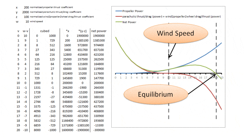

This video above (which you can also view on its YouTube video page ) does *not* explain DDTWFTTW. In the video, Scenario 1 shows the sailboats clearly moving DTWFTTW, but not DDTWFTTW, and it shows in Scenario 2 the propeller moving DDTWATSSATW (directly down wind at the same speed as the wind).
The correct explanation:
We have terms for the net power of the vehicle (i.e. ΔKE / Δt)
Code:
force    velocity  power    source
+v^2	 +v        +v^3     propeller thrust (v>0)
+(w-v)^2 +(w-v)    +(w-v)^3 parachutic thrust (v<w) or parachutic drag (v>w)
-(w-v)^2 -(w-v)    -(w-v)^3 wind2propeller2wheel drag (v<w) wind2propeller2wheel thrust (w>v)
This can be represented as the sum of two cubic equations. Say for example:
net power = x(v^3) + (y-z)(w-v)^3
Where:
x, y and z are coefficients,
v is the vehicle speed, and
w is the wind speed.
If y-z>x, then one can have a system of equations that looks like this:
Code:
Two things:
1) If you are considering the power (ΔKE / Δt) of the cart as seen in the ground frame, then all forces on the cart should be applied at v (the carts velocity in the ground frame)

A.T. said:
Two things:
2) The "wind2propeller2wheel" is never a "thrust" on a simple fixed pitch DDWFTTW cart. The wheels are always braking the cart, even below wind speed. With variable pitch it would be possible to turn the wheels with the rotor at v<w, but that is not what happens on the Blackbird. See post #3.
The DDTWFTTW at v greater than w cart experiences a direct headwind when going DDTW. There is more to lose than to gain from the headwind. Note that in my attached diagram, the cubic function that relates to the tailwind and headwind effects is zero at v equals w. This combines the y and z cofficients. When v is greater than w, the z coefficent adds to the power and the y coefficent detracts from it. My "wind2propeller2wheel drag/thrust" (z) coefficient (rotationally-induced) was treated as a separate entity (and is significantly smaller) than the (non-rotationally induced) "parachutic thrust/drag" (y) coefficient although technically they both involve power transfer to and/or from the wheels. Therefore, when combined, they detract from the power at v greater than w but add to the power at v less than w. v and w are both evaluated with respect to the ground. The steady state thrust causes v to exceed w due to the initial tail wind storing up inertia and mechanical impedance in the propeller and the slipstream. The only reason it goes faster is the building up of this propeller thrust due to inertia and flow coupling with the wind. A sail boat whose velocity made good exceeds wind speed uses water as a reaction mass to attain this excess speed (for all one must do with that is to turn the vehicle, after it exceeds wind speed, toward direct downwind), but that option does not exist for the Blackbird DDTFTTW sand yacht. On top of this, many of your videos (the ones showing the gears) apparently depict the tailwind as providing a steady thrust when actually that tailwind is replaced by an unmistakable headwind. The sailboats simply cannot exceed windspeed downwind without changing the angle of the apparent wind either by turning the boat (requiring a reaction mass) and/or the wind itself. Thus, your analogy with sail boats is flawed.
  • #33
kmarinas86 said:
The DDTWFTTW at v greater than w cart experiences a direct headwind when going DDTW. There is more to lose than to gain from the headwind. Note that in my attached diagram, the cubic function that relates to the tailwind and headwind effects is zero at v equals w. This combines the y and z cofficients. When v is greater than w, the z coefficent adds to the power and the y coefficent detracts from it. My "wind2propeller2wheel drag/thrust" (z) coefficient (rotationally-induced) was treated as a separate entity (and is significantly smaller) than the (non-rotationally induced) "parachutic thrust/drag" (y) coefficient although technically they both involve power transfer to and/or from the wheels. Therefore, when combined, they detract from the power at v greater than w but add to the power at v less than w. v and w are both evaluated with respect to the ground. The steady state thrust causes v to exceed w due to the initial tail wind storing up inertia and mechanical impedance in the propeller and the slipstream. The only reason it goes faster is the building up of this propeller thrust due to inertia and flow coupling with the wind. A sail boat whose velocity made good exceeds wind speed uses water as a reaction mass to attain this excess speed (for all one must do with that is to turn the vehicle after it exceeds wind speed toward direct down wind), but that option does not exist for the Blackbird DDTFTTW sand yacht. On top of this, many of your videos (the ones showing the gears) apparently depict the tailwind as providing a steady thrust when actually that tailwind is replaced by an unmistakable headwind. The sailboats simply cannot exceed windspeed downwind without changing the angle of the apparent wind either by turning the boat and/or the wind itself. Thus, your analogy with sail boats is flawed.
You have misunderstood how the ddwfttw cart works. The thrust generated by the prop is not dependent on the direction of the wind with respect to the cart. It is the relative motion between the air and the ground which is the power source.
  • #34
You did not even properly read my point. In my model, the power of the thrust*velocity of the prop is repesented by x*v cubed, where v is the speed of the craft over the ground. The propeller in a fixed-gear DDTWFTTW land yacht is proportional to wheel rotational speed. The propeller's power has nothing to do with a w and its movement over land. In fact w can be zero, as is the case with the treadmill demonstration. Realize that the power of the prop is associated with x, not y or z, The latter two coefficents in my model have something to do with the relative motion between the wind and the cart and corresponding headwind and/or tailwind.
  • #35
kmarinas86 said:
You did not even properly read my point. In my model, the power of the thrust*velocity of the prop is repesented by x*v cubed, where v is the speed of the craft over the ground. The propeller in a fixed-gear DDTWFTTW land yacht is proportional to wheel rotational speed. The propeller's power has nothing to do with a w and its moment over land. In fact w can be zero, as is the case with the treadmill demonstration.
I read it, I guess I did not understand it. Could you elaborate on why you think the sail to prop video is a flawed analogy? I agree that in scenario 1 we see a sail tacking faster than the wind but not directly down wind. It is in scenario 2 that we seem to disagree. If we tack around a cylinder we are clearly going directly downwind, faster than the wind.
