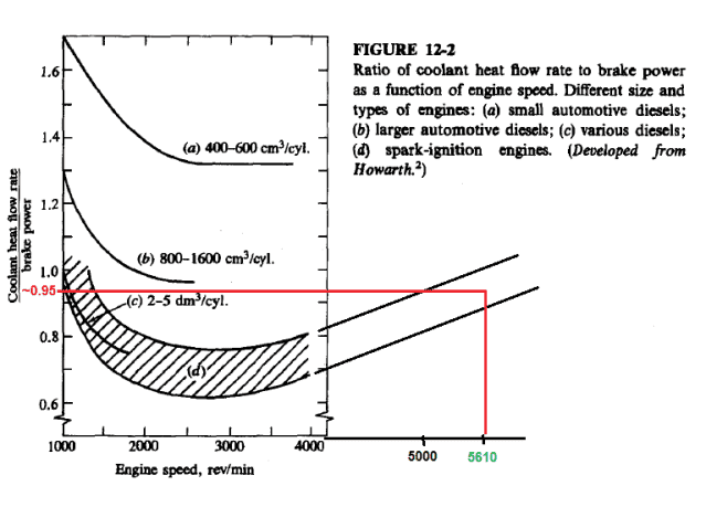

Attached is a graph that has the coolant heat flow rate divided by brake HP. I took the revs that make the most power (from dyno test) and got a value (0.95). It depends on the engine type as seen on the right corner.
Once you have the value place your engines brake Power (in KW) and compute the heat flow needed to remove (Q dot = value X power [KW]).
Now let's make a few assumptions:
The water temp entering the radiator : 100 degrees C.
The water temp exiting the radiator : 80 degrees C.
The delta= 20 C.
from the famous equation: Qdot=mDot X Cp X delta T
You can isolate the mdot and calculate it.
The graph is from an auto engineering book.. I don't remember which one.

where to get this graph for my engine??
& what about the air flow rate through the radiator..
This graph covers most cars. The paragraph written on the upper right side states what letter represents what type of engine.
Each engine type has a line or a range and according to your Engine Speed you derive the coolant heat flow/ brake power ratio.
Using this ratio- follow the instructions in my first reply and you can get a water flow rate.
What type of engine do you have and how much HP does it have? Do you know when it reaches its peak power (REVS) ?

mine is an 796cc, 3 cylinder, 37 bhp (max at 5000 rpm) petrol engine.
