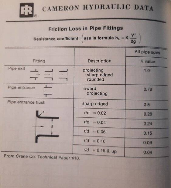

Thank you so much for your help! I hope its okay to respond with some follow up questions.
I am assuming your first equation is derived from the Weisbach formula. Can I ask how we are okay with assuming k=1?
Also, how did you come up with a rough head loss of 24480 feet?
I am calculating a flow rate (Q = v*pi*r^2) of 246.61 cubic feet per second which would drain 0.068ft^3 in 2.76e-4 sec. How did you get 0.04 seconds?

rad_controls said:
This Thank you so much for your help! I hope its okay to respond with some follow up questions.
The exit loss (k=1) is found in any of the engineering handbooks (Crane 410, Cameron Hydraulic Data, etc.). In this case I think it means that the pressure energy in the tube upstream of the opening is converted to kinetic energy of the flow downstream without any loss; there is no swirling or eddies in the open atmosphere. I'm not 100% on that being the correct interpretation.
The upstream pressure (85 psig) is converted to feet of head using
##h_L=\frac {144 \Delta P} {\rho}=\frac {144 * 85} {0.5} \frac {in^2}{ft^2} \frac {lb} {in^2} \frac {ft^3} {lb}=24,480 ft##
This is based on the pressure difference across the exit being upstream pressure minus atmospheric pressure.
I think you're missing a factor of 144 (in^2 to ft^2).
the flow area is ##\frac {\pi} {4} (\frac {d} {12})^2 = \frac {\pi} {4}(\frac {0.5} {12})^2=0.00136 ft^2##
then
##q \frac {ft^3} {sec}=v (\frac {ft} {sec^2}) A (ft^2) = 1256 (\frac {ft} {sec}) 0.00136 ft^2 = 1.71 \frac {ft^3} {sec}##
then
##time=\frac {0.068 ft^3} {1.71 \frac {ft^3} {sec}}=0.0397 sec##
