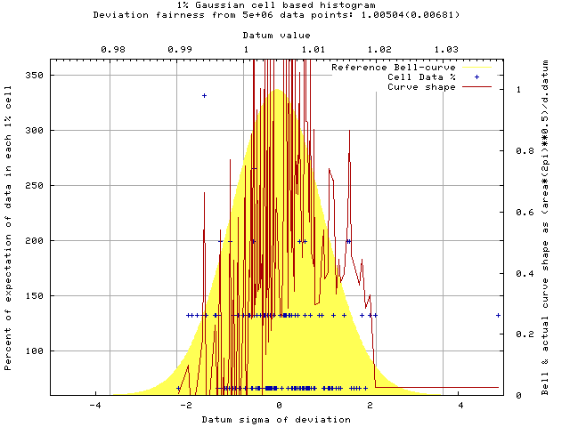

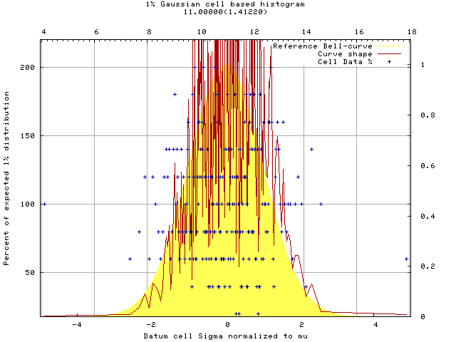

Ok, I uploaded the picture files as attachments, but it only allows 3 and I really needed 4. Are you able to see them? and do you know if there is any way to put them in-line in my text, so I have to write less description?
The first picture is the plot of a 5 million sample Gaussian distribution converted into dice roll quantiles (1% deviation cells); the second is a histogram of the first plot's cell histogram (eg: a gaussian check of the dice roll distribution). In theory, if your idea of a large number of points were truly estimated by a normal curve -- the data in that plot would be "normal" looking... ?
I haven't tried folding the plot to make the deviation sign-less as that might be a bit closer to "normal". Perhaps tomorrow I'll try that out; but the problem still exists for signed data.
The quantiles themselves (1st plot & last plot) look visually to be uniformly distributed -- eg: as would be expected for a normal distribution; but the visual picture is mildly misleading.
If I plot a 1000 data point Gaussian, it's deviation from the bell curve is far more severe than the 5 million data point example. (3rd plot). But the bell shape can still be detected and the discreet granularity of the dice rolls becomes very visible.
reminder: What I am wanting to add to my plot (eg, the first and last one) is a colorization or enlargement of data points on the histogram to indicate outliers. eg: for quantiles which are 5% chance/plot probable, one color, for 2% chance/plot another, for 0.1,0.01, 0.001 which are severe, I was thinking to change the size of the data points to make them REALLY obvious.
Any thoughts on how to attack this a-symmetrical :devil:?
Edit: the second graph is changed as it was curve shape regaussed, instead of cell percentile -- my apology for any confusion this caused.

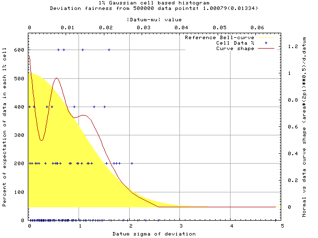

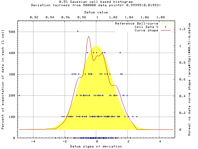

I studied the problem a bit more this week; I found something I hadn't noticed before.
On the graphs, the median value for the Gaussian distribution of "fair dice" cells wasn't 1.0 (100%), which is by definition, wrong.
When I looked at my program closer, I realized that I was dividing the data up into 101 or 201 cells, rather than 100 and 200; By counting twice with this error, I arrived at a much more skewed (amplified) distortion than the actual case...
See below for new graphs of the same random generator data-set, but counted correctly.
I also added a smoothing algorithm for the curve shape to make it easier to see trends.
1) :rolleyes: Do you think the following idea is actually doing what I think it is doing?
What I did is to take a running average of 3 neighboring cells, compute the center cells |deviation| from the average of three cells -- and then distribute a fixed percentage of that "error" deviation (50%) to the cells on the right and the left, BUT in proportion to e**(-0.125*x**2); eg: it's the diffusion equation for heat, etc, based on the difference in cell center as to how much probability will diffuse to the right or left cell; I am hoping that this will effectively keep the same shape of the distribution -- but as if many times the data points were sampled into 100 cells, such that a normal approximation will become valid... (chiro is correct about that...)
2) I have a slow Bernoulli trial computation used for the discrete non extrapolated distribution; how do I make it fast?
Since I don't know if 1) is accurate, I compute bp(p,q,n,r) in my program (now) with p=0.01,q=0.99 , and that gives me the probability of outliers correctly (Not shown in plots, yet);
I still find that the deviation of dice rolls from the "average" is still asymmetrical as noted before, but it does get more "normal distribution" looking as the number of data-points counted becomes >> 1000.
(Thanks chiro! I just wish I had spotted the 101 vs. 100 cell problem earlier! ;) )
Does anyone know of a fast computing approximation to a binomial, that is more accurate than taking e**-0.5*z**2, and fitting z to the binomial's pn mean and (pqn)**0.5 deviation? (Standard textbook approximation of the binomial by the normal curve)
eg: I need an algorithm good for all n, from 2 to 1e7 data points... !
eg: something which is more accurate near the tails? (I don't care about the "center" as outliers are never near the center, obviously...)
3) :!) Inspecting the last two graphs, I know they are going to be skewed; and I was thinking I could possibly replicate the idea of binning of a continuous bell/Normal curve into 1% quantiles; but do it with the bernoulli trial p=0.01,q=0.99 made into a pdf with n→∞; eg: scaled by keeping the means and asymmetric deviations preserved to scale n vs the x-axis (deviation). I could then make cells to bin the data into the percentile chance of the particular dice roll, vs a normalized 100% Bernoulli trial; and then make smaller cells in the outlier regions to find 0.5% 0.1% 0.05% 0.01% probabilities
Does anyone know a continuous PDF for the Bernoulli trial? :!)
