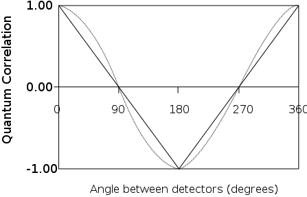

Good question. I assume you refer to this chart borrowed from wikipedia:
Here cosine curve is QM prediction and linear function is the maximum correlation achievable with local realistic model, obtained by replacing ≥ with = in Bells inequality. This linear function actually corresponds to a very simple thought experiment by Bohm: At the source two atoms get random but opposite spins. During the measurement the spin of each atom is projected onto the corresponding direction of measurement and the sign of this projection becomes the outcome. In Bell's terms A(a,λ) = sign cos (a-λ) = { 1 when |a-λ| ≤ π/2 otherwise -1 }
Now, interesting question is what kind of functions are allowed by Bell's inequalities. The impression one gets is that that no LR model can get above the straight line. This is not so, its a bit more subtle. For example, consider roulette wheel with 10 alternating red/black sectors, where the outcome of a measurement is determined by the color at angle a when the wheel stops: A(a,λ) = sign cos 5(a-λ) = { 1 when |a-λ| mod π/5 ≤ π/10 else -1 }. It reproduces the usual values at 0°, 90°, 180° and 270° but jumps all over the place in between: from 1 at 0° to -1 at 36° back to 1 at 72°, crosses 0 at 90°, -1 at 108° etc., all that in perfect agreement with Bell.
On the other hand, QM predicts 0.7 at 45° where no LR model can get above 0.5.
good one Delta Kilo. thanks for pointing out the subtlety..
give me time to digest that...
is 45 degree = the angle between the polarizers?
and is .7 (or .5) the probability that the polarizer will flash green = i.e. give same answer?

angle: LHV / QM
0: 1 / 1 ; E(0,0) perfect correlation
15: 0.66 / 0.87 ; E(-15,0) = E(0,15)
30: 0.33 / 0.5 ; E(-30,0) = E(-15,15)= E(0,30)
45: 0: / 0 ; no correlation
60: -0.33 / -0.5 ; anticorrelation
These are expectation values of correlation E(a,b) (confusingly called P(a,b) in Bell's paper)
Coincidence probabilities: P(a=b) = E(a,b)/2+0.5

When you have separability and combine that with a model that reproduces Malus (this is the usual starting point for a model), you end up with the nonlinear function:
P(a,b) = .25 + .5(cos^2(a-b))
This is well within the Bell boundary. Of course, it is even *farther* away from the QM prediction for an entangled state.

Bell's inequality isn't strictly speaking linear. A linear relationship would be of the form A=B+C. But Bell's inequality is of the form A≤B+C. You can call the constraint that local hidden variables must satisfy "sublinearity", because it's at most linear. But in quantum mechanics you can have the correlation be such that A>B+C, or "superlinearity". So no matter what a local hidden variable theory won't be able to match the quantum mechanical prediction (e.g. for the angles -30, 0, and 30), but the best it can do is have A=B+C. You can of course make a theory with A<B+C, and thus it will be nonlinear, but as DrChinese said that will only be farther, not closer, than the specific prediction of quantum mechanics in this case.

The linear function is more of a dividing line between Bell compliant and Bell non-compliant.
I do agree with this. This is the result of archetypal Bell-type LR models, not necessarily the most sophisticated Bell-type LR models.
The fact is that you can get a nonlinear (sine or cosine) angular dependence incorporating the standard LR restrictions. But it will be, necessarily, skewed. The outstanding question is ... why. What, exactly, is it about Bell-type LR models of quantum entanglement that precludes congruence with QM predictions?

But Herbert is not just randomly expecting the correlation to be (sub)linear. Rather, he is showing how a certain assumption, namely that quantum entanglement can be explained by local hidden variables, leads to the conclusion that the correlation is (sub)linear. Surely you agree that some assumptions lead to correct conclusions about the world, and other assumptions lead to incorrect conclusions about the world. He is doing a proof by a contradiction, a common technique in argumentation.

I've been trying to do that for a while now. Here's my latest attempt, from post #5 of this thread:
lugita15 said:
1. Entangled photons behave identically at identical polarizer settings.
2. The believer in local hidden variables says that the polarizer angles the photons will and won't go through are agreed upon in advanced by the two entangled photons.
3. In order for the agreed-upon instructions (to go through or not go through) at -30 and 30 to be different, either the instructions at -30 and 0 are different or the instructions at 0 and 30 are different.
4. The probability for the instructions at -30 and 30 to be different is less than or equal to the probability for the instruction at -30 and 0 to be different plus the probability for the instructions at 0 and 30 to be different.
Which of these steps do you disagree with, or which of these steps do not apply to all possible local hidden variable theories?
