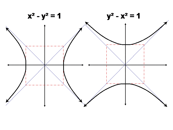

Flat spacetime is a Minkowski or hyperbolic space. Where a unit vector in a Euclidean plane would be confined to the unit circle, unit vectors in spacetime are confined to a unit hyperbola instead. The asymptotes of the hyperbola are what light rays follow from the origin. This is why no real particle can ever travel like a light ray--no matter how it goes along the hyperbola, it will never have the same four-velocity as a light ray.
