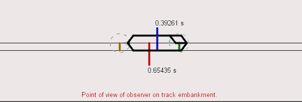

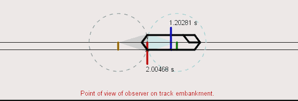

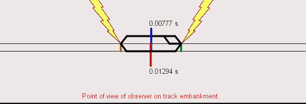

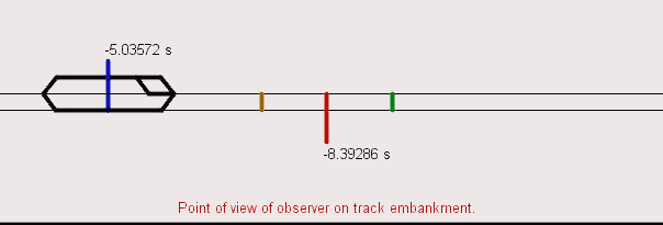

ghwellsjr said:
Now that we all agree that the video is complete nonsense, we need to abandon it. I pointed you to an animation that is correct:
http://i910.photobucket.com/albums/ac304/kev2001_photos/Etrain2e.gif
Please use this animation to understand what happens according to the two different frames of reference.
Then read Einstein's explanation of the scenario here:
http://www.bartleby.com/173/9.html
Nothing could be clearer. There is no need to belabor this anymore.

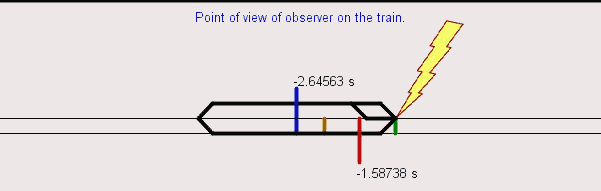

My main issue is that the train strikes cannot be equidistant from the platform observer if he sees them simultaneously. One strike happens – the rear one (that is further away from the platform)– the light then begins its journey towards the platform then the closer strike happens . Then they both move together and reach the platform guy simultaneously.
So now we're in the lightning example again.
I really don't see why you think this is. That both events are equidistant from the platform observer is presented as a given piece of information, something no one should have to deduce. There are many ways he can determine the distance, from putting lines on the train to mark off distances to figuring out something about the brightness of the strikes or the sizes of the char marks the strikes leave behind. It is a given piece of information. Why do you think it cannot be?
Edit: if the train is moving left to right, do you not agree that the rear flash comes from the platform observer's left and the forward flash from his right?
  • #323

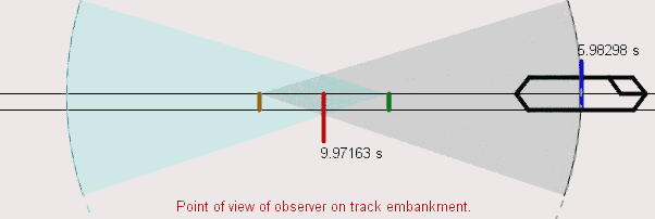

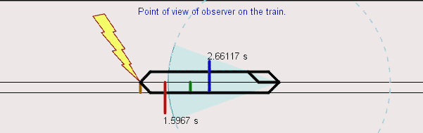

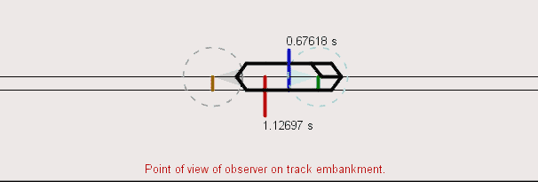

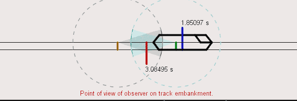

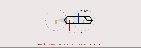

Solarflare: can you see in the animation that the platform observer sees both flashes hit him at 2 seconds according to his clock and that light from the front flash hits the train observer at 1 second according to her clock and the light from the rear flash hits her at 6 seconds according to her clock and that both frames display the same information?

Have you looked at ghwellsjr's animation? I too think this neatly resolves what's going on in this lightning scenario.

Yes, cepheid has posted an excellent summary and to help you examine it in detail, I'm going to post snapshots from the animation.
cepheid said:
First of all, they are not two different "scenarios." They are the same scenario, from two different points of view. This is a point that many people (Doc Al, DaleSpam, Muphrid, myself) have tried to make to you numerous times. Events in spacetime happen in all frames, only their coordinates (i.e. where and when they happened) differ from frame to frame. Secondly, NO, I don't think that the train is in motion in both frames. I don't think that at all, and I have no idea why you would think that I think that.
In order to help you focus on one frame of reference at a time, I'm going to first show only the top half of the animation labeled "Point of view of the observer on track embankment" which is what we have been calling the platform frame and then I'm going to show only the bottom half of the animation labeled "Point of view of observer on the train" or the train frame.
Just in case you haven't already figured it out, the red bar is the platform observer, the blue bar is the train observer, the green bar is the location on the track where the lightning strikes the front of the train and the brown bar is the location on the track where the lightning strikes the rear of the train.
cepheid said:
Here is what each of the observers would describe as having occurred:
Platform observer
"I know that when the forward strike occurred, it was the same distance ahead of me as the rear strike was behind me when it occurred.
  • #341
cepheid said:
I also know that they both traveled at speed c relative to me.
  • #342
cepheid said:
I saw them both at the same time.
cepheid said:
Therefore, since both had the same distance to travel at the same speed, I conclude that they occurred simultaneously.
  • #343
cepheid said:
[Addressing the train observer:] I'm stationary, and you are moving forwards past me. Therefore you were approaching the source of the forward flash,
  • #344
cepheid said:
and receding away from the source of the rear flash. That is why you saw the forward flash before you saw the rear one. The forward flash had a shorter distance to travel before reaching you than the rear one did."
