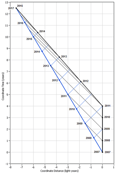

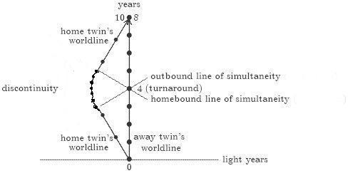

I was studying the twin paradox (of Einstein special relativity) and everything was working well until I get to the traveler's spacetime diagram.
First let me introduce the paradox for you to understand the diagram.
Pam is the twin sister of Joe. Pam goes out Earth in 2007 in a spaceship with v = 0.6c (velocity that Jim measures) for a 3 light-years round trip (again, distance that Jim measures). Every year that passes in Pam calendar, she sends a message to Jim ( the message travels with light-speed). So do Jim. At the end, they find out Pam is 2 years younger than Jim.

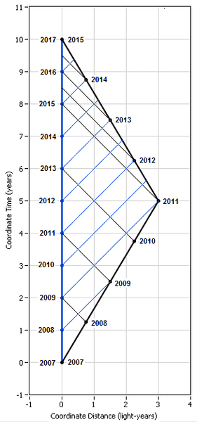

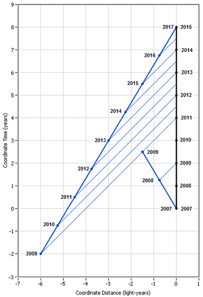

The spacetime diagram in the Jim's frame of reference is:

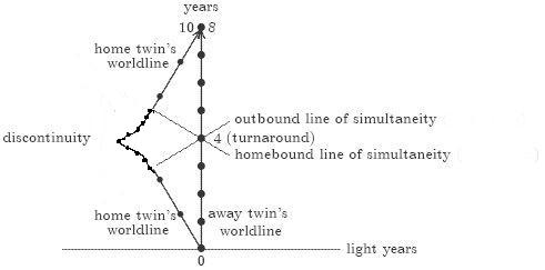

But when we try to put this in the Pam's frame of reference it goes like this:

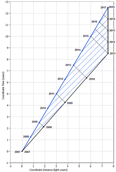

Or, if we draw the message lines too (red lines)
http://img109.imageshack.us/img109/643/33306470.png
I'm confused about the following:
1) What is this discontinuity in the diagram? What does it means?
2) In 2009 (Pam's calendar) Pam sends a New Year message to his brother, and we can see the message intersects the diagram 2 times (in 2011 and 2014, Jim's calendar ). What does it mean? Will Jim receives 2 times the same message sent by Pam?
3) In the discontinuity line, 2 messages sent by Pam arrives. What does it mean? Seen that the turnaround occurs in a very short period of time, will Pam receive this 2 messages at the turnaround, and simultaneously?

That's because you are trying to draw a spacetime diagram for a non-inertial frame as if it were an inertial frame. You can't do that; non-inertial frames work differently.
It means, as above, that you've tried to treat Pam's frame as an inertial frame, when in fact it isn't. There isn't even a single unique way to draw Pam's spacetime diagram; there are multiple ways to construct a non-inertial frame in which Pam is always at rest, and they will give rise to diagrams that look different.
The real question is, why do you feel it necessary to do this to study the twin paradox? You can do everything in the single inertial frame in which the stay-at-home twin is at rest. What's missing?

Basically, they've shown how not to construct coordinates representing the traveling twin at rest. There are perfectly reasonable way to do so, that have no discontinuities if you even slight round the turnaround. They don't look anything like that diagram, which I would call a just strawman to shoot down.
They give, as their main point, that you are much better off sticking to one of the inertial frames.
While I agree with their overall point, their implication that any attempt to represent the experience of the traveling twin in one set of coordinates will be absurd, is, itself absurd.

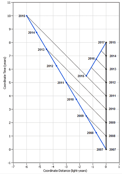

I don't have software to draw nice pictures. Using the most common simultaneity convention for non-inertial motion, assuming a slight smoothed turnaround, and assuming that x coordinate represents proper distance along a simultaneity surface, then for such coordinates you would get:
- the traveling twin a straight vertical line.
- The home twin would proceed to the left from starting point at less the 45° to vertical until near midway point. Then it would shoot far to the left nearly horizontally, sharply turnaround back, nearly horizontally (with no intersection, loop, or discontinuity); then proceed the rest of the way back in a straight line less the 45° to the vertical.
The wild path for the home twin would still be a geodesic in these coordinates, while the vertical traveling twin path would not be a geodesic. Light rays would have complex paths in these coordinates.
If you marked proper time of the home twin along its path in these coordinates, most of the tick marks would occur on the 'shoot left and back' portion of the trajectory.

The discontinuity is due to Pam's infinite acceleration during her abrupt change in velocity at the apex of her journey. The instantaneous jump in her velocity causes an instantaneous jump in the direction of her lines of simultaneity.

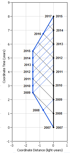

This discontinuity can be eliminated if we smooth Pam's journey out by rounding off the corner. The simplest way is to replace the sharp corner by a segment of a hyperbola (which represents constant proper acceleration in the Minkowski diagram).
The apparent double intersections come from straightening out Pam's worldline, which is not straight: it has a kink (or, if you smooth out the corner, a curved region). The last diagram violates the postulates of spacetime diagrams---it represents a non-inertial observer by a straight line. In the process of contorting the spacetime diagram to accomplish that, you end up representing a true, inertial observer as an impossible looped path.
When an observer undergoes acceleration, it is possible that objects in the "spatial future" (that is, outside the lightcone, but ahead of the line of simultaneity) end up in the "spatial past" (outside the lightcone, and behind the line of simultaneity), or vice versa. During the short moments when Pam turns around, large swaths of Jim's worldline quickly migrate from Pam's "spatial future" to her "spatial past", effectively causing Pam to "skip" many of Jim's years. The skipped years are the ones that appear in your triangular loop.
I would not attempt to use your distorted diagram to find out how signals travel between Pam and Jim, because you have essentially torn a rift in spacetime and glued it back together in order to make that diagram. The paths actually taken by light are not going to be the obvious ones as you might try to draw in that picture.

Jaunzaum's second diagram is incorect. It ignores the length contraction that will make Pam see a much shorter distance between the start and end of her journey while she is traveling. Only as they match speeds at the midpoint of the journey does this distance expand again to match the distance seen by Jim. So Pam sees Jim shoot out further out at turnaround, as has been mentioned before (by Peter, I think).
Also, when she switches on her gravity machine (her rocket motors) she will see Jims clock speed up due to the difference in gravitational potential. So a more correct diagram would be like this -
In answer to Peter's question, his view is that of a mathematicuian. All the correct numbers can be obained from one static reference frame, and one doesn't have to look at the situation from any other point of view. But some of us want a bit more than numbers. We want to be able to visualize the situation from different points of view to enable us to understand it a bit more deeply. Of course, there are limits to what our imagining can achieve - I still like the Bohr atom with its circular and elliptical orbits, and electrons jumping from one orbit to the other!
Mike
NB. I didn't count the year dots on Jims turnaround line.
NB2. The two lines of simultaneity shouldn't meet at 4 on Pams time line - than would assume that turnaround is accomplished in zero time.

Thanks for the drawing. You will see that this is exactly what I described in my post #8. An example of what Peter is referring to about limitations of the approach is try to do this for a sideways W shaped trajectory for Pam (where the center peak of the W does not reach all the way back to the stay at home world line). You find that you cannot construct coordinates of this type at all because the lines of simultaneity for this convention intersect, causing the the home world line to by multiply labeled: for range of events on it, each is given 2 time coordinates, which is inadmissible.
The direct metric method, or picking any inertial reference frame method, or doppler analysis all work fine for a W shaped trajectory, but these lines of simultaneity break down. It simply means there are limitations to that simultaneity convention for more complex non-inertial motion. You can pick a different simultaneity convention, getting a different type of diagram in which Pam is 'at rest', that does work for this case. One example is radar coordinates.

Mike Holland said:
ghwellsjr said:
If you've ignored the paths that light takes to travel, then you haven't addressed jaumzaum's issue, have you? But while we're waiting for your diagram that does that, maybe you could answer Peter's questions:
Could you be a little more specific with which diagram you are referring to? I couldn't find one that was incorrect.
In the meantime, I decided to redraw the diagrams from the link that Jaumzaum provided specifically to combine the signals for both Jim and Pam in each drawing. Here is the first one for the Inertial Reference Frame (IRF) of Jim (shown in blue--Pam is in black):
Next is the last diagram shown in the link which is the IRF in which Pam is at rest during the return part of the trip:
I don't know why they only showed the messages going from Pam to Jim. It's just as easy to show Jim's messages going to Pam.
And here is a diagram they didn't show which is the IRF in which Pam is at rest during the first part of the trip when she is traveling away:
Please note that each drawing illustrates exactly the same information. You can follow any message being sent by either twin, noting the year it was sent, and track how it was received by the other twin in which year it was received.
On the next post, I will show another aborted attempt to marry portions of these last two diagrams together in which Pam is always at rest and then I will show a successful way to depict a non-inertial diagram in which Pam is always at rest and it also correctly describes the paths of the messages.
