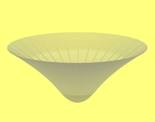

Passionflower said:
Lookup "the interior Schwarzschild solution" and with it integrate the distance from the center to the edge and compare it with the area. The result will be non-Euclidean.
Here is an embedding diagram of the spatial geometry (2D spatial slice) that combines interior and exterior Schwarzschild solution:
From http://commons.wikimedia.org/wiki/File:Schwarzschild_interior.jpg

Passionflower said:
Agreed or am I mistaken?
You're mistaken. The radial distance between shells, compared to its Euclidean value, is given by the metric coefficient [itex]g_{rr}[/itex] in a chart where the radial coordinate [itex]r[/itex] is defined as [itex]A / 4 \pi[/itex] for a 2-sphere of surface area [itex]A[/itex]. Since [itex]g_{rr}[/itex] is greater than 1 inside the massive body (except at the exact center, r = 0, where it becomes 1), the radial distance between shells will be larger than the Euclidean value there.
What you and A.T. are calling the "sign" of the curvature determines, roughly speaking, the *gradient* of [itex]g_{rr}[/itex], not [itex]g_{rr}[/itex] itself. In the vacuum exterior region, [itex]g_{rr}[/itex] gets larger as you move inward from infinity (where it is 1) to the surface of the body. In the non-vacuum interior region, [itex]g_{rr}[/itex] gets *smaller* as you move inward, until it is 1 again at the center.
(I say "roughly speaking" because the curvature is the second derivative of the metric coefficients, not the first. But in this particular case the sign of the curvature happens to match up with the gradient of [itex]g_{rr}[/itex] in the way I said.)
  • #35
If I measure the circumference on the equator, and then extend rods down through the Earth to the other side will show me a diameter > than circumference / pi, correct? utilizing more iron than classically expected.
Then I move this contraption into space, there will be stress from the center rod being longer than would snugly fit in the circle.
And if I built my contraption in space - using measurement I had made in person on the equator [and then rod = circumference / pi], then moved it to the earth, the rod would not be long enough.
Have I got all that right?
