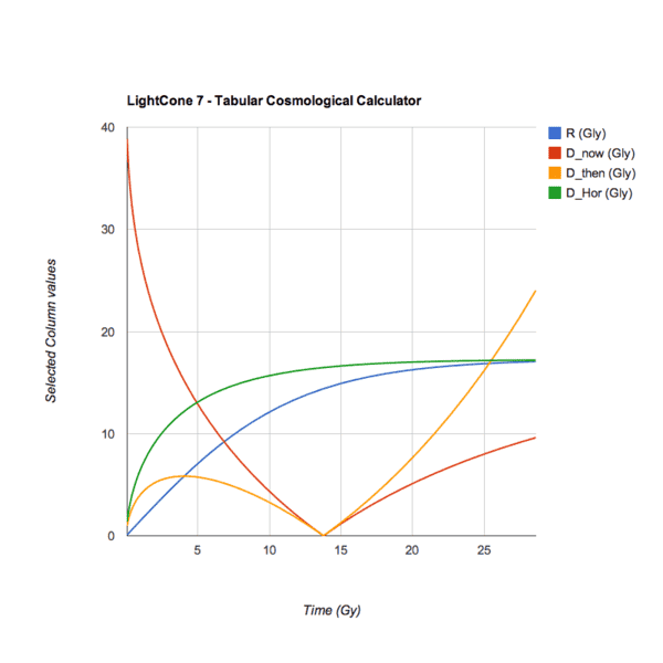

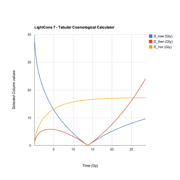

Pear-shaped past lightcone
Another thing if you were tutoring cosmology would be to work thru the fact of the past lightcone being pear-shaped. The past lightcone is the location in space and time of every source we are getting light from right now. The gold curve is the lightcone's radius. You could think of it as the history of a flash of light aimed towards us that is at first swept back by expansion (its distance from us increasing) and then is briefly at a constant distance when its progress is exactly canceled by expansion (the widest part of the pear), and then begins to make progress towards us.
The gold curve is also an outline of the FUTURE or "forward" light cone. The times and places we could contact if we sent a flash of light today. The gold curve, radius of the past and future lightcones, is a plot of the Dthen column of the table. To repeat, the pear-shaped past part gives the distance of the source when it emitted the light we're getting now, and also the distance of a flash of light that started towards us long ago in the past and only just got here today (having being swept back at first).
The blue curve of the Hubble radius is to show it intersects with the past lightcone at the latter's maximum. Hubble radius plots the size of distances which, at the given time, are expanding at speed c. The widest part of the pear is where the light's forward progress is exactly canceled by expansion and it hangs suspended at a constant distance from its target. This occurred around the year 4 billion.
Here's the corresponding table.
[tex]{\scriptsize\begin{array}{|r|r|r|r|r|r|r|r|r|r|r|r|r|r|r|r|} \hline T (Gy)&R (Gly)&D_{now} (Gly)&D_{then}(Gly)&D_{hor}(Gly) \\ \hline 0.067&0.10&38.87&0.97&1.38\\ \hline 0.112&0.17&37.38&1.31&1.88\\ \hline 0.186&0.28&35.61&1.74&2.55\\ \hline 0.308&0.46&33.52&2.29&3.42\\ \hline 0.510&0.77&31.05&2.97&4.54\\ \hline 0.844&1.27&28.12&3.76&5.96\\ \hline 1.394&2.08&24.67&4.61&7.70\\ \hline 2.297&3.40&20.62&5.39&9.70\\ \hline 3.759&5.45&15.94&5.83&11.86\\ \hline 6.048&8.33&10.68&5.46&13.89\\ \hline 9.395&11.63&5.17&3.70&15.49\\ \hline 13.787&14.40&0.00&0.00&16.47\\ \hline 18.924&16.05&4.37&6.10&16.95\\ \hline 22.085&16.57&6.42&10.90&17.09\\ \hline 25.326&16.88&8.16&16.80&17.16\\ \hline 28.613&17.06&9.61&24.01&17.20\\ \hline \end{array}}[/tex]
