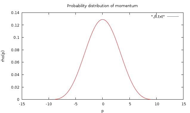

For the infinite well, we have
\psi(x) = \sqrt{\frac{2}{L}}\sin\left(\frac{\pi x}{L}\right)~~~\text{for}~x\in \langle 0,L\rangle
\psi(x) = 0~~~~~~~~~~~~~~~~~\text{for}~x\in ℝ - \langle 0,L\rangle,
so the momentum function is
\tilde{\psi}(p) = \sqrt{\frac{2}{L}} \int_0^L \sin\left(\frac{\pi x}{L}\right) e^{-ipx/\hbar}\,dx,
which gives probability distribution of momentum
\rho(p) = \frac{4\pi\hbar^3 L}{(p^2L^2-\pi^2\hbar^2)^2}\cos^2 \frac{pL}{2\hbar}
(I copied the result from Landau&Lifgarbagez, sec. 22, problem 1.)
The plot of ##\rho(p)## for ##\hbar,L =1## is here:
So the zero momentum is most probable, and with increasing magnitude of the momentum probability decreases, which seems quite reasonable.

That's the momentum distribution for a particle in free space (or in a finite potential) prepared in the state represented by the sine function (and 0 outside the interval [0,L]). That's ok, but for the particle in the infinite square well it doesn't have a physical meaning in the sense of momentum measurements, because there is no momentum observable that you could measure!
I take that to mean that the boundary conditions just aren't physical
Likes Joker93
##\rho(p)\Delta p## can be ascribed the meaning of probability that particle has momentum in the interval ##p..p+\Delta p##. I do not see why such technical detail as vanishing of ##\psi## outside of the well should invalidate the concept of momentum.
The above calculation of ##\rho(p)## is simplest for the infinite well. The meaning of the calculation is that we can use the result for deep but finite well. We expect that ##\rho(p)## should be good approximation to the actual distribution there.

Isn't zero momentum invalid(unphysical) for the infinite well(since it would give E=0 and thus Ψ=0)?

So, is the distribution that you gave valid for the infinite well or is it just an approximation for very deep finite wells?
This is because there are no momentum eigenvalues that satisfy the boundary conditions? I mean, for the momentum representation to have a physical meaning, the momentum operator's eigenfunctions must satisfy the boundary conditions? If so, why does this particular thing make the momentum operator self-adjoint?
Lastly, because the momentum eigenfunctions don't satisfy the boundary conditions, that makes it not be self-adjoint, but does that also mean that it is not hermitian?
The point is indeed that there's no eigenfunction to any eigenvalue of ##\hat{p}=-\mathrm{i} \mathrm{d}_x##, because if you fulfill the boundary conditions for ##u_p(x)## then ##\hat{p} u_p(x)## doesn't fulfill them. This shows that, although ##\hat{p}## is a Hermitean operator it is not self-adjoint, and thus it cannot define a proper representation of an observable. Note that, however, the sin and cos functions with the appropriate boundary condistions are true eigenfunctions of ##\hat{H}=\hat{p}^2/(2m)## and thus ##\hat{H}## is not only Hermitean but also self-adjoint and thus represents an observable (here the Hamiltonian for a particle confined in an infinitely high square well).
