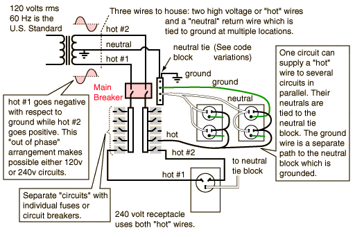

Hello everyone. This is my first post, I hope I'm in the right place.
I'm a home inspector and belong to a group who posts topics about various different things including electrical questions. The question was asked about an electrical panel which housed two 60 amp main fuses. The service entering the panel is single phase 120 volt on each of two legs with a neutral. There for the panel can supply voltages of 120 volts (one leg and neutral) or 240 volts across both legs. This is a common setup in most homes. The inspector stated this is a 60 amp service, which is true. The home owner says its a 120 amp service, which is a false statement. The size of the service is always based on the size of the main circuit breakers or main fuses. This is fact. Here's where the argument started, Some say if you put a 120 volt 60 amp load on leg A and a 120 volt 60 amp load on leg B, the total consumption of current is 120 amps. Others say its not possible to draw more than 60 amps total no matter what the configuration is because the main fuses are only rated at 60 amps. I'm asking for clarification and proof of one statement over the other. Thanks.
Looking at the diagram at the following link: http://hyperphysics.phy-astr.gsu.edu/hbase/electric/hsehld.html
It appears that since each leg is separated from the other and uses their own circuit breakers, you could indeed pull 120 amps total.
I don't know the standard convention is for naming the service, but I'd say it's a 60 amp service since no single appliance can pull more than 60 amps at a time without blowing a breaker. (Although I don't know how the 240 v receptacle works)
The 120vac 60A circuits are in series from the transformer output so the total current flow is 60A across the 240vac hot legs with 60A loads on each 120 volt circuit. The neutral connection to ground on the center tap keeps the 120 volt legs balanced with unequal series loads.

You can't draw more than 60A of 240v - put a 240v load on the system and the current "flows in" through one main breaker, "out" through the other.
The handles of the two 60A main breakers are tied together (at least under the US electrical code), as are the handles of the two breakers on the two hot legs going to the 240v receptacle. This ensures that in an overcurrent situation, both legs will be disconnected - opening one breaker is enough to break the 240v circuit and stop the overcurrent from setting something on fire, but leaving the other leg hot would make for a nasty surprise for someone trying to repair the system (and can damage the equipment connected at that receptacle if the breaker opened because of a ground fault instead of an over current).
The diagram also has a small mistake in the 240v receptacle - that's supposed to be a green grounding wire, not a white one, out of the ground plug. The white wire would only be present if this were a receptacle for a combined 120/240 appliance, and then would be four prongs and four wires: hot 1, hot 2, white grounded and green grounding.

I believe 60 amps can be drawn from each leg at 120 volts for a total of 120 amps. The 240 volts can only pull 60 amps which would be the equivalent to 120 amps at 120 volts. This is indeed considered a 60 amp service panel. To change the minds of others, I need mathematical proof or an argument to prove 120 amps is achievable.
If you just look at the current flow into and out of the house, what the meter is metering, you'll see that there is no difference between the 60A at 240v and the 120A at 120v case - either way, 60 amps is flowing through both hot legs. That's why we call this a 60A service.
As for winning an argument... The electrical code (at least in the US) says that's a 60A service not a 120A one. And right or wrong, logical or not, the codebook wins the terminology argument every time.

If you can pull 60 amps from each circuit, which it seems like you can since each circuit has a separate breaker, then it's as simple as adding them together.
Look carefully at that diagram - when you're drawing 60 amps on each of two 120v devices on different legs, the breakers are connected in series not in parallel (there's no neutral current back to the transformer at all if the two loads are balanced). And it doesn't make much sense to add the flows between two breakers in series.
How can that be if the neutral wire is the one completing the circuit from all the outlets? (Not talking about the 240 v outlet here, just the 120 v ones)
No neutral current back to the transformer, I said. The current flows in through one of the 60A main breakers, through the receptacle, through the white wire back to the neutral tie block, from there through the white wire to the outlet on the other leg, then out the other hot leg through the breaker on the other hot leg. That makes the two 60A breakers a cleverly disguised series circuit.

Forget voltage for a minute.
Freeze frame your thinking. At any instant AC current is DC, that is it flows only one direction.
The mistake is in assuming that the neutral can carry the sum of the two fuse currents.
Each fuse is 60 amps.
At any instant, current entering through one fuse must exit through either the other fuse or through the neutral wire.
So in that instant you can't get more than sixty amps in through the 60 amp fuse.
At any instant , current entering through the neutral wire and whichever fuse is positive must exit through the other 60 amp fuse.
So in that instant you can't get more than sixty amps out.
So at any instant you cannot have any more than 60 amps entering and leaving, regardless of direction through neutral wire...
So it's a 60 amp service.

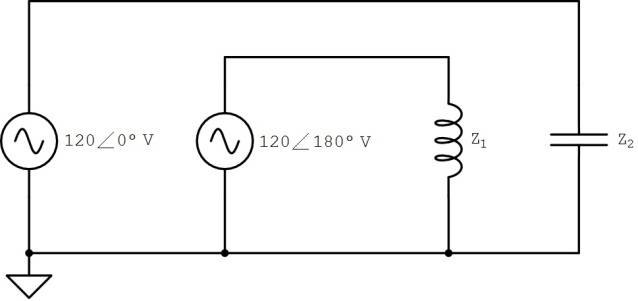

Time for some "reducto ad absurdum"..
So you still need a formula?
Assume Kirchoff's current law holds:
AMPSfuse1+AMPSneutral + AMPSfuse2 = 0
Assume that your customer is right, he can get the current through the fuses to add to a total of 120 amps,
what must be the per fuse current?
Now what two numbers , neither of which is bigger than 60, add to 120 ?
2X = 120 has only one solution. So it has to be sixty amps per fuse.
And all 120 amps will have to leave through the neutral to satisfy Kirchoff.
That requires the currents through the two fuses to be in phase, for current is an arithmetically complex number(has both magnitude and direction) therefore requires consideration of the angles. In EE we use phasor notation which is very similar to vector notation used in basic physics . As you know, vectors add directly only when they have same direction. (I'll try to consistently call them vectors hereafter but I'm getting old...)
Now let us define voltage from FUSE 1 to NEUTRAL as V1,n and voltage from FUSE 2 to NEUTRAL as V2,n
V1.n = 120∠0 because that's a logical starting point, we'll use it as zero angle for our phasors(vectors)
and V2,n = 120∠-180
(Vn,2 would be -120∠0)
We know that each fuse must have current with amplitude 60
what about their angles?
Well, the angles must be the same else the current vectors will not add to 120 - they'll add head to tail and have sum equal to third leg of a triangle with each current vector as one side..
Okay so what two impedances would, with 120 volts of opposite phase impressed across them ,, produce currents of sixty amps in phase?
Well amplitude would be 120Volts/60Amps = 2 Ohms
So let's try just straight two ohms with no angle (resistive)
IF IFuse1 = (120∠0) /2 = 60∠0
and IFuse2 = (120∠-180) /2= 60∠-180
THEN
IFuse1 + IFuse2 = 60∠0 + 60∠-180 = 0 (try it on paper !)
Oh really? the two resistive currents add to zero?
Hmmmmm... (scratch head icon) that won't work - Their real components cancel one another.
(SO THAT's what everybody means when they say the neutral just carries the unbalance ! )
SO----
Our two impedances need to shift our two currents such that they have no real component, for the real components cancel out making the sum less than 120 amps.
Hmmmmm... Maybe,,, Shifting one current behind its driving voltage by 90 degrees and shifting the other ahead by 90 degrees would remove the real components, and if we pick the directions right will bring the two currents into phase so they'll add.
Let's try retarding fuse 1's current by making its load two ohms of pure inductance
and advancing fuse 2's current by making its load two ohms of pure capacitance
and we'll name those impedances Z1 and Z2 (okay names?)
Z1 = 2∠+90
Z2 = 2∠-90
Now
IFuse1 = V1,n / Z1
IFuse1 = (120∠0) / (2∠+90) = 60∠-90
IFuse2 = V2,n / Z2
IFuse2 = (120∠-180) / (2∠-90) = 60∠-90
IFuse1 + IFuse2 = 60∠-90 + 60∠-90 = 120∠-90
Aha ! Now neutral current is 120 amps purely inductive.
How cool is that ! And how useful ! Purely reactive current, be it inductive or capacitive, transfers no power so is abjectly useless to a homeowner.
That is why it is called "Imaginary" current, as opposed to "real" current which does transfer kilowatts
and "real" current was shown above to have phase angle of 0 or 180, and maximum sum of 60.
By algebra above only imaginary currents can sum to more than 60.
so bluntly tell your client he needs a reality check.

Okay, now I know where I went wrong. I was thinking current would flow through the neutral line, back to the transformer, and then split and into each leg of the transformer. But that's nonsense, right?
It's neither nonsense nor a hard absolute invariant fact.
Go back to the original picture you posted in #2.
The hard invariant fact is that any current leaving that transformer winding must get back to it by hook or crook. That's Kirchoff.
Let's freeze frame our thinking again, this time at 90 degrees into that one cycle of sinewave shown, which is the first peak.
Hot #2 is positive and hot #1 is negative.
That's what a center-tapped winding does , relative to its centertap it tries to push current out one end and pull it in the other.
I'll use conventional current here, ie unlike electrons it's pushed from positive toward negative.
If you prefer [STRIKE]electron[/STRIKE] negative current flow the analysis is similar. But Sophie will give us "that look"...
(Perhaps the following would have been more intuitive had the picture shown a 120 volt load connected on hot#1 side of panel - draw one in if you like, but I can imagine it..)
Let's observe some current that has got "pushed" out hot #2 and through a load on that side of panel into the neutral tie busbar. It's that big white metal strip where all the neutral wires are landed.
Upon arrival at the neutral it sees two paths back to the transformer:
1. It can return via neutral
2. It can return through one of the loads connected to hot #1.
Which path will that current choose? Or will it split? How will it ever make up its mind??
Well, let's let Kirchoff analyze that too.
Any current that gets pulled into hot#1 through a 120 volt load on hot#1's side of the panel must enter that load via its neutral connection.
Aha !
So in our freeze-frame mental picture we have current being pushed into neutral through loads on hot #2 side,
and being pulled right back out through loads on hot #1 side.
That current from neutral into hot #1 had no choice - its fate was determined by the loads connected to the panel.
So - current arriving at neutral can and will return to transformer via a load to opposite side of transformer, but if there's not enough loads connected there it can always take the neutral .
Kirchoff says sum of all currents entering and leaving neutral is zero
so whatever current is left over after the loads are satisfied returns to the transformer via neutral,
and upon reaching its centertap they DO split exactly as you suggested.
Draw a circle around neutral - it's just another node.
Draw a circle around either half of the transformer winding - it's just another node.
Any help? I sure had fun...

Jim Hardy, something doesn't look right with your example of capacitive and inductive loads. Can't put my finger on your math though. My crude sketches show current canceling in the neutral with XC and XL loads. If I am correct, that means a service feeding lots of 120 V inductive loads will have a lot more current on the neutral than what it was designed for. And of course there is a much greater chance of this than there is with large capacitive loads on one leg. Also, the XC and XL load as you described form a series resonant circuit. Any more thoughts on this? I feel silly questioning a guy with your background.
  • #34
Please do question me, I tend to reverse things often. Mild case of autism...
I never even thought about their being resonant. That might be a clue...
will have to chew on that a bit.
Were it not for the neutral connection we'd surely have a series resonant circuit with its substantial voltage gain. Probably the neutral connection prevents that.
Regarding phase, which was your question -
remember that wrt neutral the two driving voltages are 180deg out of phase, and that's a half turn apart... so currents a quarter turn behind one and a quarter turn ahead of the other could be in phase.
If I've invented some untrue math to justify that I haven't yet caught my mistake. I'll not be embarrassed or offended if you find it though, I'm here to learn things.. especially about myself.
The brain can accept things that are quite untrue and then invent justifications for them. Eternal vigilance...
If you find an error please post !
old jim
  • #35
I'm not Jim, but I hope you won't mind my comments.
If you have equal impedances on both legs, the currents in both will be 180° out of phase (since the voltages from the center-tapped transformer are 180° out of phase), so you won't have any neutral current.
If you, for some odd reason, wanted to maximize the neutral current, you could advance the current in one leg by 90° and retard it by 90° in the other so the current phasors "line up" instead of being in opposite directions, which is what Jim did by specifying the load impedances as:
jim hardy said:
Z1 = 2∠+90
Z2 = 2∠-90
As long as you keep the loads on both legs balanced, be they inductive or capacitive, there can't exist any neutral current.
In practice, in a typical residential home, any unbalance is probably not going to be of any real consequence. Jim's example was pathological in nature, i.e. extremes in terms of current amplitude and load unbalance.
The two loads are on separate legs, they can't resonante. They share a common return, but they can't exchange energy.
