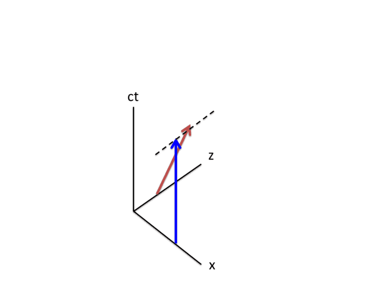

Here for your consideration is a try at synchronizing clocks on a rim rotating at a constant angular velocity. It is restricted to two clocks, each at the opposite end of a diameter of the rim.
It is based on simultaneity as determined in SR. Taylor and Wheeler in Spacetime Physics, page 120, referring to two inertial frames (rocket and lab), state regarding simultaneity:
At any instant there is just one plane in which both the laboratory and the rocket clocks agree . . . [T]his plane lies perpendicular to the direction of relative motion.​
If at that instant one sets the two clocks to the same time, they will agree that the setting is simultaneous, and the clocks will be for that instant synchronized. The first diagram attached shows the world lines of two objects in inertial motion and the instant that they agree on simultaneity (at the dashed line).
Clocks at opposite ends of a diameter have instantaneous velocity tangent to the rim, so they have instantaneous velocity in opposite directions, perpendicular to the diameter. See a diagram from wikipedia at http://en.wikipedia.org/wiki/File:Uniform_circular_motion.svg or previously posted here at post 3, https://www.physicsforums.com/showthread.php?t=730574#post4616303.
Therefore, at any instant the two clocks agree on simultaneity of events that occur along the line perpendicular to their relative motion. That is, they agree on the simultaneity of events that occur along the diameter. Therefore one can synchronize them using synchronized clocks that are at rest underneath them (say in the lab frame in which the rim is rotating). As the rotating clocks pass over the synchronized lab clocks, the rotating clocks are set to the time shown on the lab clocks.
Subsequently, the rim clocks travel at all times with velocity perpendicular to the diameter. So they continue to agree on simultaneity. So they remain synchronized.
For a more detailed discussion of the relationship between simultaneity and synchronization, see: https://www.physicsforums.com/showthread.php?t=731437

Let me make two clarifying remarks:
(1) The proposed method of synchronization in the thread you linked is in general invalid. If we have an observer in arbitrary motion then the observer can determine, at an instant of his proper time, his simultaneity surface by using light signals and the Einstein simultaneity convention. In general this will only agree with the orthogonal complement of the observer's 4-velocity on the order of the observer's proper acceleration (in other words on the order of the path curvature of the observer's world line) and the torsion of the world line. So only locally will the simultaneity surface agree with the orthogonal complement of the observer's 4-velocity; globally they can easily differ. In SR there are only two special cases wherein the two will agree globally: that of inertial observers and that of Rindler observers. In order to see what the simultaneity surfaces look like for uniformly rotating observers (or clocks) see section 3.3 of the following paper, and page 31 in particular: http://www.vallis.org/publications/tesidott.pdf
(2) The term "synchronization" is being used in an overly liberal fashion. The act of synchronizing clocks requires first a synchronization procedure to be defined. The synchronization procedure has to satisfy some basic properties in order to be consistent. Apart from the requirement that two initially synchronized clocks have to remain synchronized, the synchronization procedure has to also be transitive; it isn't enough to simply consider two very special comoving clocks from an entire family of comoving clocks. If we have a rotating ring and clocks placed along the ring, the synchronization has to be transitive across the entire family of clocks along the rotating ring; clearly an attempt at employing Einstein synchronization by means of light signals, or an attempt at employing slow clock transport, to the family of clocks along the rotating ring will fail to establish transitivity.
To JVNY
Yes, your method works for two clocks diametrically opposite each other. It won't work for more than two rim clocks, assuming your definition of simultaneity coincides with that of a comoving inertial observer. (For non-inertial observers, other definitions are possible.)
To be more specific, with many clocks around the rim, your method would synchronise each clock to its diametrically opposite clock, but would fail to synchronise each clock to its neighbour along the rim. (For "comoving inertial synchronisation".)

If I understood correctly, the proposed method simply says the following:
Take clock A and clock B on the rim of the disk such that A and B are diametrically opposed. Consider an event p in the vicinity of clock A and an observer O momentarily comoving with clock A at p. Then the plane perpendicular to the direction of motion of clock B relative to O at this instant is the plane cutting across the disk diameter joining A and B at this instant. All that we care about now is the fact that relative to O, clock A and clock B will unequivocally read the same time at this instant because this plane intersects the world lines of both clock A and clock B (c.f. exercise L-15 in Taylor and Wheeler, quoted by the OP in post #1). Therefore clock B is synchronized with clock A relative to O at p. This will clearly hold for all later events in the vicinity of clock A relative to the respective inertial observers momentarily comoving with clock A, so clock B is trivially synchronized with clock A for all events in the vicinity of clock A. Here I believe we are implicitly making use of the fact that clock A and clock B tick at the same rate relative to the central clock (if they ticked at different rates then simultaneity obviously does not in and of itself guarantee synchrony).
EDIT: I agree, at face value, that this method works. I have yet to check if there are any subtleties that "defeat" said method.
The suggestion is restricted to clocks on opposite ends of a diameter. It might be that those can be set to the same time and stay synchronized with each other, yet not with other clocks on the rim. For example, consider a row of clocks oriented north/south and traveling east in a lab frame, and a second row of clocks oriented east/west and traveling north in the lab frame. You can synchronize each row of clocks using simultaneous signals from the lab (because each row is aligned perpendicular to its direction of motion in the lab frame). The clocks in each row will be synchronized in their own frame and in the lab frame. But neither row will present synchronized to the other. One end of each might even coincide in space (the two rows presenting momentarily as an "L" in the lab frame). But the fact that the two ends share the same point and momentarily agree on simultaneity does not transitively cause all of the other other clocks on the two rows to agree on simultaneity.
Also, I do not mean for the opposite clocks to travel at different speeds. They will both have the same speed and the same time dilation relative to the lab frame. However, I do mean to suggest that the clocks will agree on simultaneity when they are set by the lab signals and also thereafter. To anthropomorphize the clocks, two human observers riding the disk would agree that their wristwatches remain synchronized.
The basic suggestion from the original post is that the same rationale that permits setting the clocks to the same time at inception (that they momentarily agree on simultaneity because they have instantaneous velocity in opposite directions, per the Taylor and Wheeler quotation) keeps them synchronized into the future. They never cease to have instantaneous velocity in opposite directions transverse to the diameter, so they never cease to agree on simultaneity, so they never cease to be synchronized.

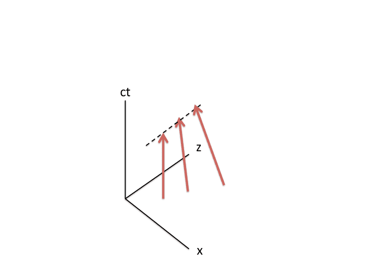

Think of a row of observers sitting on a radius, and then think of a row of Rindler observers. The radius observer at the rim end of the radius is equivalent to the Rindler observer at the rear end of the Rindler row. Their clocks run the slowest relative to their rows. The farther forward you move on the Rindler row, and the farther inward on the radius toward the hub that you move, the faster the clocks run. The Rindler observers agree that they are at rest with respect to each other on a line of simultaneity (that is, they agree that they are not moving with respect to each other, and they agree on the simultaneity of events that occur along their line of motion relative to an inertial frame).
Might not the radius observers also agree that they are at rest with respect to each other on a line of simultaneity? They have, at all times and in every moment, instantaneous velocity in the same direction. That line is not limited to the radius, though. As described in the original post, the simultaneity also applies to objects in motion in opposite directions perpendicular to the line, so the line of simultaneity extends the whole diameter.
Next, consider the two ends of the diameter. They have the same distance from the hub, so they should have the same time dilation in the lab frame. As described above, per problem L-15 from Spacetime Physics they agree on simultaneity momentarily. By the same rationale as that problem, they should agree on simultaneity at all other times, so shouldn't their clocks be able to be set to the same time, then stay synchronized?
At face value I don't think that's an issue as long as you make sure to adjust the clock rates (relative to the central clock) of the clocks closer to the central clock so that they all match the clock rate of the clocks on the rim (meaning we're dealing with non-ideal clocks again if you want synchronization, just like in the thread with the clocks comoving with the accelerating rod).
What's unconvincing to me however is the use of simultaneity to argue synchrony. For example, say we have clocks A and B diametrically opposed on the rim. At some event p in the vicinity of clock A we consider an inertial observer O momentarily comoving with clock A. The observer knows there exists an event q in the vicinity of clock B that is simultaneous with p because the plane perpendicular to the line of relative motion of B intersects the world line of B as well as the world line of A at p. Now it's clear from a diagram of the world lines of clocks A and B that this plane varies smoothly along said world lines so that's not a problem. However you then say that because q is simultaneous with p according to O, clock B can be synchronized to clock A at this instant if it already isn't. Furthermore since this simultaneity of events between clocks A and B exists everywhere along the world line of clock A, relative to observers momentarily comoving with clock A, you then say that clocks A and B are forever synchronized. Do you see why I'm bothered by this line of reasoning? If, as you argue, simultaneity ##\Rightarrow ## synchrony then why would we even have had to synchronize clocks A and B when using the momentarily comoving inertial observer O at event p that very first time? Why wouldn't simultaneity have immediately implied synchrony then? Why the need to synchronize those clocks that very first time "if they happened to not be synchronized at the simultaneous events p and q in the vicinities of clocks A and B respectively"?
Also I'm having a hard time seeing the relevance of the lab clocks that you're using (the clocks at rest in the global inertial frame centered on the axle that the disk is spinning about). Why are we using lab clocks to synchronize? The simultaneity (and hence as per your argument synchrony) is determined relative to inertial observers/inertial clocks momentarily comoving with clock A is it not?

Now I am getting confused. Perhaps it is best to start from the beginning and simplify. Let's start with the Minkowski diagram attached to the original post. There are two objects, Red and Blue, in inertial motion toward each other in their own frames and in a third inertial frame (the illustrated frame, call it the lab frame). They are in motion along the x axis. At one moment they have the same x-axis coordinate, so they are on the dashed line illustrated in the diagram that connects the two. The dashed line is perpendicular to their motion.
At that same moment, two firecrackers explode simultaneously in the lab frame, one directly under Red, one directly under Blue. Therefore, these two explosion events have the same x-axis coordinate as Red and Blue; the explosion events are also on the dashed line that connects Red and Blue.
The initial questions are: first, are the two explosions simultaneous for Red? Second, are the two explosions simultaneous for Blue? I think that they are simultaneous for both, and the rest of the analysis is irrelevant otherwise.
JVNY said:
I think that they are simultaneous for both...
I agree. Like I said I have no issues with anything regarding simultaneity in relation to the subject matter of this thread.
OK, thanks, but let's consider simultaneity carefully also. So next overlay a rotating rim over the two moving objects, with one observer riding on the rim at the zero degree mark and another riding on the rim at the 180 degree mark. In the lab frame,
(1) the hub is half way between Red and Blue,
(2) the zero degree rider is directly over Red when the firecrackers explode, and
(3) the 180 degree rider is directly over Blue when the firecrackers explode.
Are the two explosion events simultaneous for the zero degree rider?
Are the two explosion events simultaneous for the 180 degree rider?
Here we have to consider the simultaneity surfaces of the riders themselves, which you first noted should be illustrated by the diagram on page 31 of the linked Vallisneri paper. I cannot be 100% sure, but it does not appear on this diagram that opposite ends of a diameter are on the same simultaneity surface. So the two explosion events would not be simultaneous for both riders.
