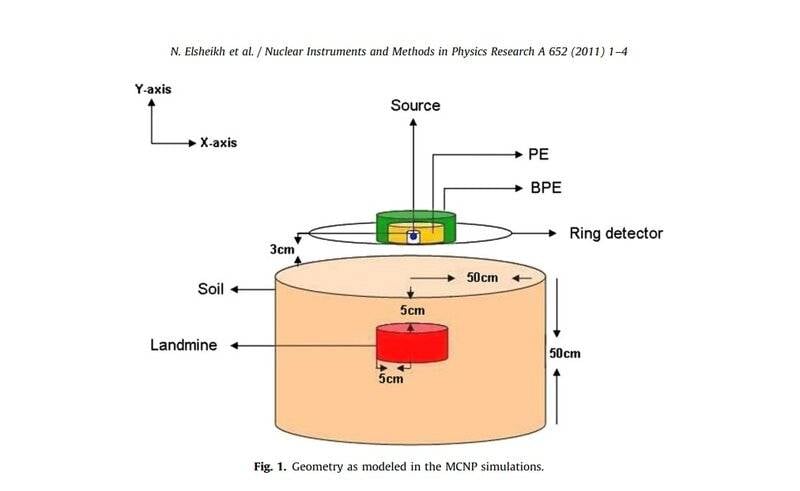

hello! i'm working on a landmine detection using neutron technique and the model involves using a ring detector i did my best to understand its part but i'm getting this error and the tally counts are not correct. I attached the input file if someone could help!

The source is at 0 53 0. Surface 20 is defined as py 53. Never make a point source coincident with a surface. Even surfaces made by a macrobodies and even when they extend beyond the cell they define. Changing to POS=0 52.5 0 solves that error for me. I do not know how ring detectors work, if the tally is still wrong post more information and hopefully someone will know.
Suggest you define the void as "3 0 23", just because it's simpler.
Edit, btw your BPE doesn't surround your PE moderator, how big are the BPE and PE supposed to be?

for the part of BPE it should 5 cm radius with 2.5 cm height while PE is 2.5 cm radius and 5 cm height.
The model goal is to count back scattered neutrons on the ring detector and I'm still struggling how to model this properly.

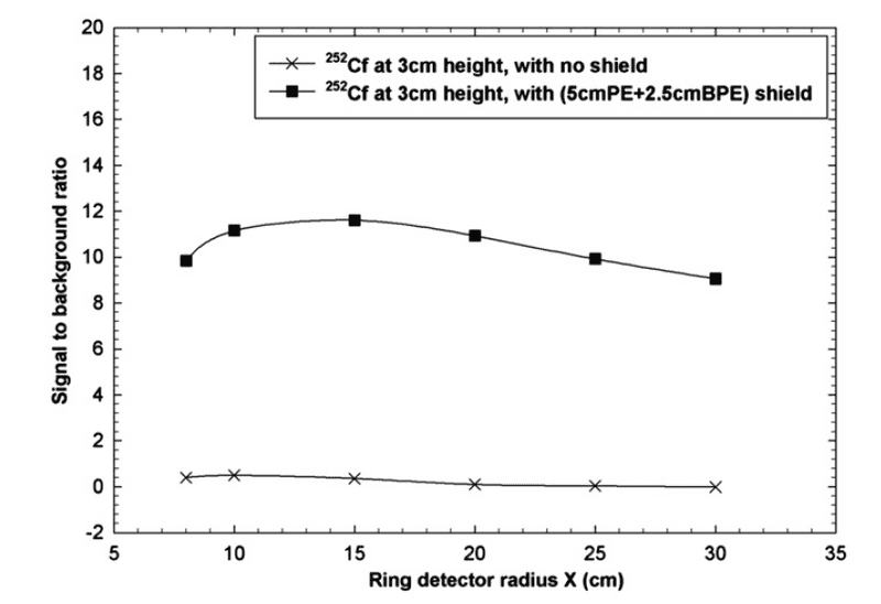

EDIT, I changed the tally to f4 and added a ring detector cell since the output of f5 is not working properly. but unfortunately, it's not giving me a correct output also. I attached an image with the curve i'm trying to plot to validate this model and the new input file.

I want to see the change in the flux with and without the TNT, but in the output flux doesn't change. It gives me 1.5*10^-3 with the TNT and 1.49*10-3 without it. I cannot understand what's the reason for this output it seems like it cannot see the TNT or it is counting the flux coming from the source not the backscattered.
EDIT: (I'm trying to calculate signal to background ratio, and it should be near 8 but with this output it is about 0.1)

The paper says this "The EBS neutrons can be detected by a suitable detector capable of differentiating the EBS neutrons according to their energy and their flux.", which suggests that the detector is perhaps a bit more clever than most real world detectors. It hints that they have determined what counts as a thermal neutron by what gives the best result. Do you have a plot of flux versus energy with and without the mine?

For the part of detector my conclusion was that he used ring detector tally f5 instead of defining it in a separate cell.

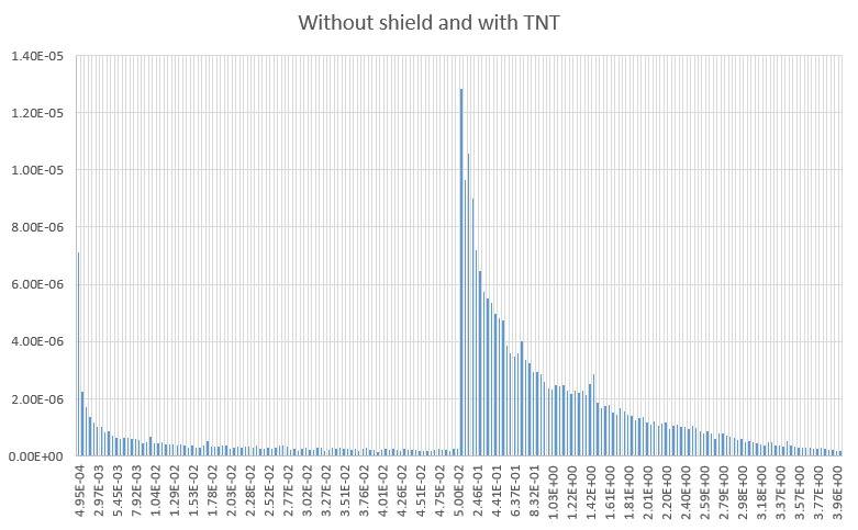

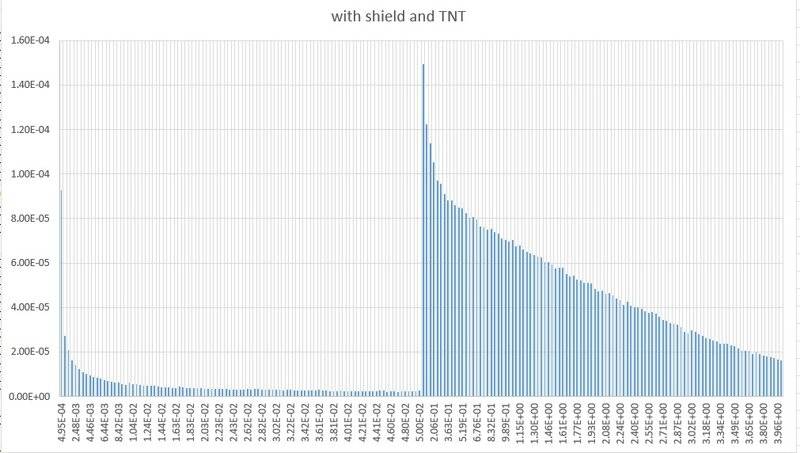

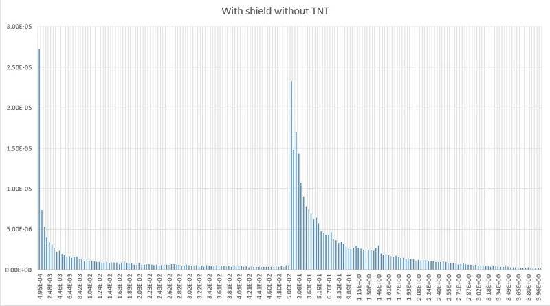

I have added a new tally CF4 to count only the neutrons after they reach cell 1 or 2 (soil and TNT) I don't know other ways to differentiate them in MCNP. I will attach the updated input file with the output files and the plots I got of flux versus energy. If you have any comments or conclusions on them, please let me know.
