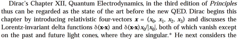

It's elusive because neither of those citations support your claim.
Here's an excerpt from pg. 398 of your first reference:
These are the only mentions of ##\delta## on that page and clearly have nothing to do with your claimed equation in post #8.

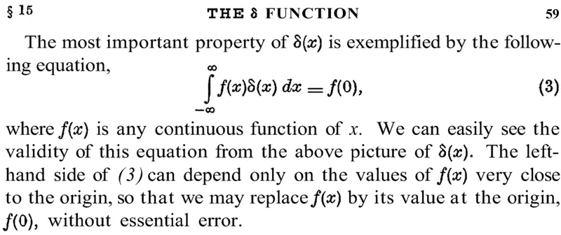

Further, in my copy of Principles of Quantum Mechanics (4th ed. rev.) Dirac writes:
This is the only place in Dirac's ##§15## that displays an equation akin to your ##\delta x=\phi (0)##. Using your notation, eq.(3) becomes$$\intop_{-\infty}^{\infty}\phi\left(x\right)\delta\left(x\right)dx=\phi\left(0\right)\tag{3*}$$Clearly the left side of eq.(3*) bears no resemblance to your "##\delta x##".
I assert therefore that the equation you've written in post #8 is simply wrong. That's why I've repeatedly asked you to either explain your notation or else cite references that use that notation. You've managed to do neither, which is a disservice to current and future readers of this thread who expect to find accurate content on Physics Forums.
