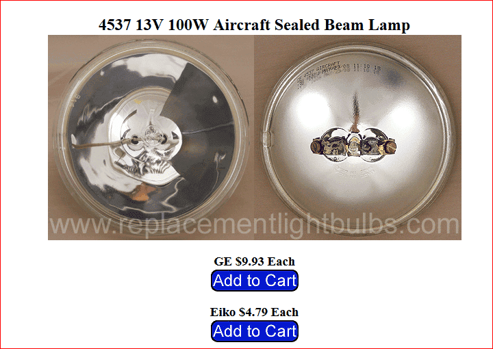

If you want to get creative,
this lamp mounted in a PAR36 tractor headlight housing would do the job
and by connecting one side to ground it'd make a spectacular work light for nighttime
and use a metal housing for it could get pretty warm.
PAR36 is bulb shorthand ... PAR for parabolic shape, diameter is given in eighths of an inch, so that #4537 PAR36 lamp is 36/8 = 4.5 inches diameter, common size on farm and construction equipment.
