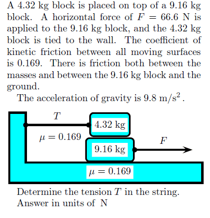

A 4.32 kg block is placed on top of a 9.16 kg
block. A horizontal force of F = 66.6 N is
applied to the 9.16 kg block, and the 4.32 kg
block is tied to the wall. The coefficient of
kinetic friction between all moving surfaces
is 0.169. There is friction both between the
masses and between the 9.16 kg block and the
ground.
The acceleration of gravity is 9.8 m/s^2.
Determine Tension of string in N
(see image)

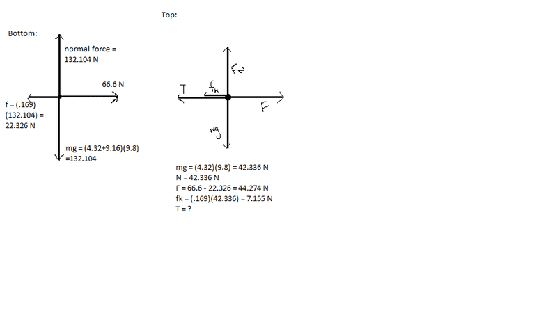

ƩF = ma
fs = μk*FN
(see attachment for free body diagrams)
ƩF = ma
m = 4.32 kg
atop block = 0
ƩF = Fapplied - fk - T
0 = (44.274) - (7.155) - T
T = 44.274 - 7.155
T = 37.119
Apparently I did something wrong somewhere, but I'm not sure where.

What forces act on the upper block? (I don't understand your FBDs.)
Well maybe it isn't supposed to be there, but I was thinking that since the bottom block has a force in that direction that is not completely canceled out by friction, it would cause the top block to have a force as well, which is equal to Fapplied (to the bottom block) - fk
That applied force acts on the bottom block, not on the top block. So it doesn't belong in your analysis of the top block. The only influence that the bottom block exerts on the top block is through the normal force and friction.
Oh! so T = f
and so it's T = 7.155
Thanks!
TFOrange said:
Oh! so T = f
Yep!
