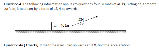

A mass of 40 kg, sitting on a smooth surface, is acted on by a force of 18 N eastward inclined upward at 30 degrees. Find the acceleration.
F=ma
My solution was to find the horizontal component of the net force and divide that by the mass. Am I right?
Your solution is correct.
Thank you for your reply. I also got a value of 0.4 m s^-2, is that also correct?
Yes, it is.
