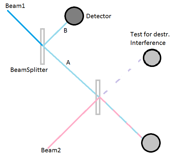

Consider a simple setup with two independent but coherent light beams of identical intensity that converge on a 50:50 half mirror. One beam has a phase shift to the other such that they interferer and only one beam leaves the mirror in direction C while destructive interference causes no light to leave in direction D.
This setup is simply meant to compare two beams for coherence and ensure that their intensities are equal, since otherwise a detector positioned at D will measure something. In the following however I will assume perfect coherence, so only the sensitivity to intensity deviations remains a factor.
Now what happens when the both beam intensities are tuned down until there are only individual photons? Does the behavior at some point fundamentally change from the classical case – apart from the obvious that detectors will only measure individual photons instead of a continuous beam? [EDIT: of course the two incoming photons need to be assumed to be perfectly synced and arrive at the same time at the mirror] This is a case of two photon interference but unlike the setup of the HOM-effect there is phase shift in the incoming beams. If my quick mental calculation applying a displacement operator before the mirror matrix to the initial state is correct, there should still be no photons detected at D while C should measure both each time.
Now the thing I am interested in, is whether this setup still remains sensitive to the exact intensities, for example what happens if the initial beams are reduced even further e.g. by using additional beam splitters with adjustable splitting ratios ahead of the interference mirror? Would it be still possible from the detection frequencies at C and D to calculate the intensity ratios? Given that the calculus is completely linear I would assume that an interference of two half-photons should behave just the same as in the full case.
The phase shift just switches which output beam is the "constructive interference" beam and which is the "destructive interference" beam. It doesn't change the fact that, assuming coincidence in time of the two incoming photons, only the "constructive interference" beam will show an output photon detection. So I think your quick calculation answer is correct.
Note that the "coincidence in time" requirement is critical, though, just as it is for the ordinary HOM effect. Normally, two independent sources of photons, even if they are assumed to have identical frequency, phase, and intensity, will not emit photons at the same time when their intensity is turned down enough. So at low enough intensity, most of the time a photon will come into the beam splitter from just one arm, not both at the same time, and you will get a 50-50 chance of detection in each output beam. Only in the rare case that both sources emit a photon at the same time (or close enough in time, given the frequency) will photons come into the beam splitter from both arms at once and allow interference to take place.

Just to make sure some common misunderstandings are avoided: If one reduces the intensity of a coherent beam to the point that there is on average only one photon per time range of interest changes absolutely nothing with respect to the expected results. Everything is still perfectly classical. Most importantly, it is fundamentally impossible to realize your scenario "the two incoming photons need to be assumed to be perfectly synced and arrive at the same time at the mirror". This is something that cannot be achieved by starting from a coherent beam. The waiting time distribution between two photon emission events is given by the waiting time distribution for emission events that are Poisson distributed and therefore cannot be synced in principle.
If one wants to do that syncing, one needs to use light sources that are intrinsically non-classical (single atoms, single ions, single quantum dots, heralded SPDC, ...). The difference is that for coherent beams you get one photon on average per time range of interest (buut there is no upper limit on the photon number present), while for non-classical light sources you get one photon at most. This is a huge difference. Most importantly, the latter choice of light source will give show the HOM effect, while a coherent beam tuned down in intensity will never do that and just show the same interference pattern you would also see at higher intensities.

No, it absolutely does not and this is a very common misunderstanding. Photons are not point particles, but all photons within one coherence volume are completely indistinguishable. Assuming infinite coherence length or time therefore is fully equivalent to assuming that both beams are derived from the same laser. There is absolutely no difference. Also note that this is not about "practical implementation". This is fundamental quantum optics. For the same reason, you can do boson sampling only with Fock states and not with weak coherent states. As long as you use coherent beams, there is no two-photon-interference at all and all that is taking place is single photon interference. Otherwise you could do all the boson sampling stuff simply with lasers.

That is not correct. In order to have the beams miss each other, the delay introduced by the fiber loop needs to be longer than the longitudinal coherence length of the light field. The "desync" you mean occurs due to the delay being longer than the coherence length which results in the relative phase of the two light fields becoming random with respect to each other.
For using two different beams, you now have three options: you can perfectly synchronize their phase. Then they will also always show interference if you interfere them, so you essentially get physics equivalent to a single beam with infinite coherence time. You can leave them completely unsynchronized. Then you will not see any interference for experiments with integration times longer than the coherence time of the individual beams. However, if you repeat the experiment several times with integration times shorter than the mutual coherence time, you will see different interference patterns for each single integration. Averaging over all these measurements will then yield no interference at all. In all realistic cases, you will be able to maintain the phase synchronization for some finite duration. Then you will get absolutely the same scenario as when using the fiber loop and the two beams are fully comparable to a single beam with finite coherence time.
What one can do, is to consider the beamsplitter as a simple device with two input ports and two output ports and apply the beamsplitter transform to the input ports to see what comes out. When doing so, you will find that it makes a huge difference whether you take Fock states as the input (which do not have any well defined phase) or whether you use weak coherent states, which have some photon number uncertainty and which require to take the off-diagonal terms into account. The essential physics of the beamsplitter in quantum optics is well described in the "bible" ("optical coherence and quantum optics" by Mandel and Wolf).

Assuming that the relative phase of the two beams is stable and there is no additional noise: yes. The interference pattern depends only on the fields and not on the intensity at all

No, the beams will not lose coherence. They do not lose anything. Absolutely nothing changes but the intensity of the signal. The interference pattern is completely unchanged. Only the photon count rates will go down. The relative photon distribution at the output is unchanged, irrespective of whether you put a million photons per second there or one per year.
The whole notion of "sending out a photon" is potentially complicated because things do not work that way. The light field has some coherence time and that is the typical time scale during which there is a superposition of the photon being emitted or the photon still being in the source. Consider a simple laser with a gain medium and two mirrors, where the light goes back and forth. When using an unbalanced interferometer with different arm lengths, you will still see interference if the path difference is shorter than the coherence time of the light. In practice this means that you cannot distinguish whether the photon left the laser cavity earlier and took the long path or whether the photon made several more round trips, left the cavity later and took the shorter path. Things work in a similar manner for emission from individual atoms. The uncertainty of the exact moment of emission is given by the coherence time of the light field. At the low light levels you are interested in, you calculate probability amplitudes for the photon detection events. For the experiment you are interested in, these behave like the classical fields.

No, this does not change anything. Interference pattern between different beams only take place anyway, if they are phase-stabilized with respect to each other. Otherwise there is no interference at all. The interference pattern then is a standard single photon interference pattern caused by the interference of fields, which is completely independent of the mean photon number - however large or small that may be. For coherent beams, it is completely irrelevant whether the photons are present in the same interval or not. That is different for thermal or non-classical light fields, but for coherent fields there is no difference.

Now let's start with a classical beam that is evenly splitt into n beams with each having an intensity about below a photon per specified time interval. let each single one of them run into an empty MZI setup. Assuming perfect conditions each beam fraction should pass its MZI without any loss, in particular no merger should measure anything at its destructive D leg.
Now take a single photon source producing a photon every now and then with identical frequency to our beam. analogously let that photon run through a cascade of splitters to fraction it into n-beams and than feed them each to a MZI like this ##><> \rightarrow ##. Even if the photon is out of phase with the main beam it will have the same displacement for each MZI. Besides any disturbance will do to make the destructive interference imperfect and since the amplitudes can be tuned to have similar magnitudes this should be detectable somehow - which the merger D-detectors are there to notice. And having n-MZIs yields a n-measurements to probe a single photon per time frame.
From such data you could derive information about a single probed photon, possibly stuff that cannot be linearly extracted (i.e. using a linear operator = observable) - and also with some time resolution. One quantity in particular, the probability amplitude of each of the probed photons n fraction beams, should be not measurable in any way. So such a setup shouldn't work like that simply.

Do you mean that these beams enter a MZI and the other input port is empty? In this case: yes, assuming that one ideal stability is given and there is no stray light and there are no further perturbations, such a scenario is possible.

And even though it makes a lot of sense that the multi-photon interference disruption at the half-mirror itself causes the destruction of the superposition and not the later measurement at an actual detector I do have to wonder if there are experiments confirming this behavior. From a data analyst perspective I've learned never to trust any model predictions in a region where it had no training data to learn from.
Wait, I am not sure whether we mean the same thing here. It is always some kind of measurement (or rather: irreversible interaction) which causes the destruction of superposition. Of course under some circumstances also the non-detection of a photon (or rather: ensuring via measurement that only the vacuum state is present) may provide such a measurement. If that is what you mean, we talk about the same thing. However, there is nothing special happening at the beam splitter itself.
Killtech said:
...and that supposed collapse at the interference was also a my initial reason to assume that when two coherent beams which are in phase meet at a beam splitter will they will stop showing an interference once they are reduced to a extremely low intensities (i.e. individual photon level). I mean it's a guesswork to what basis interference might collapse/project a superposition to but assuming a somewhat localized state would make it possible for photons to miss each other - that was my thought.
When considering two-photon interference, it is not critical, whether the photons hit or miss each other. As long as you have two indistinguishable paths to get from the same initial state to the same final state via different indistinguishable ways, the probability amplitudes for these processes will interfere, even if the photons are not at the same place at the same time. This has been tested explicitly in the following paper: Can Two-Photon Interference be Considered the Interference of Two Photons?
Killtech said:
So maybe there is a chance it's not the interference but rather indeed the detectors that are responsible for the collapse (well, as in the first collapse that impacts the superpositions). In this case however a series of MZIs configuration like described in my earlier post would allow the probed photon to pass multiple MZIs before it's chance of hitting a detector becomes significant enough. That way it's disturbance of the original beam interferences would be allowed to grow at each iteration/MZI. Counting the iteration at which a disturbance is first detected plus the degree of disturbance in all following MZIs would thus allow for a rather accurate measurement of the amplitude of the photons probability amplitude term in its superposition - especially as this setup is in theory scaleable thus allowing to minimize the error to arbitrary level.
I must admit that I cannot really follow. Mixing the single photon and the coherent state renders the state a single photon-added coherent state, which is routinely used for testing the quantum-to-classical transition (by varying the coherent amplitude). To be honest, I do not see what you mean by "probability amplitude term in its superposition".
Oh sorry. I have too much of my special setup in mind and probably don't write enough for others to be able to follow. Okay back to the MZIs which we let the coherent beam run through. The idea is to never disturb this setup with the full photon state we are probing but rather run in through separate beam splitters first and feed only a tiny fraction of the photon into each MZI for disturbance. So the photon is in a rather complex superposition of being splitt into many fractions i.e. ##\frac {1} {\sqrt{n+r}} \Sigma_i (|p_i> + r|rest>)## where each ##|p_i>## could be fed to a different MZI. That's the not so typical part I guess. And that's the superposition which will likely be very delicate and easy to destroy.

Okay, let's make the longer argument and start with the classical Maxwell equations in vacuum. Now looking at two electro magnetic wave solutions one notices that they can go right through each other without having any effect like they would not notice themselves. This is a simple consequence of the linearity of these equations. So one can be motivated to say they do not interact with each other at all. Now as for photons, second quantization perfectly preserves that behavior of Maxwell in QFT and only adding the other particle fields we get some higher order terms that allow photons to slightly impact each others paths.
But this no interaction is very misleading. Going back to Maxwell the EM-Fields have a Laplacian sitting in their time evolution. So just like a membrane the field tries to flatten any bumps in it. As such it has a very strong self interaction otherwise there would not be any wave solutions at all!
BobJones2 said:
Interference occurs due to the dual wave-particle nature of everything (photons, electrons, etc.; really no difference there) where wave function of a *single* particle (again, doesn't matter if it's photon or electron or muon or whatever) "interacts" with itself (it's a poor choice of werb, but there's really no appropriate werb in "classical" physics that describes the phenomenon), and has nothing to do with multi-particle interference.
Every interference experiment you have read about in any physics textbook is always interference of a single photon with itself, and the "classical" results you hear about are just histograms of a large number of single particle interferences.
There are enough experiments using interference of multiple photons, mind you some interesting ones quoted here by Cthugha. Besides, take the very trivial one I brought up: take two laser beams with matching phase and let them interfere at a half mirror. Sure this is a classical experiment but if distinct photons could not interfere there would be no way to explaining the classical behavior at all. But as Cthugha notes the photon become so indistinguishable that you cannot tell whether they came from the same beam or not within the calculus.
As for having no Feynmen graphs showing a photon-photon interaction, well this is kind of obvious. same as a electron-position interaction requires emission of photons for the two particles to meet (match in position and impulse) for the annihilation to work you need to do the same with photons. The only way a photon annihilates with another photon with a phase shift of ##\pi## (which makes it the anti-photon in a sense) is when they move in exactly the same direction. So they would require emission of some other particles (like the electron emits a photon) to change their trajectory to meet. Yeah, I hope you see the problem here. However there is a simpler way to achieve it: a half mirror can actually do the trick of changing a particles trajectory. That way photons and anti-photons can meet an the result is interference. So if you add the half-mirror interaction to your Feynman diagrams you should be able to depict these photon-photon interactions as well: by the emission of a "half-mirror-particle" (the mirror takes some energy and impulse to meet conservation rules; well given it's infinite mass only impulse) by each photon you can now depict photon-##\pi##-shifted-photon annihilation similar to ##e^+e^- \rightarrow \gamma\gamma##.
Well, sorry for my not so physical terminology but I hope the idea is clear and I am sure the experts here will be able explain it to you much better then I can.

... You mean like the very thing that Cthugha and I discussed is this thread here?? In this context, as for experiments with multiple photon interaction, how about the homodyne detection of state experiments he mentioned in this regard? If I understand your understanding correctly these those shouldn't see anything but they do. They do not make any sense at all if there is no influence between different photons.
Also when you do any calculations in the Fock space involving a beam splitter (like the one used to calculate the HOM effect), you clearly see a lot of influence right in the calculus. I mean in the calculus there is nothing to distinguish the different photons and thus a photon interacts with itself identically to another photon - well apart from that due to the higher particle number you have more possible states to deal with.
