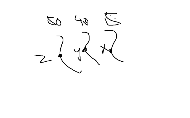

If the work done by a charge from z to y is W. Would the work be different if it was from z to x then to y.
W=vQ
I said it would be the same because delta v would be the same in the end

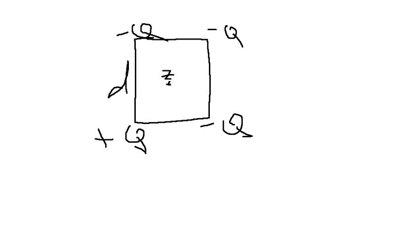

What is the electric field at the point z and what is the direction
E=kq/r^2
I assume the positive and negative would cancel each other out. The distance between the charge and the center is d rad(2)/2 so the charge for one of them would be KQ/(2d^2/4)= 2KQ/d^2 then you just multiply that by 2 because there is two charges, but i don't know the direction

The fact that you don't know the direction in the last problem is an indication that you did something wrong. Can you justify
My teacher showed us a problem where the opposite corners were opposite charges and he said the electric field at the middle is zero.
What happens if you put a test charge in the middle?
